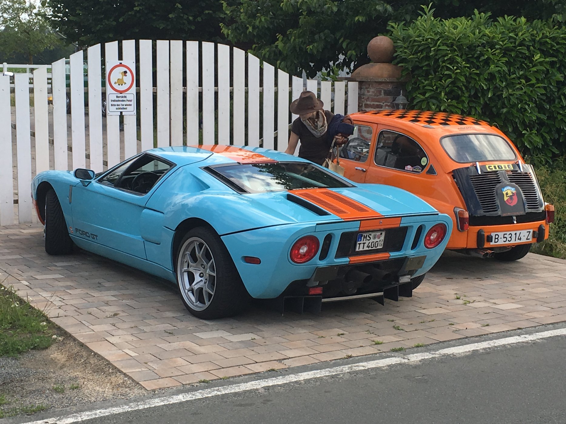

Hi there, beeing in Germany and driving a GT40 recreation with 427 Windsor, dry sump, a ZF transaxle (that I just blew up because thes simply can´t deal with the torque of a well built 7 L engine..... )I knwo that it is a hassle to deal with authorities.
I have a legal historic registration which is hard to get nowadays and requires some work, contact and money to be invested. Even more so if you plan to use it for motorsport with FIA approval.
My 2006 GT is lots of fun to drive and a lot easier to maintain, but obviously not that sort of old school racer like the GT 40.
Harrie is right, to build a car from scratch and try to get it registered without bending the law is impossible.
Due to emissions, the new C8 Corvette even in CA set-up can´t get a german registration.
The last thing I would worrie about is insurance or tax which are minor expenses!
If you want to build it yourself, may I ask what kind of qualification you have and if you want to start with a Superformance or CAV or rather go with these british kits that sometimes have nothing in comon with the real deal besides the looks?
Does anyone use the ZF or Quaife gearbox for a longer period of time with north of 600 HP without problems?
Even with the strenghtening Quaife offers nowadays the are rated to last up to 500 bhp.
In 2018 I have had a long talk with Lee Holman in Laguna Seca during thhe Pebbel Beach Car week and he said that only the Kar Kraft transmission would last behind a Big Block, any experience or suggestions regarding a proper way to make the ZF stronger would be greatly appreciated.
