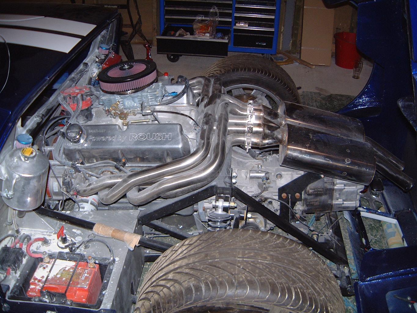

Having just been sound tested at 108,5 db I NEED TO MODIFY MY EXHAUSTS (MUFFLERS).does anyone know of a good system and meter to check the levels. The track insisted that testing was at 4500 rpm so as you guessed I wasnt able to test the car.Already have the bundle of snakes ,Its the boxes that I need to look in to

You might want to talk with the track's Chief of Sound / Tech...
I can tell you from my experience with the SCCA that there are many different factors and inputs to measure than just a DB reading on any meter.
Wind, Temperature, track surface, length of the grass (I am not joking) all play a role.. There are also different weighting settings that need to be used.
Now to your exhaust system.
You might want to consider adding a balance pipe between the two collectors. This way the individual exhaust pulses are split (pressure wise) between both mufflers.

We used a shared chamber 3"in/3" out for our car... vs our old 2x 3"dia 18" long res setup it cut the dB by ~35!
