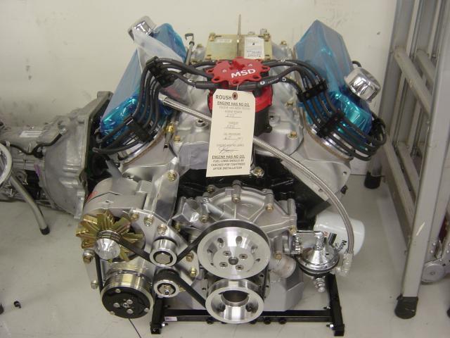

Hi All,

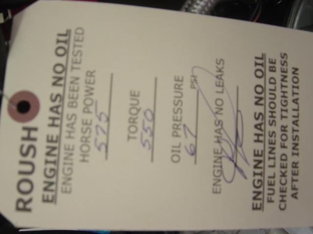

Just wanted to post up some pic's of the engine. It just came in today. It dyno'd at 575 hp and 550 tq. just waiting on sound proofing and heat insulation. will have more as soon as she's running.
Dave

Looks good, Dave. Pay particular attention to pounding out enough clearance in the access panel in front of the alternator. They left it a little close on mine and the fan blades on the pulley would bite into the panel on hard upshifts. I had to take it apart and "massage" it a bit more.

Thanks for the advise. I will pass that on to the installer.
Dave

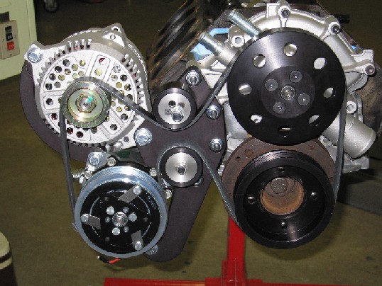

I too had heard about the Roush system hitting the access panel. From what I understand Roush is also reluctant to sell just the serpitine a/c altenator system seperate. Since I built my own engine, I used this instead. Its similar but, uses the supplied a/c compressor, ford atlenator, doesn't hit the access panel and can be used on all three windsor style small block heights. It doesn't attach to the cylinder head. It attaches in the front using the front cover/water pump bolts and in the rear using the ground lug hole in the block. All the billet aluminum pieces on mine, shown here on a 302 mock-up block, have been black hard coated instead of polished. Presently, its installed on a 9.5 deck heighth windsor in my SPF car.
John

John, great looking setup did you make that? If not where did you get it and what did it cost? I really like the black look.

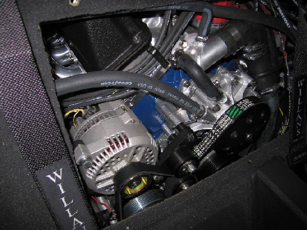

Nice pulley set up John. I bought a Roush 427SR and did the installation myself. Pleased with the Roush, but the pulleys did require mods to clear the firewall. I removed the small nose trim cone from the alternator pulley. Welded a bump out addition on the firewall to accommodate that pulley and had to hammer the water pump pulley area out more too. Recovered the firewall with new ultrasuede fabric and relieved the passenger seatback some.
Dave & Richard - Thanks for the compliments.
Dave - Yes, I did make it myself. I also made some sets that were not plated for Dennis Olthoff, 704-647-9924. I'm not sure if he has any left to sell. Last time I talked to him he had 1 or 2 but, that's been awhile. Also not sure how he's selling his, with respect to whats included. I am currently in the process of making some more sets, should be ready within a couple weeks. The price would be dependent on preferences, i.e. plated or not and what you might want included. Feel free to contact me with any other questions, I've included contact information below.
Hey Daryl,
After speaking to my installer, he said that he puts spacers to accomidate that issue. Thanks for the advise, and please let me know if there is anything else I should know... Thanks again...
Dave
