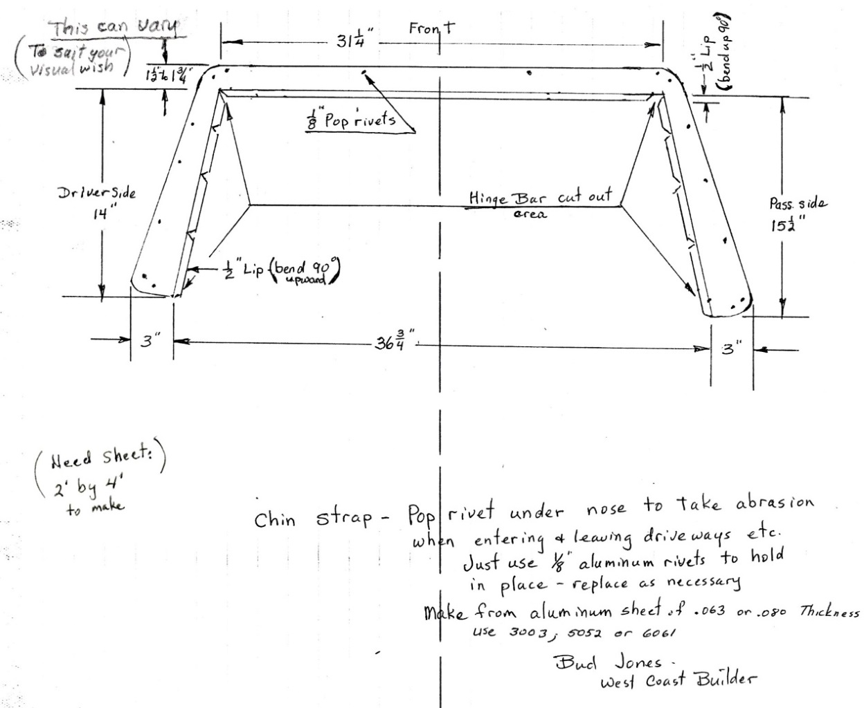

An aluminum Sheet metal piece pop riveted to the underside of the front nostril ( you can't see it when looking at the car) will take care of the road rash that peels away the fiberglass. Just replace it whenever necessary.
