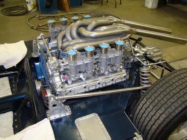

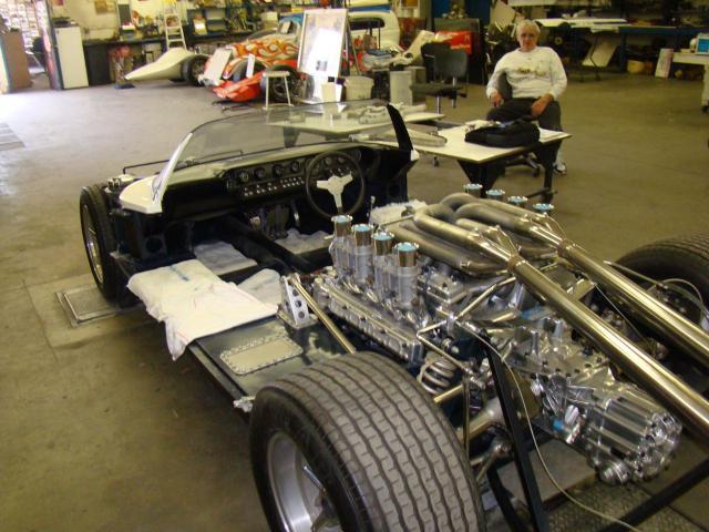

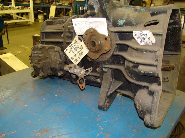

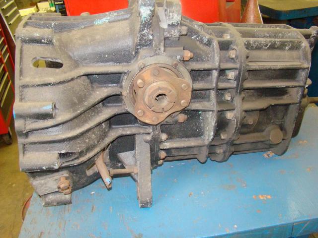

This is Deans original roadster with the body off for some final work. I spent the better part of 2 days at Deans going over plumbing and wiring to get ready to start the engine for the first time since the 60s.

Nice looking chassis, looks like a Ford Indy motor, I hope you will post some video of that startup so we can hear that puppy run.

Holy shiite! I like, a lot. :)
Presumably that car is a "twin" of Bill Wonder's ex car 103 although I notice that the TB arrangement is different on this one being vertical and not angled @ 90 deg to the head plane. Is that an original Ford DOHC install?

Aren't those real Webers? When I saw Bill's car a few years ago (103) it had an electronic FI System, I think it was made by Electromotive, and coil pack ignition, all on a Ford Indy motor. According to him it was earsplittingly loud; he used to drive it down to the barber shop in Harleysville when he went for haircuts.

I don't think any existing GT40 is an "original" 255 DOHC install. Bill Wonders car had one with injection as I recall. Dean's car has Webers fitted with intermediate mainfolds, really clean install.
On a Ford DOHC 255 you can swap the heads around so that the exhuast can either come out of the "V" as on Indy cars or below the cams as on sprint cars that tried the engine (it was not real sucessful as a sprint car motor vs. the Offy motors) so William Wonders GT40 (103) had them out the "V" where other installs had them below as a Ford small block would.

And as I negleted to mention, on a GT40 you must have the exhaust out of the "V" as there is no room to do it the other way...............as Wonders 103 illustrates.
Yoiks - going blind, of course they are Webers, and I always thought that FAV had tried the 225 before sticking with the 289? :shrug:

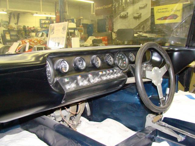

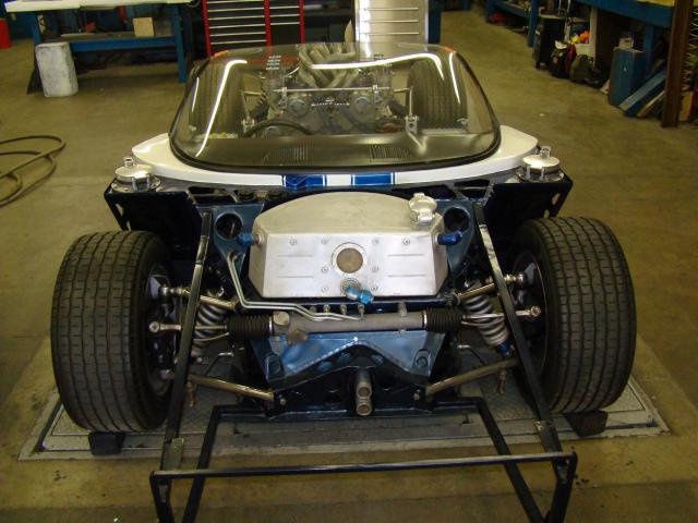

Deans car as with all the eary prototype GT-series cars originaly had the correct motor mounts for the 256 pushrod indy engine which was the first and original engine installed by ford in these cars. At least up thru GT109 as I have never been around or worked on 111 or 112. I have no info or reason to believe they would have been any different. The 255 4-cam used the exact same oil pan and front cover which is where the motor mounts are and not on the block like a 289. So the 4-cam is a direct bolt in if the original motor mounts are still in the chassis.
Dean has 2 engines from AJ Foyt. 1 in full race trim and 1 is detuned a little with 48 IDA webbers and fully polished. Dean cast the manifolds himself years ago.
109 as with all the other GT series cars original came with a Colletti which he still has but now has a ZF.

As I understand it, the early FAV cars were set up for the 255 type BLOCK with pushrod heads, sort of a "hybrid" engine. i.e. the aluminum block with 260 style heads and intake.
To my knowledge, no one has ever produced documentation that a 255 DOHC was ever raced in the day. The DOHC may have been installed but not actually raced.
The 256 pushrod engine is no more a hybrid than any other race engine. There is not 1 part on it that came from or will fit a 289. A pushrod indy engine is identical in how it mounts to a 4-cam engine and is nothing like a 289. Both indy engines use the same mounts on the front cover and rear of the oil pan and have no provisions for motor mounts on the block as it was thin wall cast aluminum. Trust me I have owned both and have 7-8 now. I also know for a fact the GT series cars all had the matching motor mounts on the monos for only these engines. I have the original FAV blueprints showing the revisions for the 289 style motor mounts coming much later. I have photos showing pushrod indy engines going in and out of cars into 1965. The pushrod indy engine was raced in the early cars until shelby convinced ford to switch over to a less complicated passenger car engine his mechanics could understand and service. Who ever thought electronic ignition would work out.
