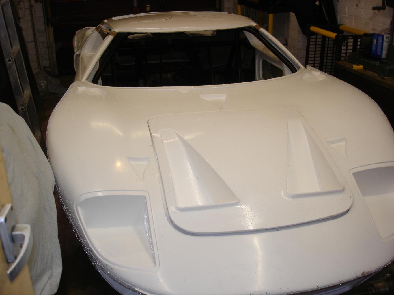

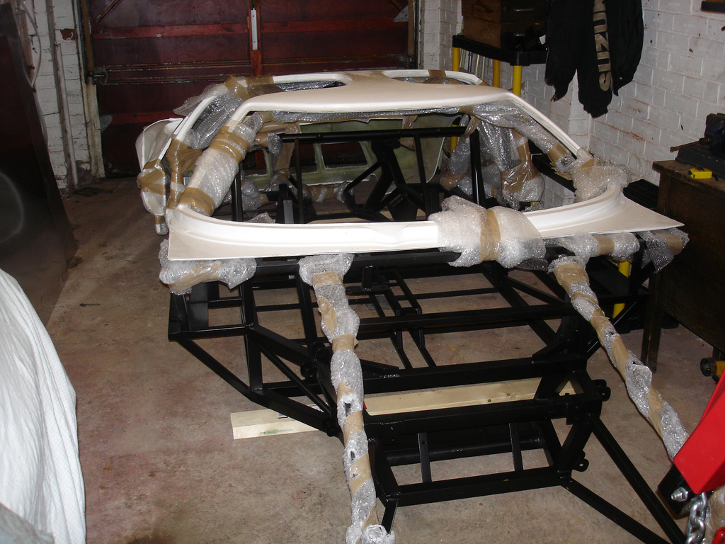

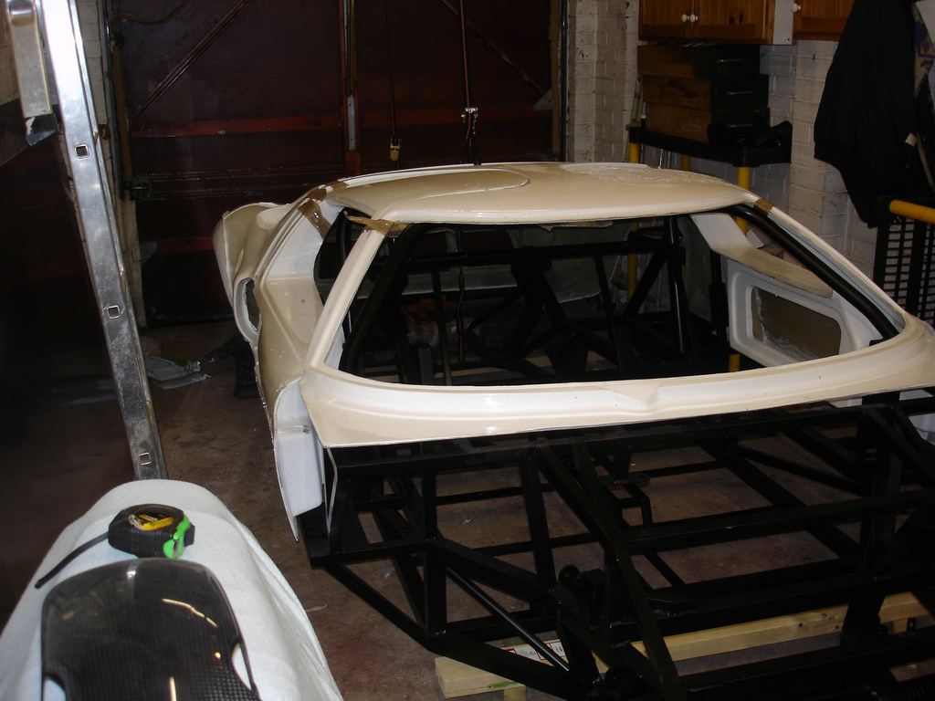

So far I've 'fitted' (rested may be a better term) the bodywork and sat in it before taking the bodywork off again.
Although I 'knew', it takes having the bodywork sat there to realise just how much fibreglass 'work' I'm going to have to do, time to invest in some paper suits and a new dust mask alongside a powerfile. Nothing 'new' as I've done plenty of fibreglass stuff before but I hate working with it!
The chassis is nice, I was amazed at how light it was, took just the two of us to lift it (and spider) into the garage.

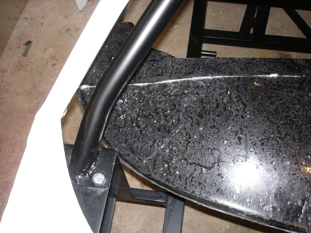

The first issue I've already run into is I know I'll have to cut the dash for the roll-cage, I slid it in (while 'fitting' the bodywork) and went 'Oh' as it only got within a foot of its correct position. ;)

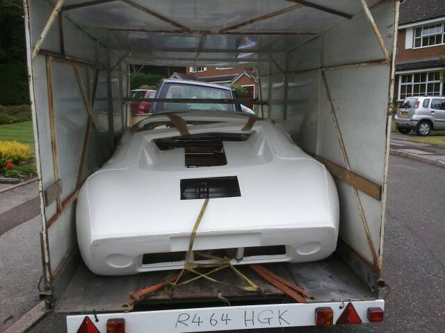

I've got some more pictures but can't upload them at the moment (filesize limit on the proxy), so have to have just this one lo-res one of it arriving.

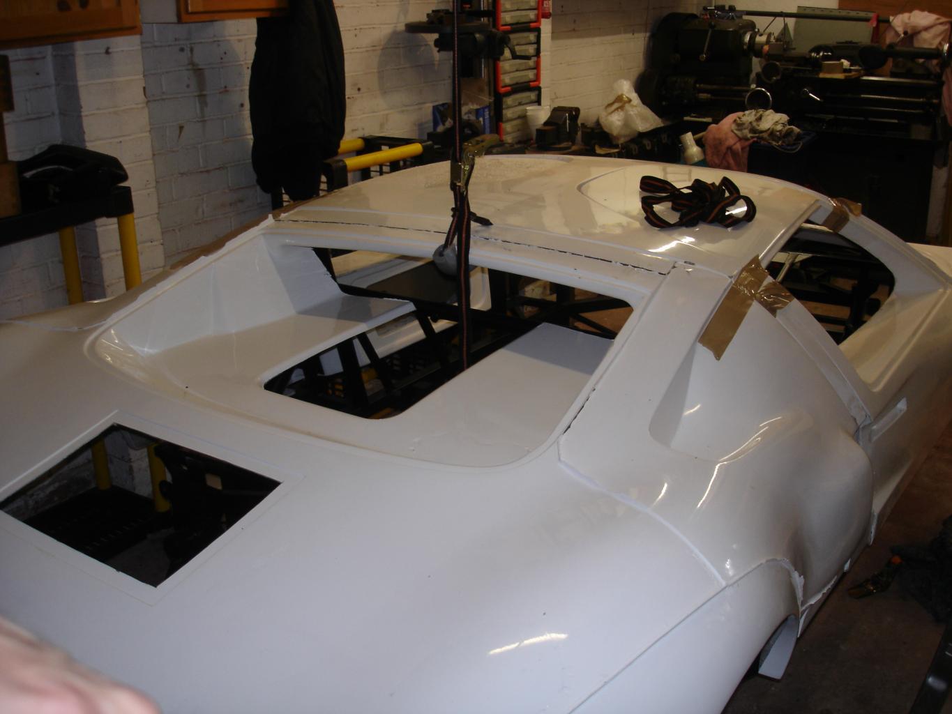

I've attached some pictures although it keeps failing so only two for now!

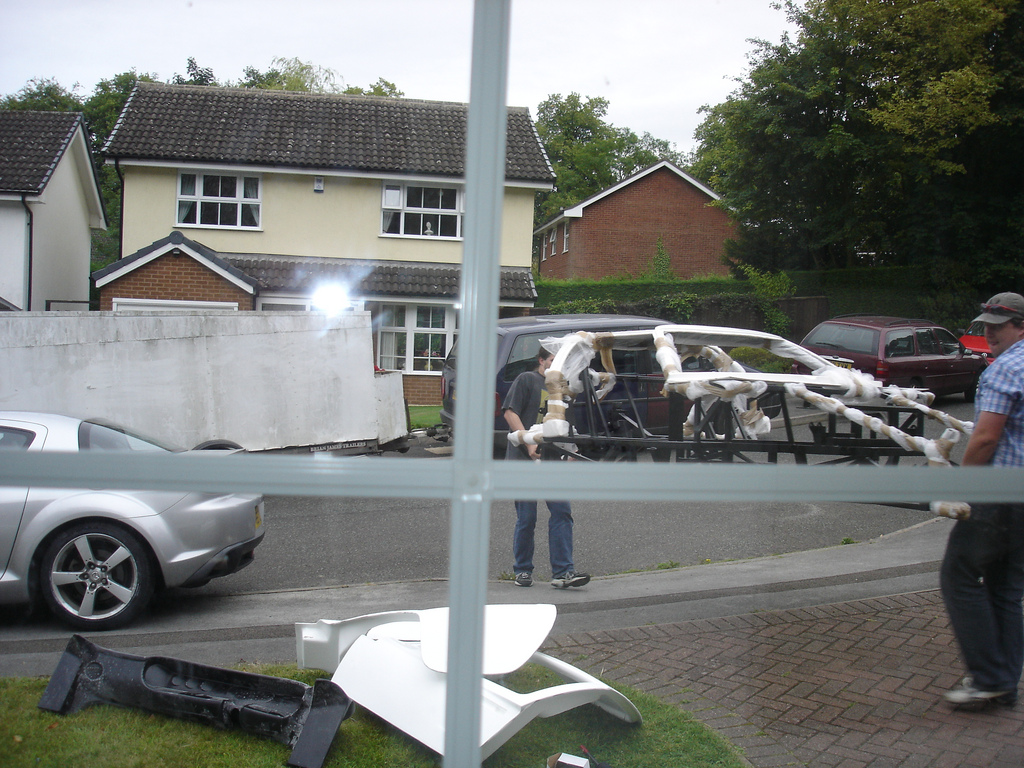

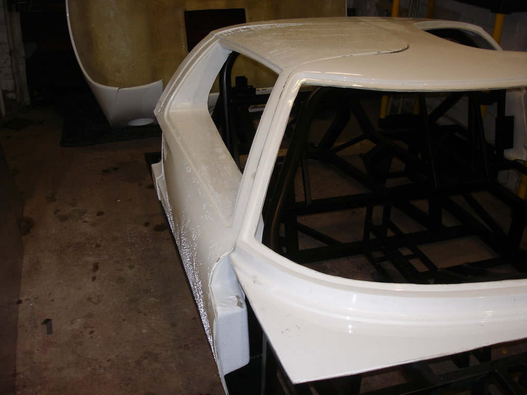

Some more pictures.
I tend to be a bit of a photo junky for projects so I shall be uploading them to flickr and just posting a few here, should anyone want to look the rest through they'll all be at: fastdruids photoset.
So far today I have yet to do anything on the car, all I've done is move bits of bodywork around. Reconsidered my plan to have the front/rear clips in the 'build' garage, just too big and I couldn't get them into the rafter space so I moved them to the storage garage. I was thinking about it though and as I have power (a generator!) I can always do a large amount of the bodywork in there and save some of the mess that would be generated in the 'build' garage.

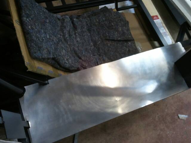

I did the first panel last night (apart from the fuel sender access hole) and while its turned out OK I'm going to get some easier/better tools and may end up re-doing it at a later date.
I started with the air shears which made fast work of chomping through the sheet but are too loud (and the compressor is even louder) to be used at 11pm! Hand shears are of course next to useless let alone on a panel this size so ended up taking the air motor off the shears and driving the blades manually which worked but was slow and awkward.
Next is the other side which should just be a reversed copy but then its the panels on the rear of the sills (behind the bulkhead) and quite frankly I'm not sure how I'm going to do them thanks to the roll-cage. I can't even get a piece of card in place without folding it almost in half.
