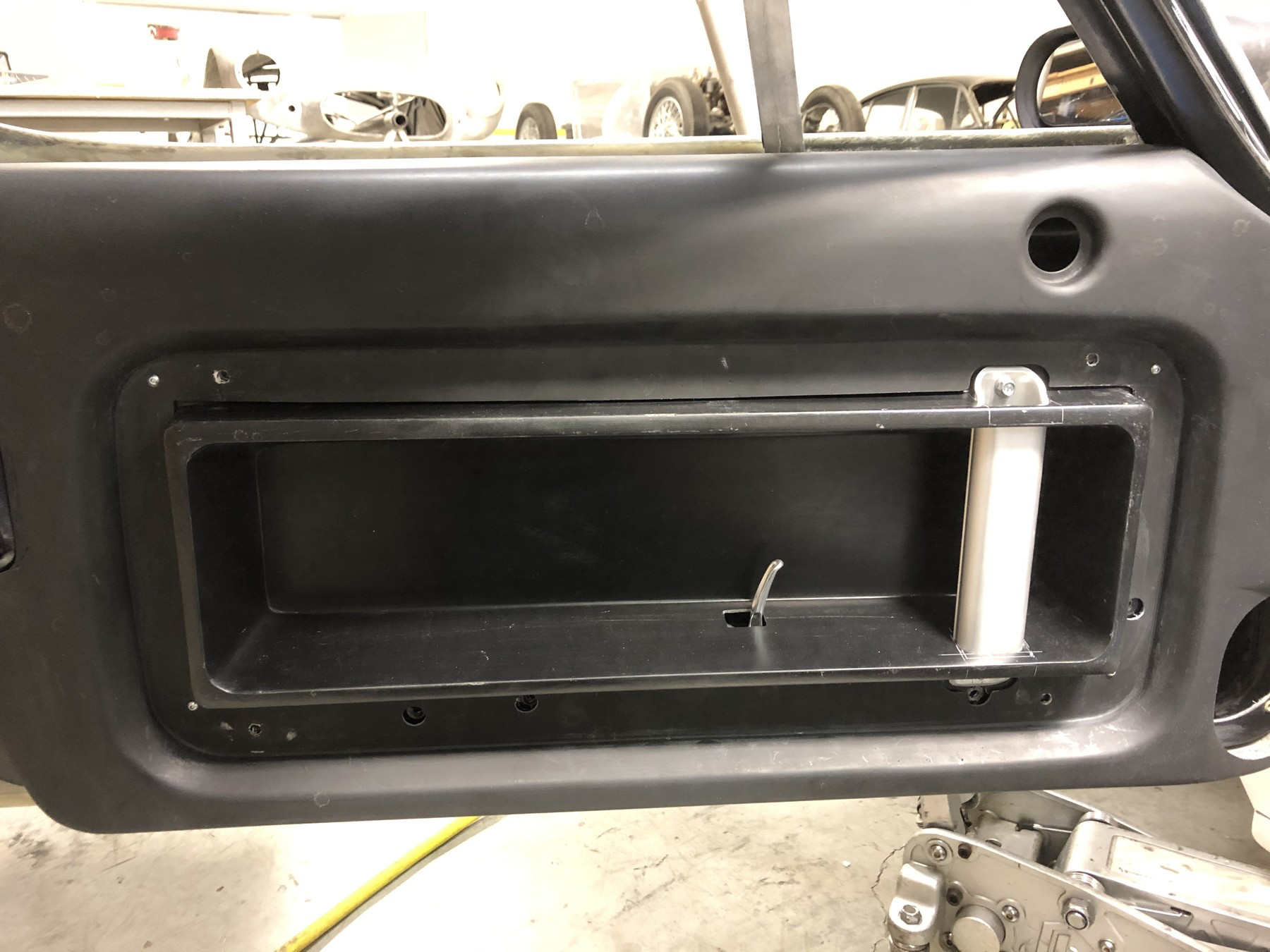

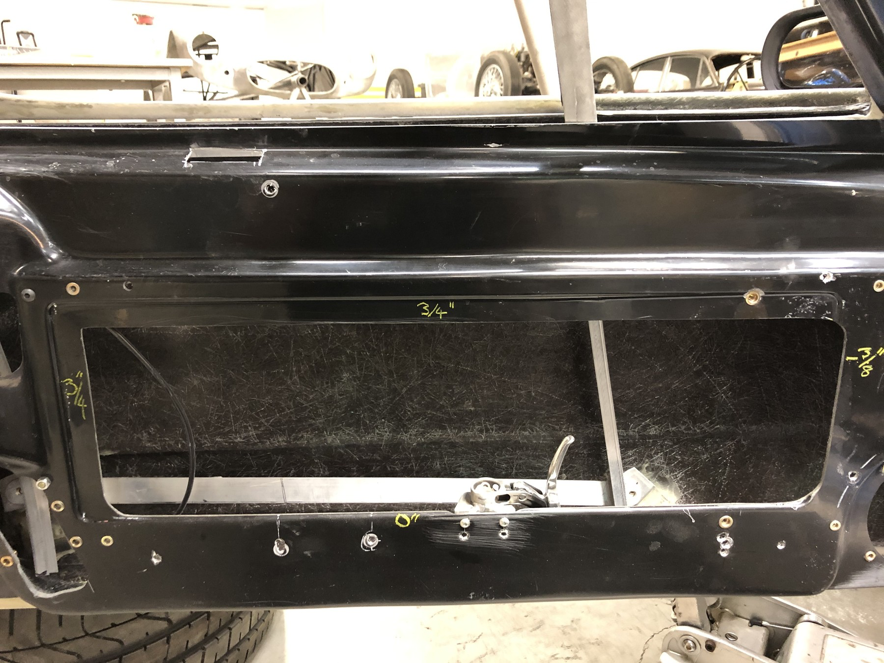

First off is to trim the inner door skin to accept the door pocket.
Here are scribe lines on the pocket to show where to trim for the door pull handle.

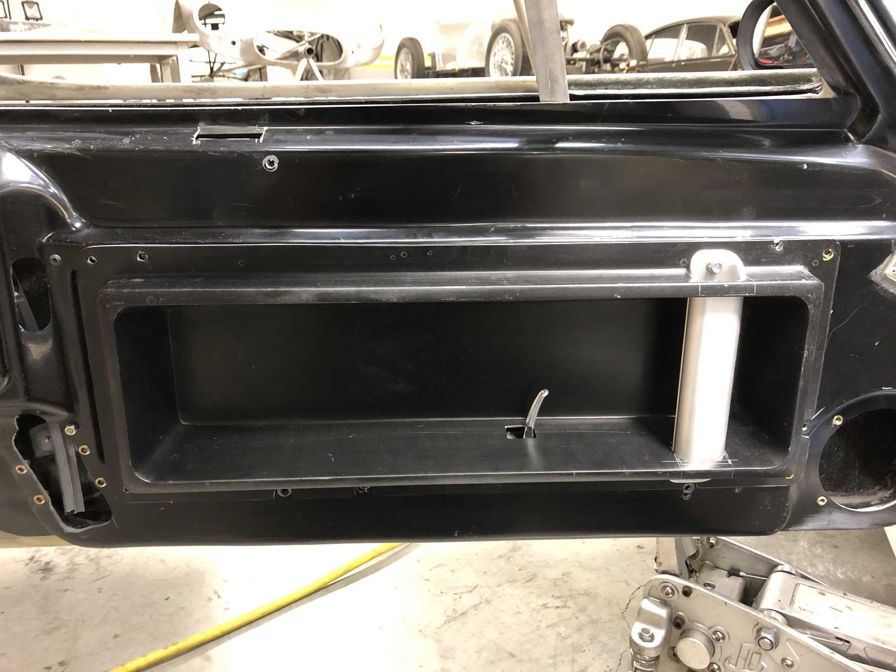

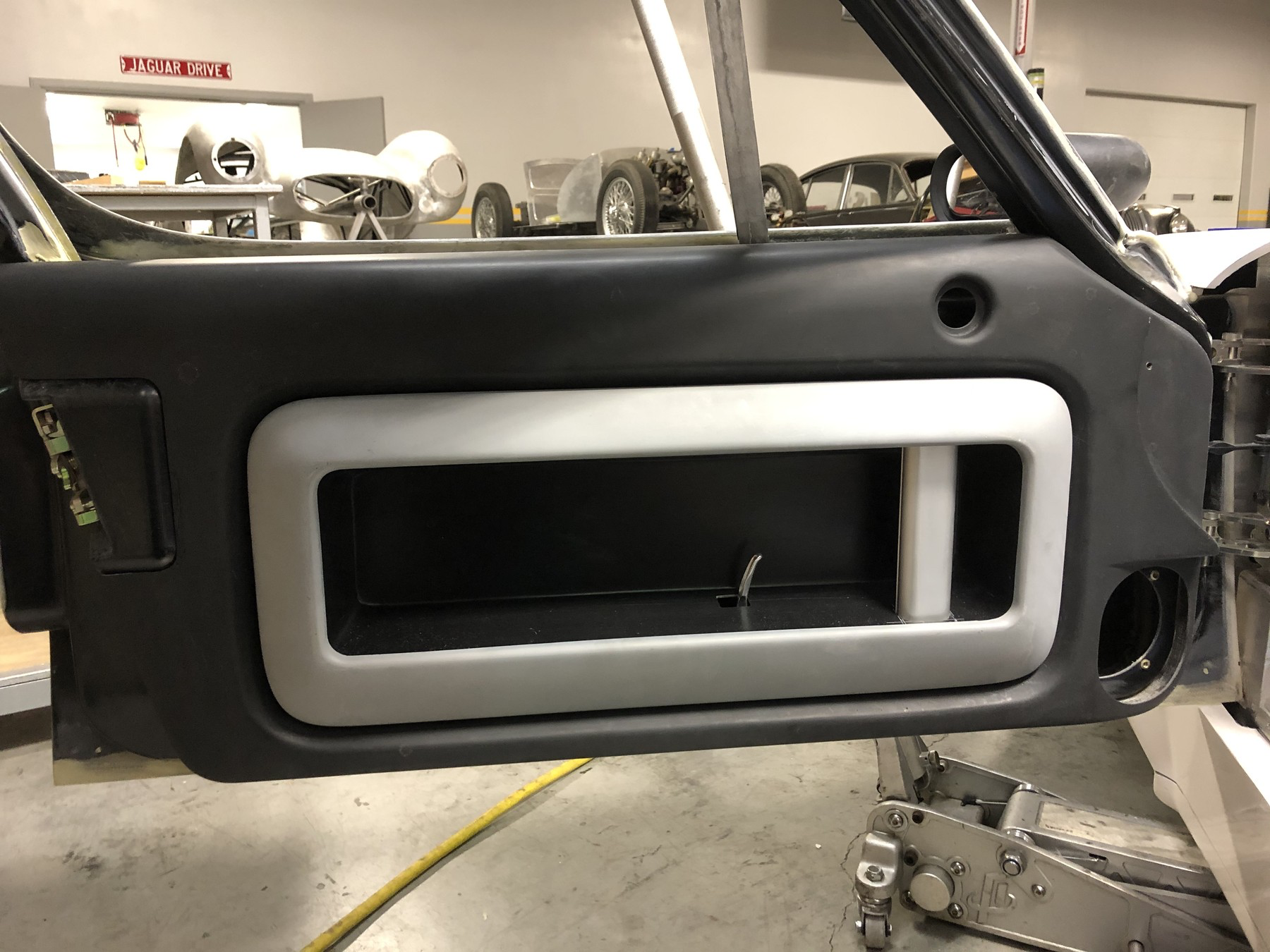

The door pocket is then fastened to the inner door skin by two 6mm bolts into riv nuts.

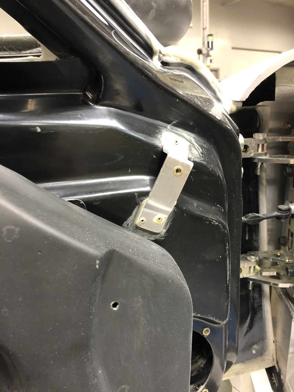

the main door card is then fastened to the door skin by six 4mm bolts into riv nuts four of which go through the door card and pocket into riv nuts in the inner door skin. the other two will need some simple brackets to hold the riv nuts.

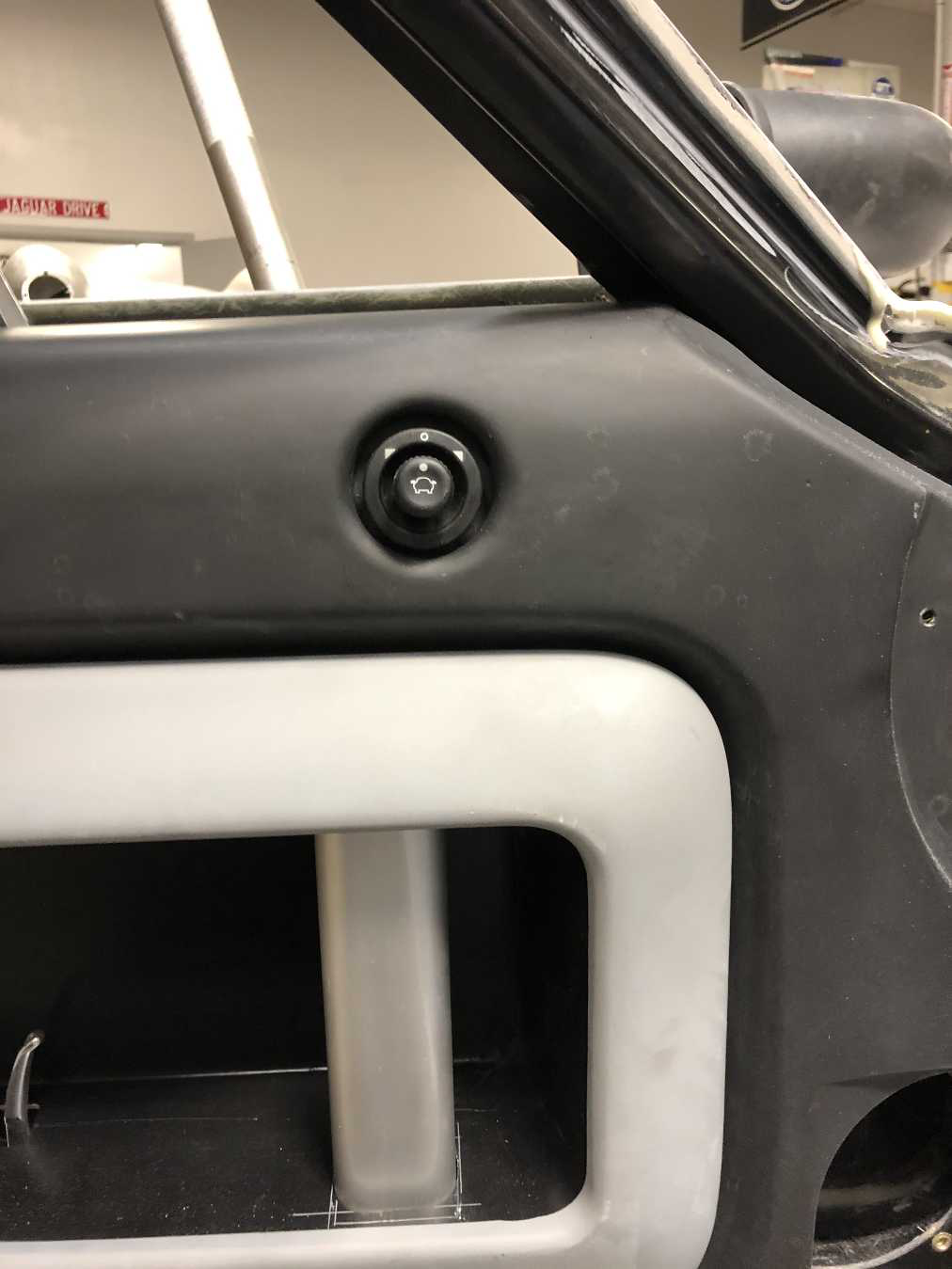

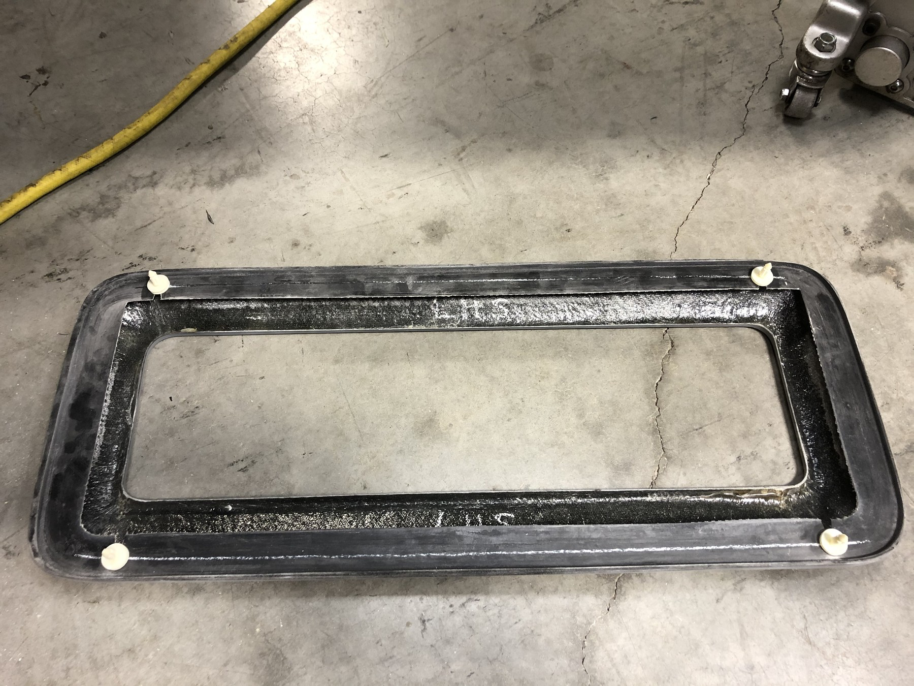

The trim ring.

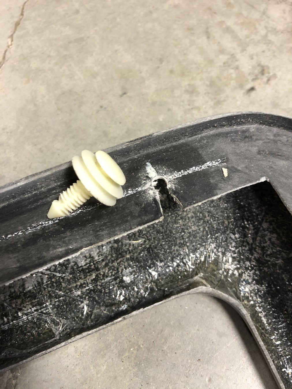

for fastening this I use christmas trees.
The christmas trees go through all three layers, door card, pocket and inner door skin.

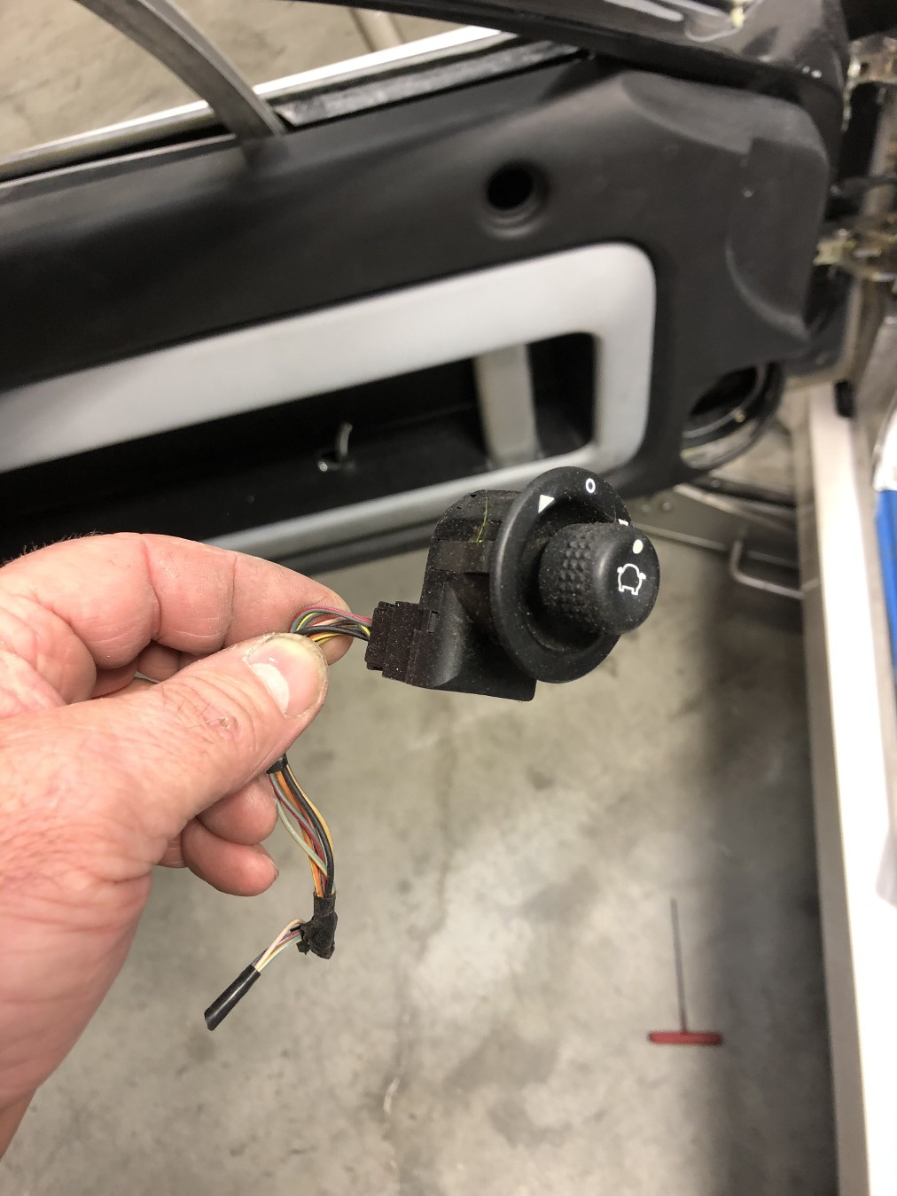

If you want to use the mirror switch this is off of a Ford Focus, F350, Ford GT etc
