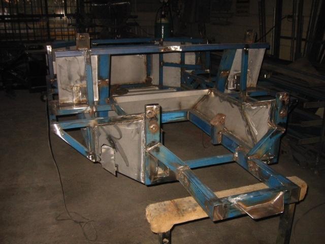

Looks like Peter has started building chassis #64. Not to much
longer to wait now. I have accumulated a mountain of parts.
Plan is to take 4 weeks off work and work night and day on the car.

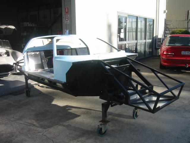

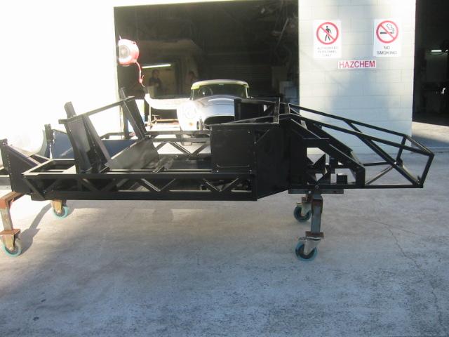

Chassis is finished and painted black.
Waiting for the body now.

Looks like the car has a spyder.
