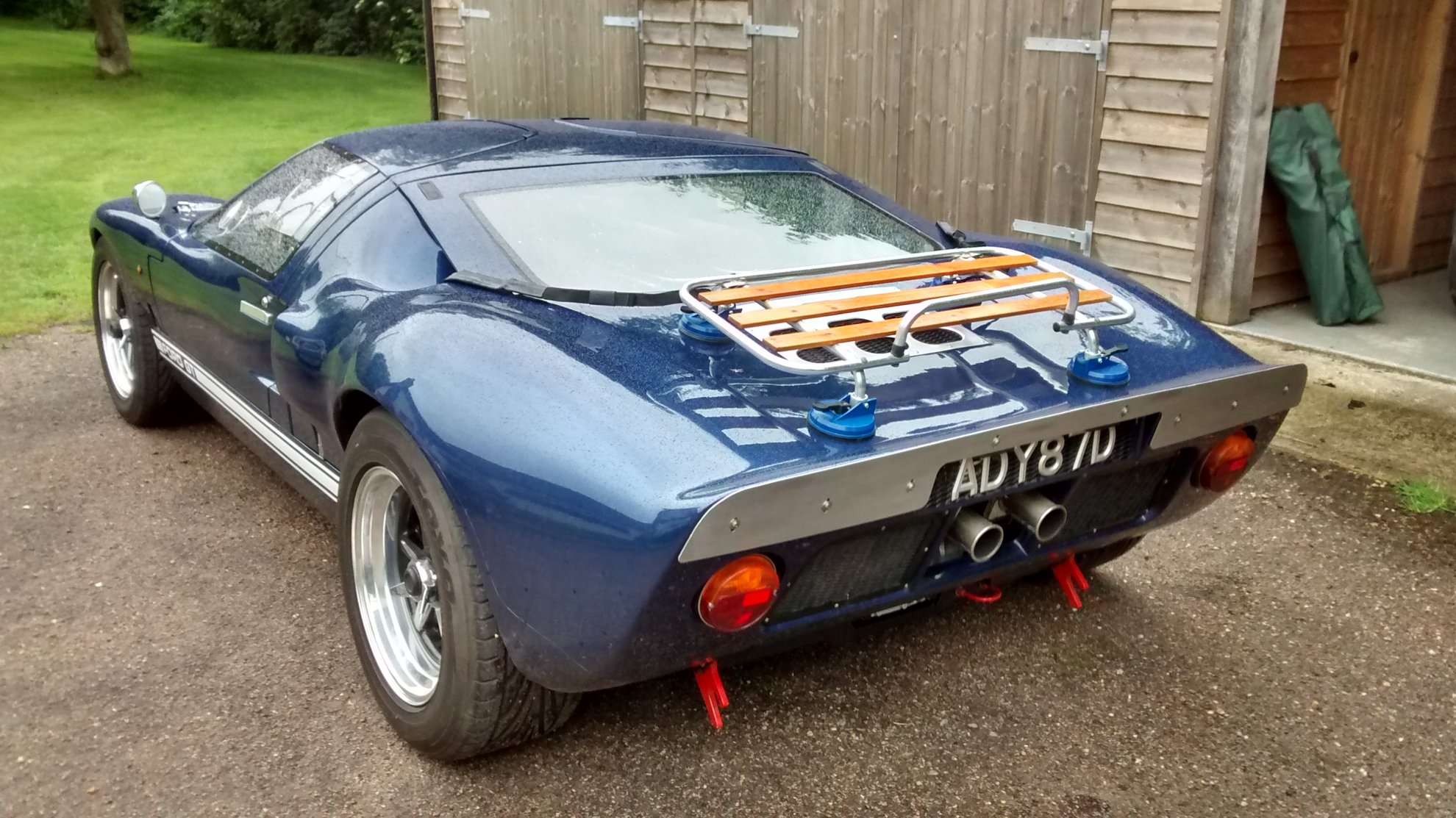

I’ve done European tours (LeMans & the Spa Classic) in mine with no real issues. I’ve a custom made 30Ltr luggage box under the rear clam and a soft bag fits under the front access panel. I also have adapted the attached, which looks really cool with a wicker hamper basket fitted

That’s pretty nifty with the suction cups. I was thinking about some felt covered rare earth magnets, but I need to do some shear testing with them.

Was the rear clam 'reinforced' any to head off any stress problems that might occur, or wasn't that necessary?

No additional reinforcement was added, as any load is spread over a large area, but I did find micro fretting of the paint, fortunately these polished out OK. For later use I added some paint protection film under the suction cups.
