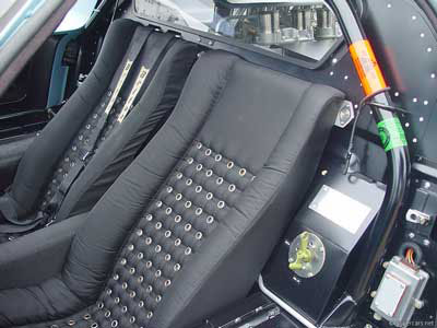

Can anyone tell me which seats these are and where I can buy them ?
Ed McClements

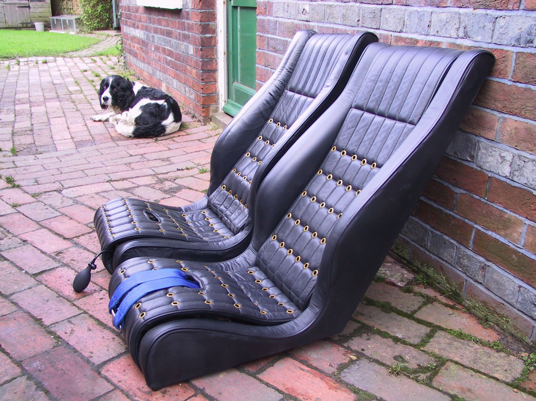

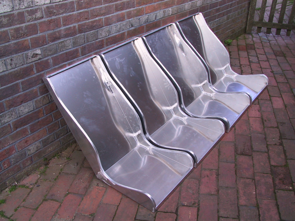

Looks like an original GT40, or maybe a perfect copy like the Gelscoe cars (or other faithful, exact copies). The seats aren't seats in the conventional sense - the bases are webbing straps which are stretched between welded-in mounting strips:-
The seat backs are glass-reinforced epoxy resin - GRP or fibreglass - which are separate, and retained to the firewall (by Dzus on the original cars, I think?).
@shaunybean on here has re-created them for his build. Pic above is another Gelscoe car, for no other reason than there are plenty of good pics on their website. @brianstewart re-created a pair for his CCD-chassis build; see on the Build Logs on this forum, and on Pistonheads:-
The upholstery is some form of fire-retardant nylon with minimal padding and the all-important eyelets.

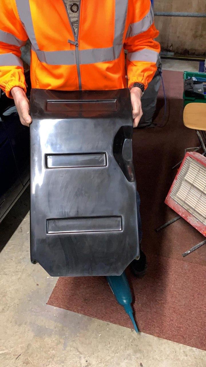

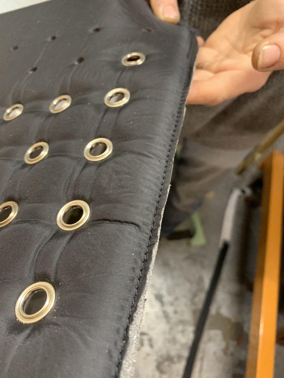

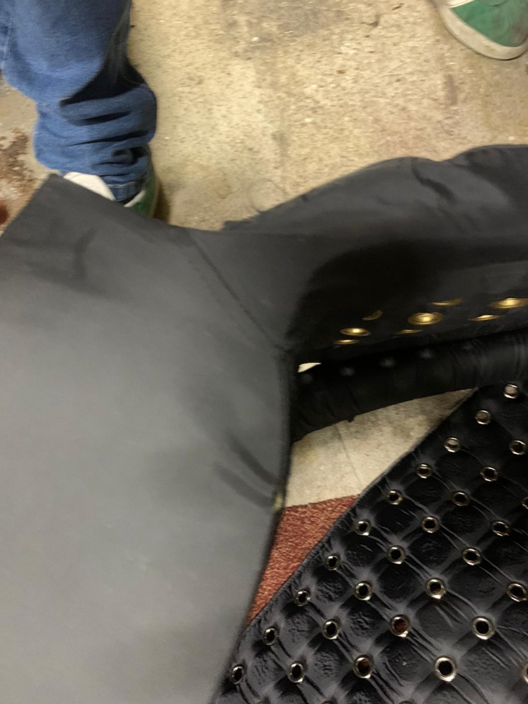

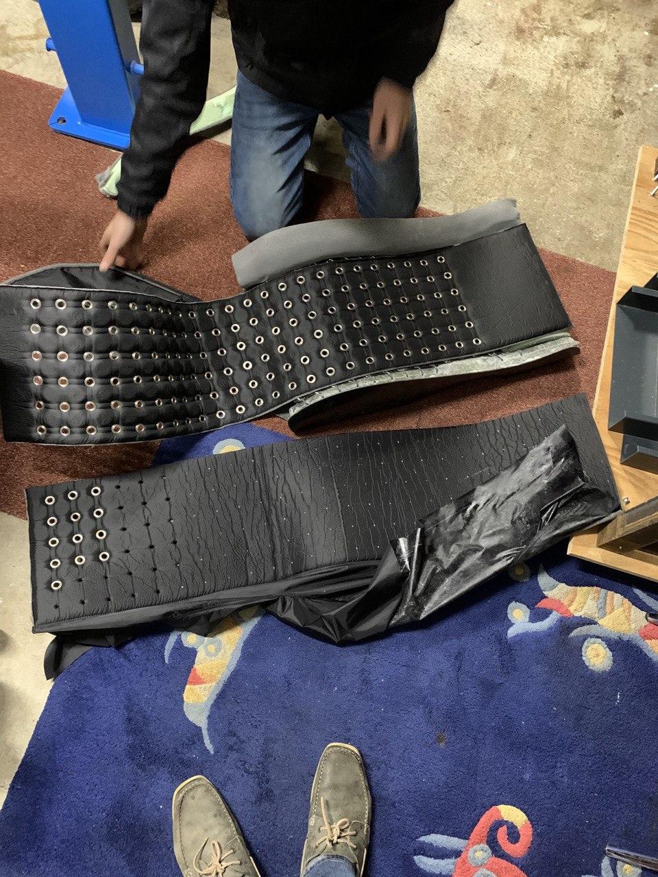

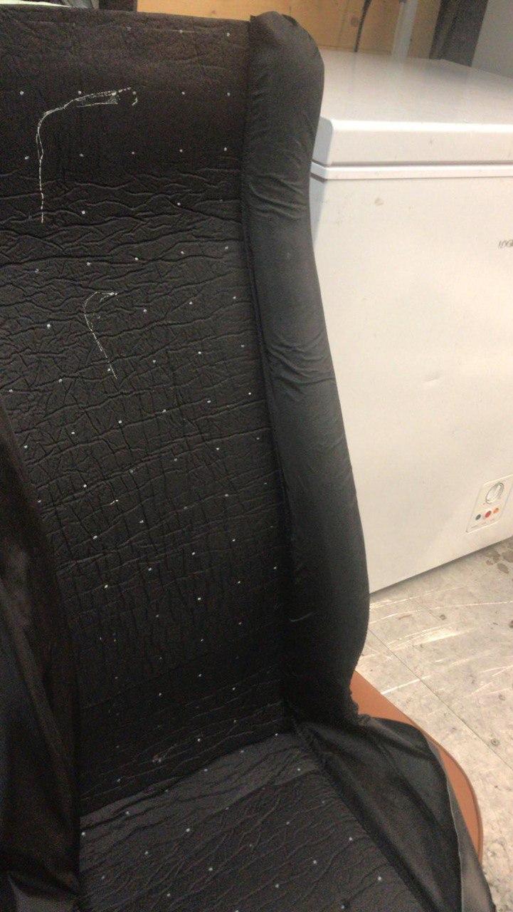

So.....in reply to this, with thanks to alot of help from people in the GT40 community I am definately getting there. There has been alot of looking at photos and working things out and making of prototypes, but I think we are on the final run.
photo_2020-10-06_19-07-06.jpgphoto_2020-10-06_19-07-29.jpgphoto_2020-10-06_19-07-33.jpgphoto_2020-10-06_19-07-36.jpgphoto_2020-10-06_19-07-41.jpgphoto_2020-10-06_19-07-44.jpg

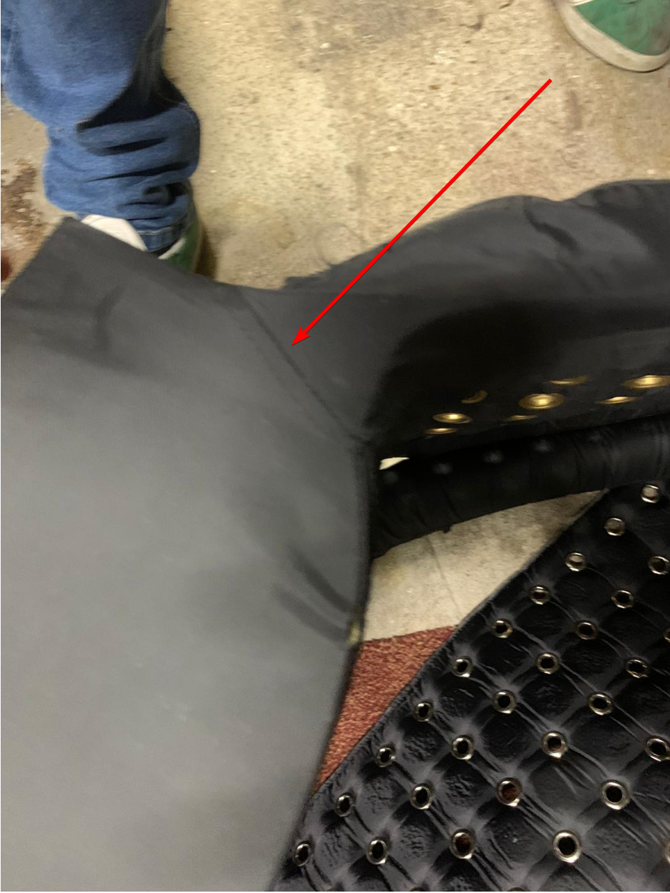

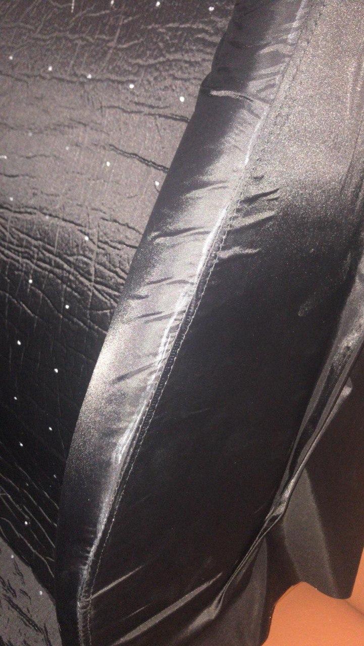

I have however hit a bit of a road block, so I wanted to see if anyone on here knows anything. It seems (suprise suprise) that there is some differences between different car's seat, the key one which is troubling me is wether to create the lower bolsters as a seperate stiched part, or to flow the material around the bend (see the difference below, blue seats are one piece, black seat has a joined piece). A seperate piece would stop the fold looking so creased and puckered, but it does seem that a fair few of the origional cars just kept it as one piece.

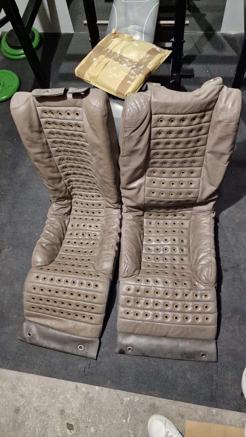

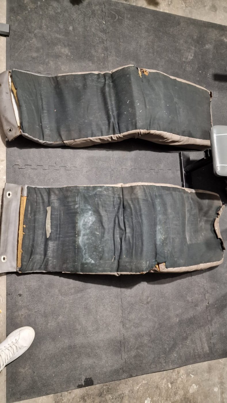

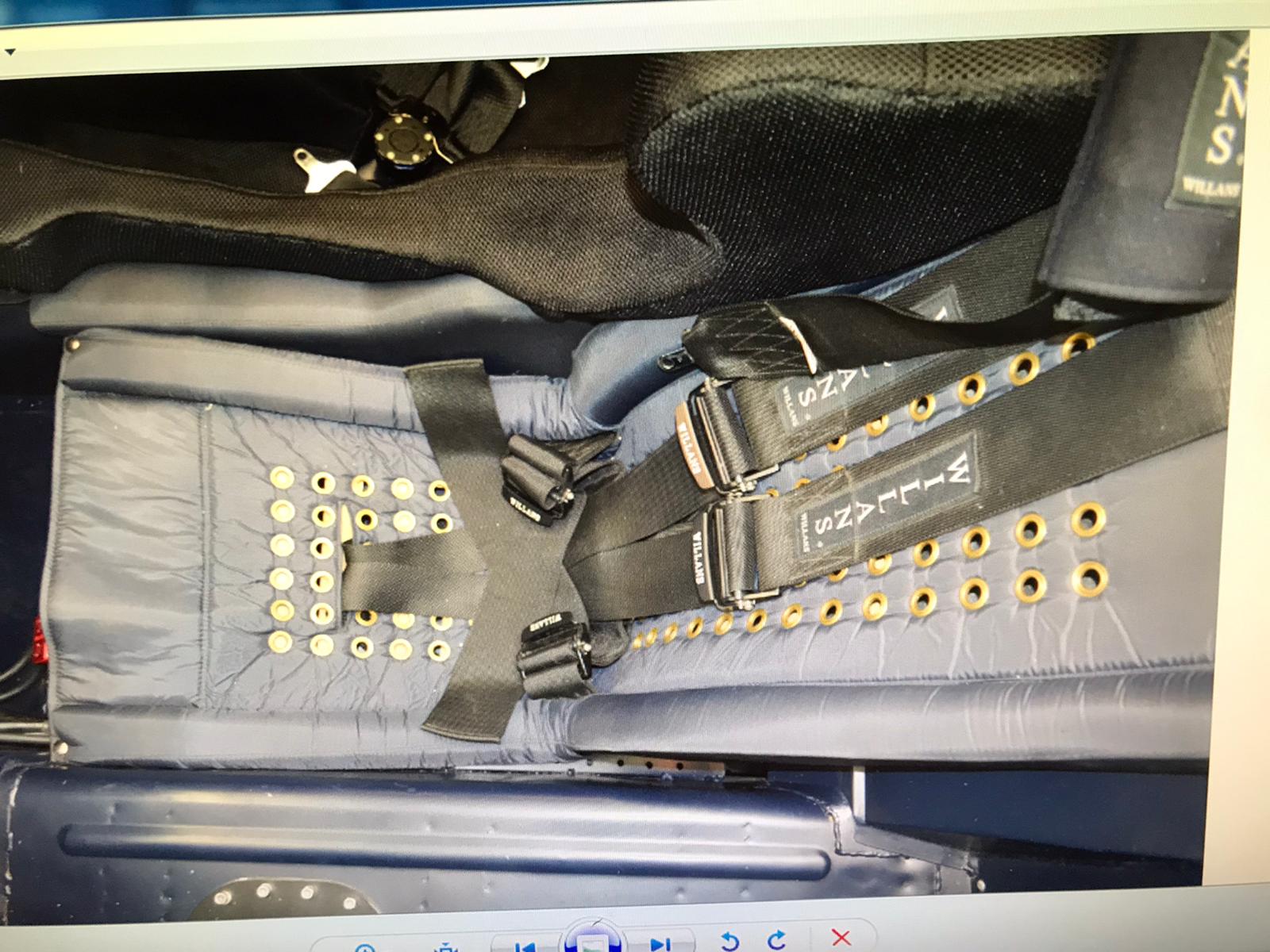

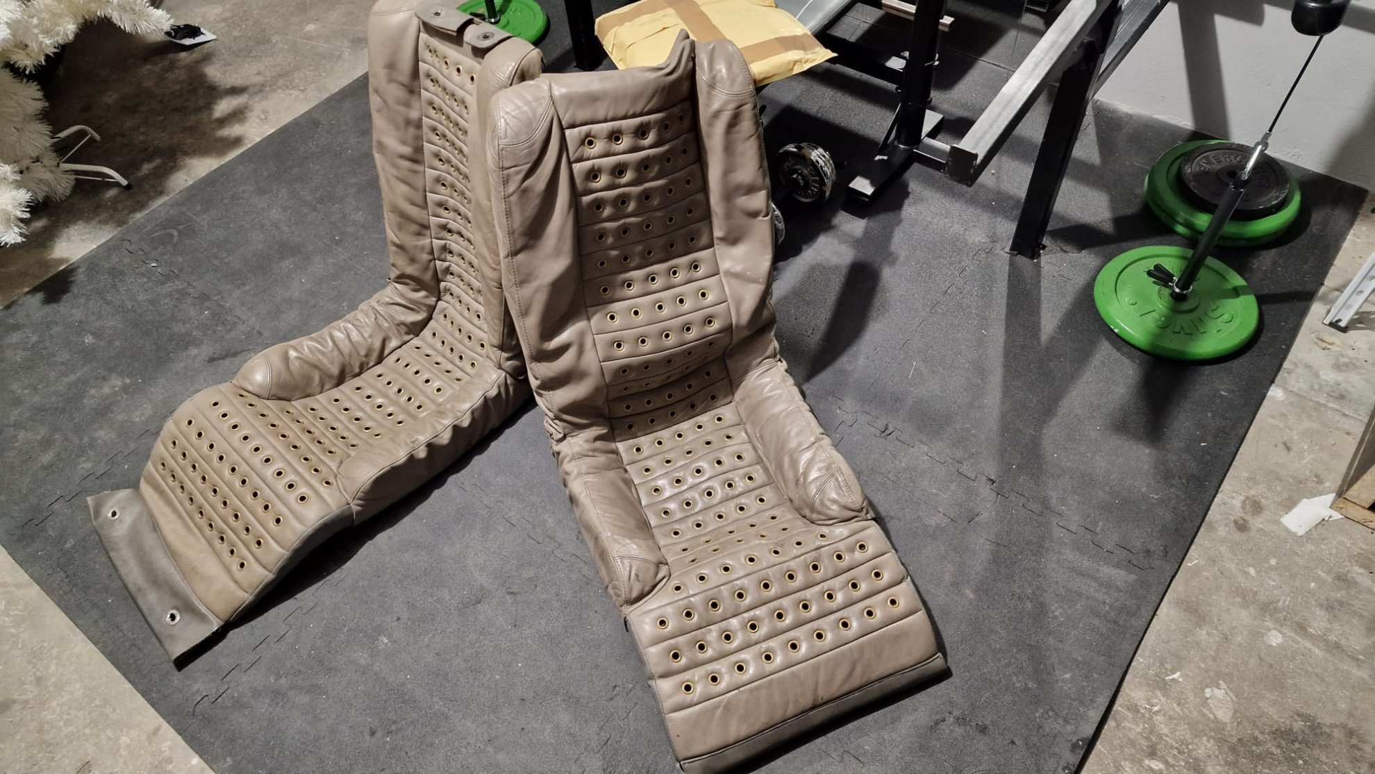

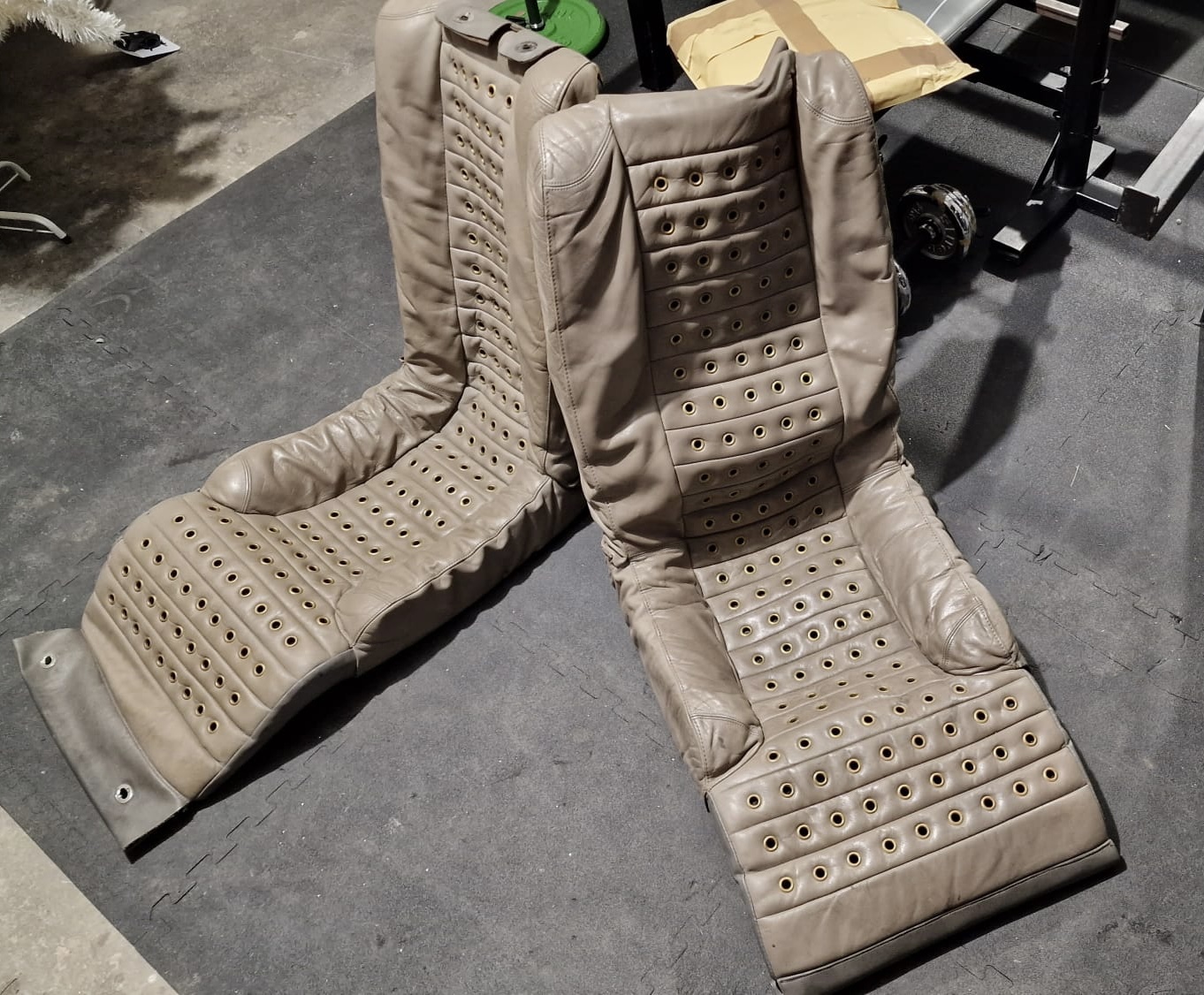

Shaun/Takis, I am very late to this post but might help anybody else in the same position. I have recently purchased a pair of original seats which I will be using in my car and gives a good idea of the assembly.
