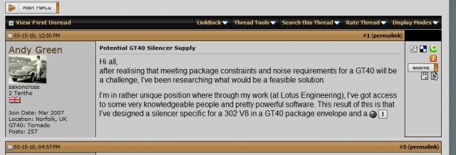

Ah - I see the problem. It looks different in Safari!
attachment.php
Hence my post #2! This is what I get when looking in Safari. Not sure why - maybe the admins can see?
Tiz Ok in IE.
Re: Potential GT40 Silencer Supply
I get the same thing in Safari on my Mac.
Yet FireFox on my Mac shows the page normally....
Very odd...
