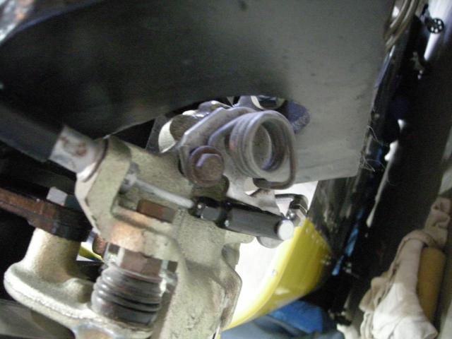

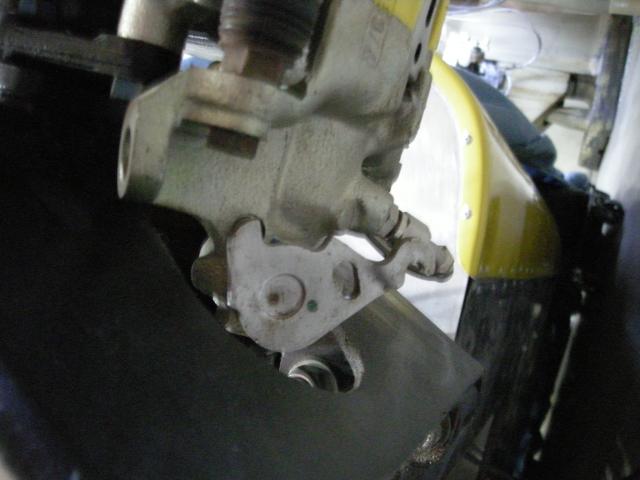

Ha All,
My GTD came with only one side having the E-brake set up complete, and I want to set mine up to have it on both sides. Presently the left rear has it and the right rear doesn't. Would anyone have lying around the spring and bolt set up as shown it the pics attached for the right rear caliper.
Thanks,
Bob

HI Bob Thanks for posting the pictures as neither of mine have the springs I didn't know they were missing. ( I was wondering about the flanges under the bolt heads )
Wally,
Can you be a little more specific on what you are looking at maybe someone can help out then.

HI Bob You show the spring on the left. I have neither of them. Just got off the phone with Ford parts He is looking to see if He can get them. Wally

HI Bob Had a set of spring show up Friday from a 96 Taurus fit like they were made for this, Could have used the Taurus Calipers only there to wide for the rotor. Wally
