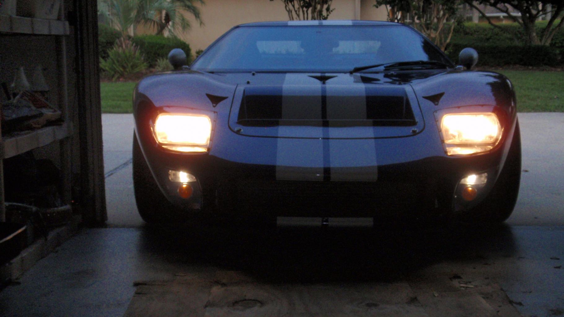

The good news, I replaced the halogen bulb that was in the car for 15 years and noticed the output significantly better. Apparently the bulbs age over time and as my wife reminds me regularly, "many things dim with age...".
When the technology develops a bit more and the cooling assembly gets a bit smaller, I'll probably go to LEDs for the simplicity.
While not a big change, here's the car with one side sporting the fresh halogen and the other the old one.

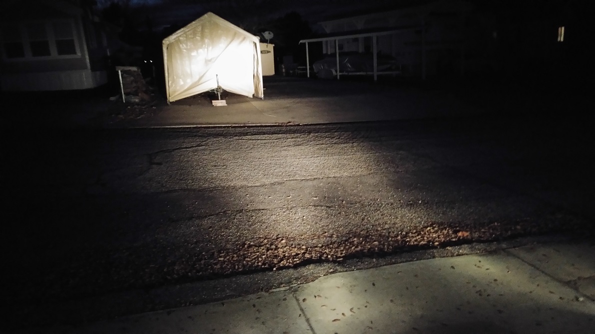

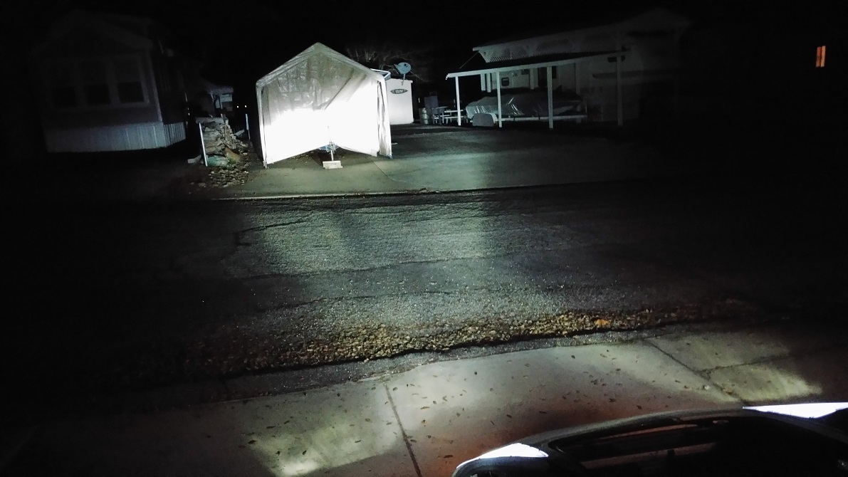

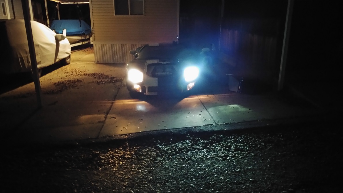

This is a timely posting!! I just switched to LED lights in my CAV. They managed to fit inside the existing inside lining and plugged straight into the current wiring. The only thing extra I needed was some little plastic conversion adapter rings to convert from P45T to P43T fittings (that took a little bit of searching to find what I needed!).
The difference (forgive the pun), is night and day! I very nearly hit a wild black pig. This prompted me to look into the change. 70mph and ~70ft before seeing a wild pig gives very very little time to react.
Anyway, the change was very simple, very effective and cost less than $100. I am going to dig out the links for people and a couple of pictures, although the pictures really don't do the change justice.
Another really nice side note is that the current draw is less. I also have LED bulbs on order for the back. They should be here next week.

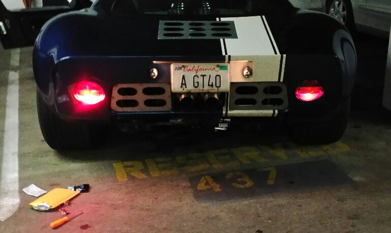

OK, I have also switched the rear bulbs to LEDs. Again, a big improvement! Here are the bulbs I bought off of Amazon:
JDM ASTAR Super Bright 78-EX Chipsets 1156 1141 1073 7506 LED Bulbs with Projector,Brilliant Red https://www.amazon.com/dp/B01J2KKMHE/ref=cm_sw_r_cp_apa_63cFybHNKMY6M
JDM ASTAR Super Bright 78-EX Chipsets 1156 1141 1073 7506 LED Bulbs with Projector,Yellow https://www.amazon.com/dp/B01J2JM7BE/ref=cm_sw_r_cp_apa_DmdFybMZNGEJ2
I went with colored LEDs, much better than relying on the color of the lenses with brighter bulbs.
I hope this is useful for someone.
Regards
Karl
They plugged straight in with no resistors. I did go with the same bulb for the break light and rear light. Although the existing brake light is as big as the indicator and bigger than the rear light. My thinking was that the two red LEDs will essentially combine to give more light when breaking. It really looks like a modern lighting setup now, especially with the front headlights too. Avoid going for white LEDs for the rear. I bought some and put them in thinking that the lens color would take care of it. Instead it overpowered the lens color. Those were also too weak. I found the ones I linked to Amazon work perfect.
