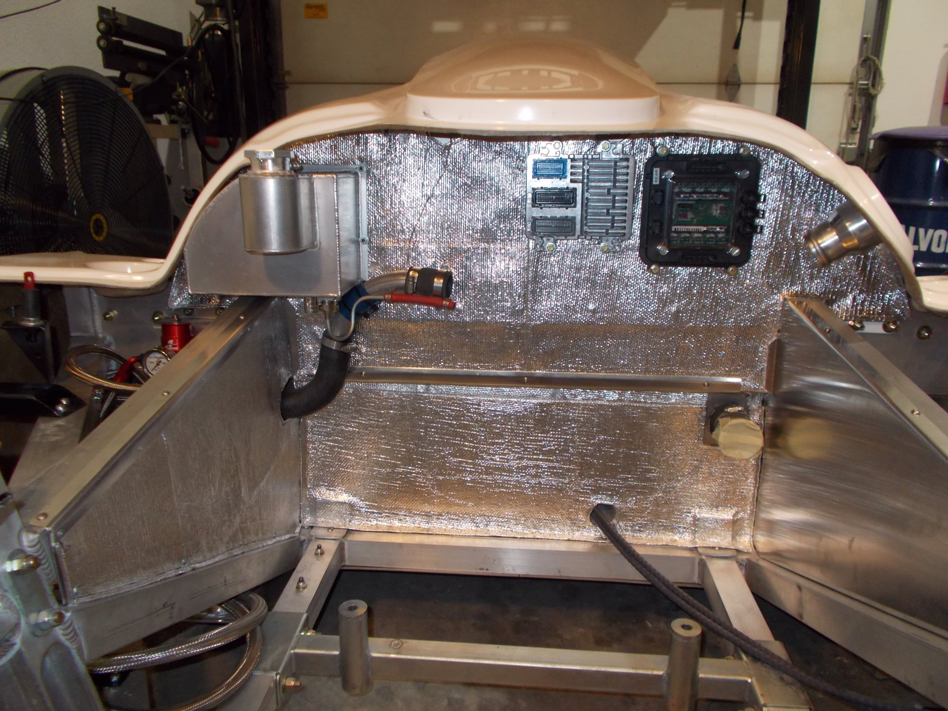

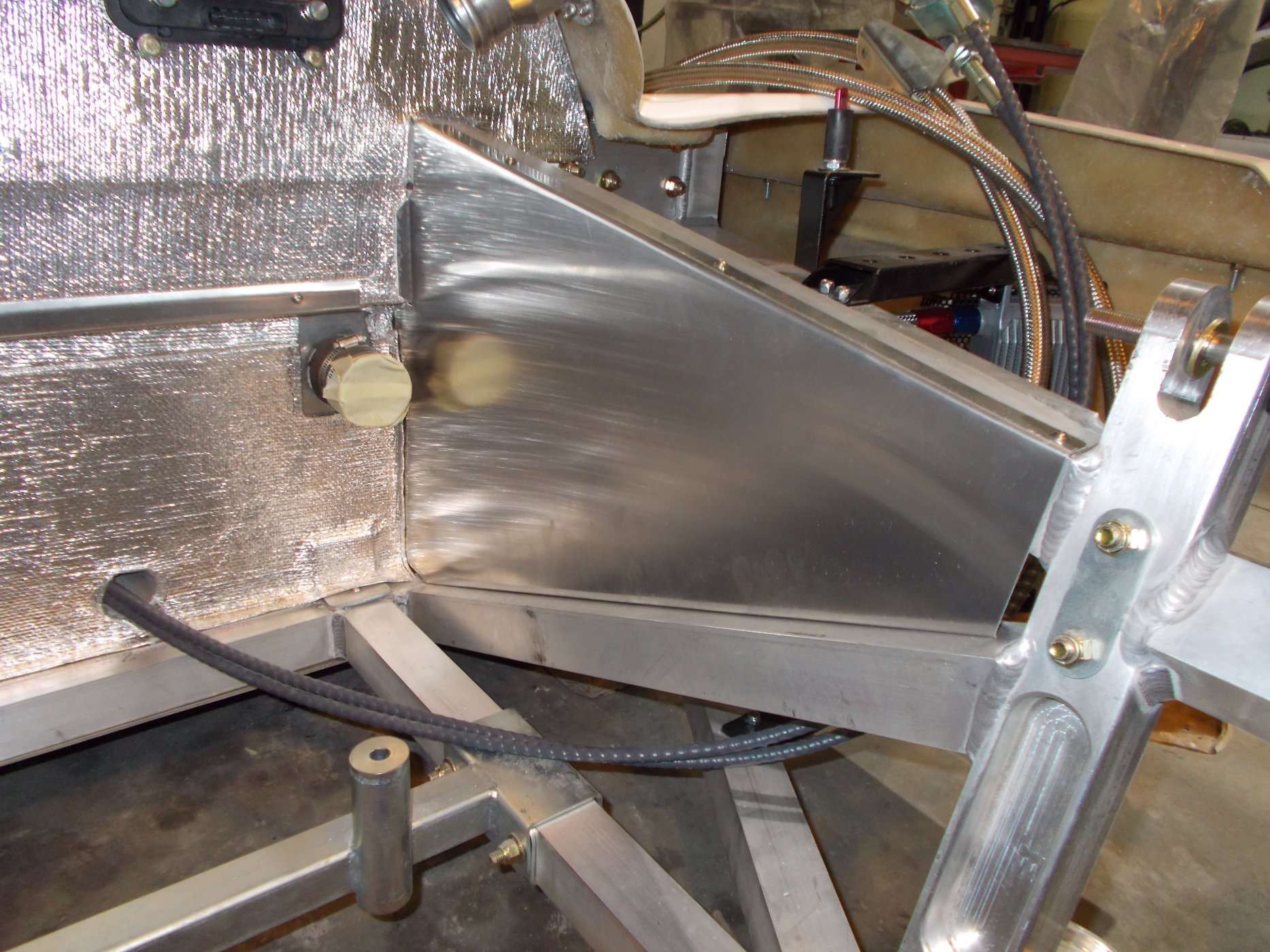

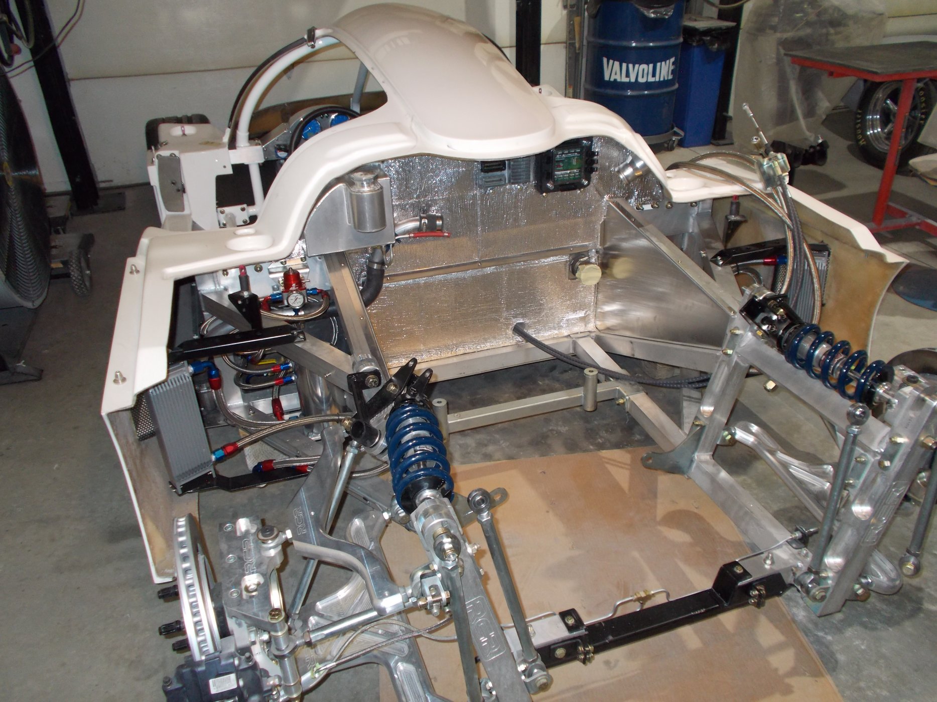

Check my build, I was able to use 1/8 alu on the rear of the engine and a second piece on the clam. Things have been good so far in some very hot weather.
