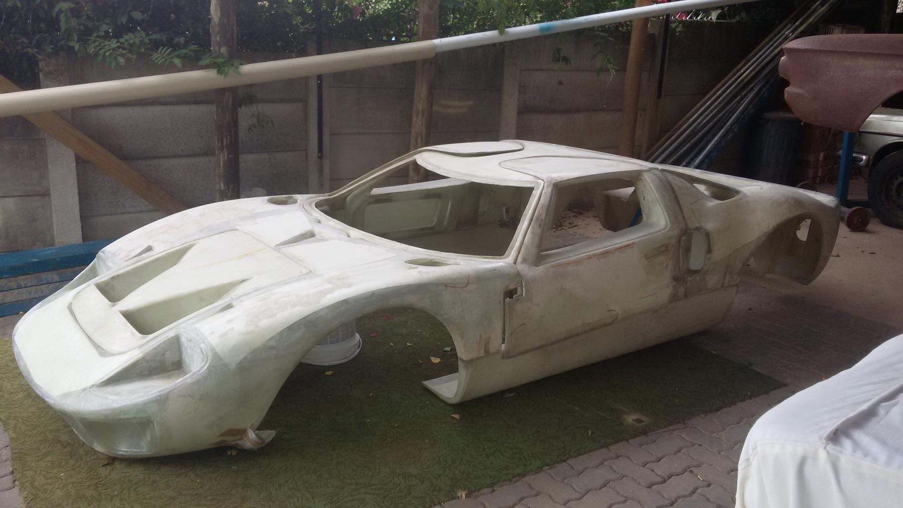

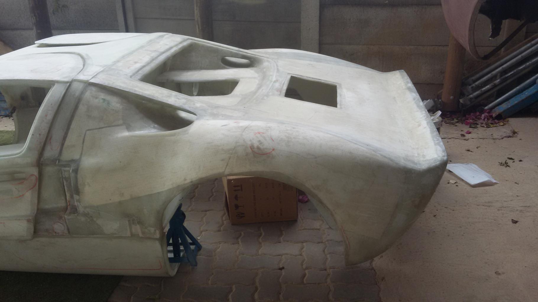

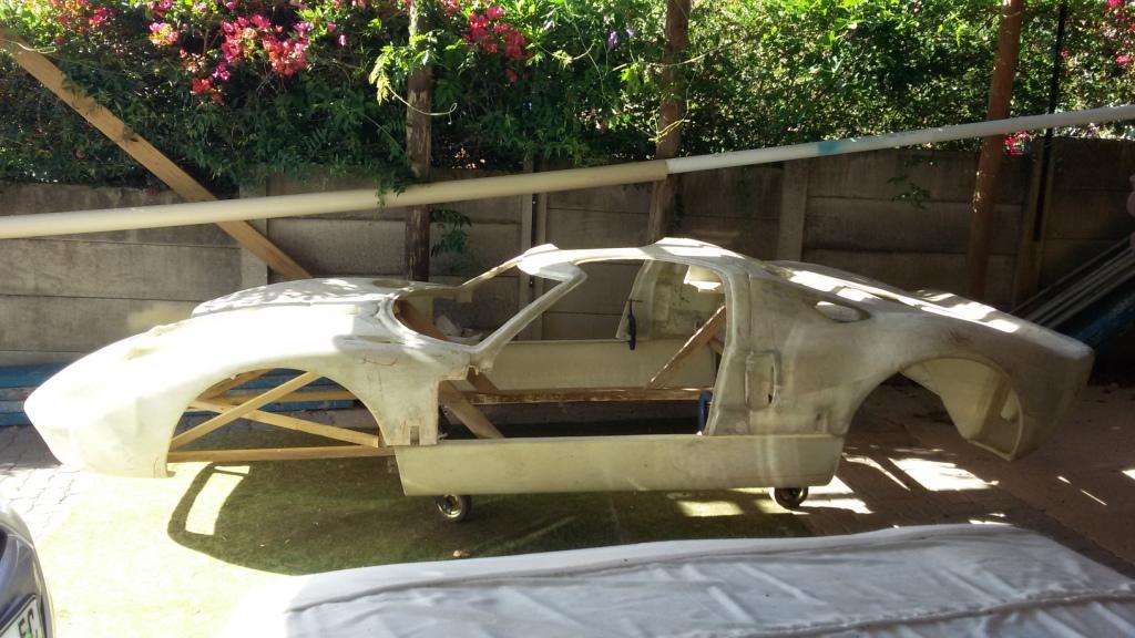

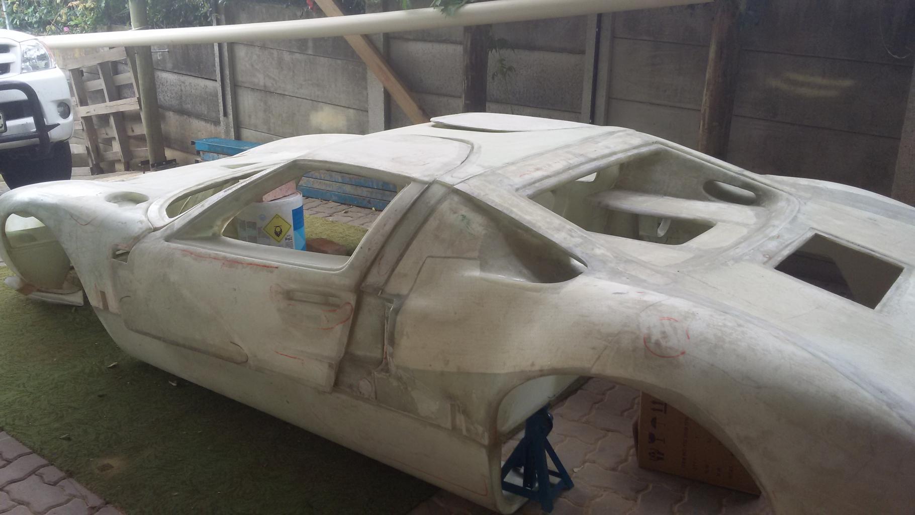

This is where the rubber meets the road. Yes, this is where it all begins and I trust will end with an end product that will look good, pay tribute to a legend and satisfy this 60 yr old need that I have had (to scratchbuild a car) never in the 60yrs did I imagine that it would be a GT40.
I bought the shell (as a reject body) from Jordi Reddy at CAV in Cape Town. I need to thank Jordi for letting me have the body for the equivalent of 2,720 US Dollars (glass incl).
For the folk out there who have not read my intro, I'm one of those old school hard headed guys that likes to "do it myself". I need to refit the engines to my '61 4dr Corvair and same with my '65 Monza Coupe, before I can setup a jig table to build the GT40 chassis. So I might be a bit quiet in posting for a while, I also have a lot on my fork at work at the moment.

Ah the beginnings of what will be a very nice GT40-MK1 !!!!!
Congratulations on the start of your dream!
Get yourself a CAV frame before you begin your restoration work - install a roll cage right away!

Hi Henty

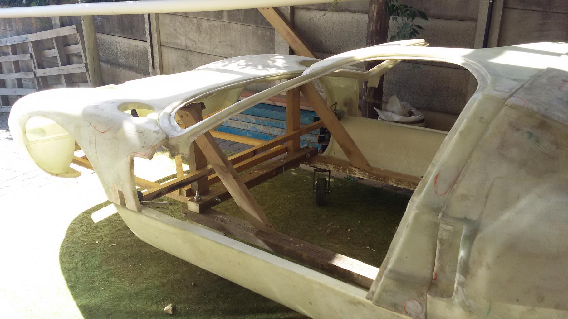

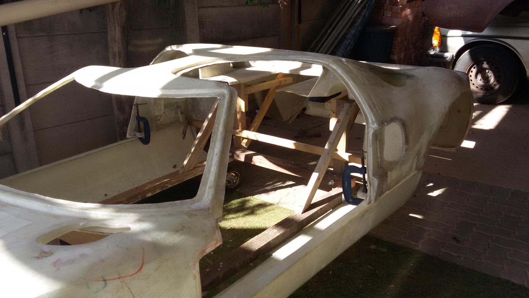

I've seen it recommended on here to prop the front of the roof above the windscreen as well, to prevent it drooping and the windscreen opening changing shape. Do you have a screen to test fit at this stage?
Fred W B
Hi Fred
The first fit that I did on the dollie had a support at the T-top junction, I decided to revise the fit as the dollie was too far back. I forgot to put it back thanks for pointing out that:thumbsup: much appreciated. I have the glass, front and rear, I have built a "box" to protect the glass, I have been told that a GT40 windscreen goes for about R21k:stunned: in SA.
The body will spend quite some time on the dollie so hence the big home made castors so that I can move it around as needed. I am a bit hard pushed for space 90m2 carport is protecting 5 cars and the GT at the moment!
I will get that T-top strut support back in this morning:thumbsup:

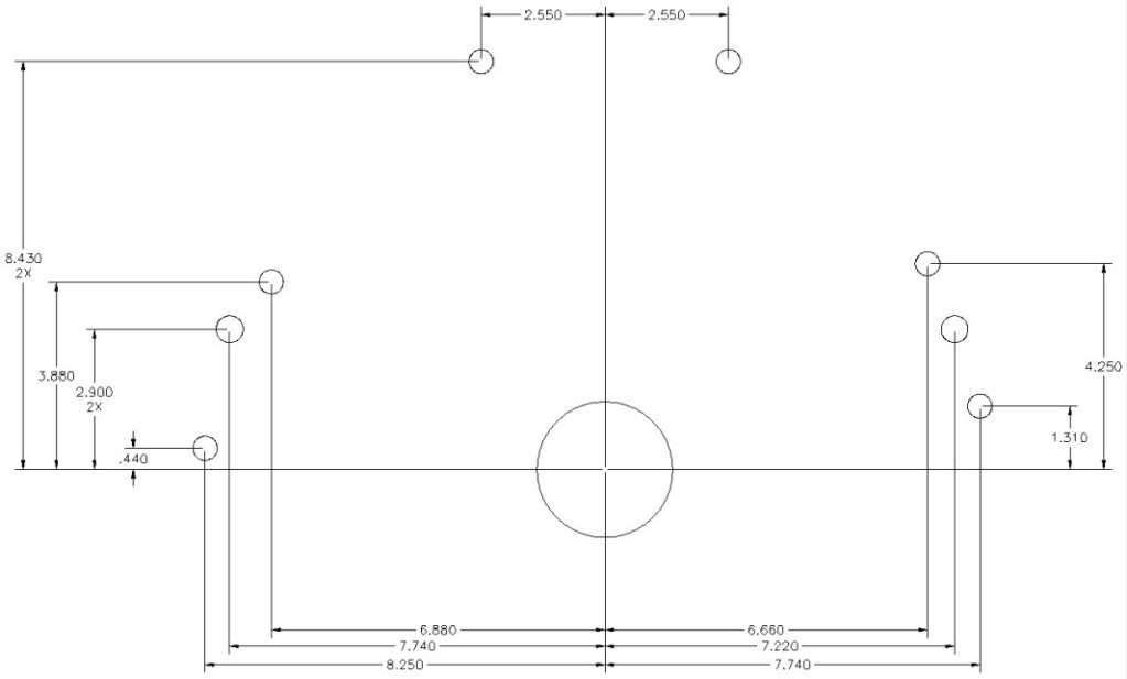

I trust you are all well, been some time since my last post. As I have mentioned I am using a 1972 Ford 351C engine and and the 016 gearbox. I have it in my mind that it would be wise to have the engine gearbox set up and incorporate that into the rear end build process or am I being too perdantic? being in Project Management I do tend to over plan I suppose! Simply put I cannot afford to go out and buy an adaptor plate & clutch kit setup. Next option is to build my own setup (I am fortunate to have a milling machine and lathe). I have started the ball rolling using CAD (card board aided design:laugh:), there is plenty of advise, you tube videos etc out there that is invaluable. Does someone have in any format the 351C/016 adaptor plate bolt pattern, if the info is available on the net, a link/pointer in the right direction will be GREATLY appreciated.

Hi Paul
Thank you kindly:thumbsup:, I will definitely have a look how that compares to the 351C bolt pattern. In my short 6 month involvement with the GT40 scene I have not yet met/made contact with another "scratchbuilder" in SA, there are quite a few around especially up Durban way, but those a factory built cars, 99% of them of ConCours quality and finish.
I have built an adaptor plate before, must add, by the third attempt I got it all lined up and spaced correctly, very very crude:uhoh:, but it worked, I did not have a milling machine or a lathe back then. I was hoping for some help in order to save time more than anything else. Maybe someone else can assist in some way:worried:.

Not sure if 351W or 351C are the same (new to this myself). I do know that they run different sized bearings though.
Ron McCall
Yes. The 351C and 351W use the exact same dimensions for the bellhousing as well as the engine mounts ,cylinder head bolt pattern and bore spacing . That's pretty much where the similarities end.
Ron
Hi Paul & Ryan
Thank you for the information attached, much appreciated, Pauls layout bolt pattern talks to the rear cylinder block view layout from Ryan. I did a CAD overlay, the two layouts are measured from different zero lines.
I don't think this thread is in the correct category anymore?? Can someone please move it, I dont know how to?
I can confirm the following and please if anyone can confirm/correct me it will be appreciated.
1. The Ford 289,302,351C & 351W share the same bell housing bolt pattern '65 through to '94 according to jalopyjournal forum.
2. However, they used different size bellhousing depending on application ie car/truck.
3. Big bell housing, 164 tooth flexplate with 11 7/16" bolt pattern.
4. Small bell housing, 157 tooth flexplate with 10.5" bolt pattern.
