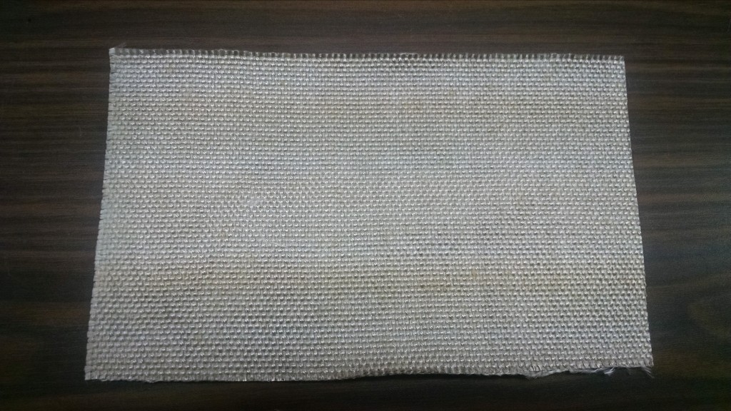

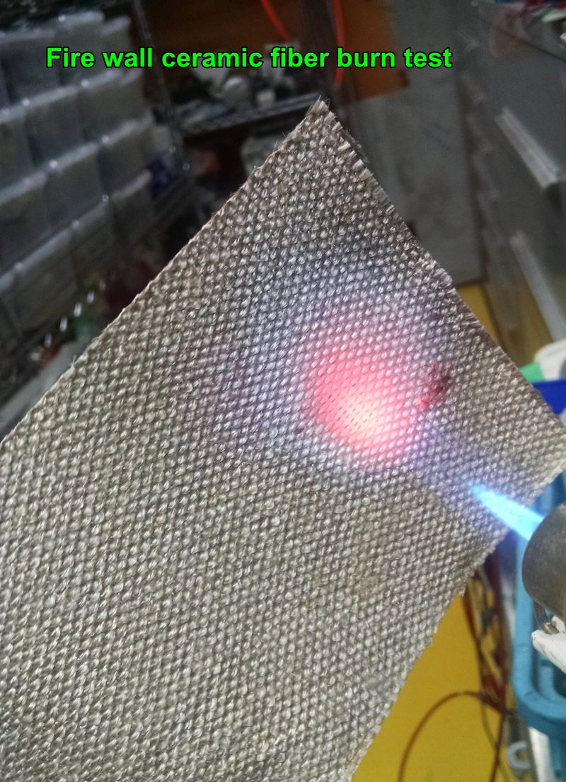

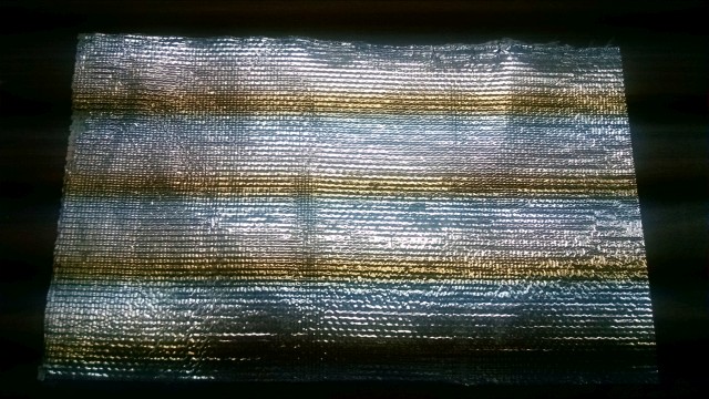

I used a similar product that was made by another manufacturer. I tested it with a propane torch and the ceramic textile fiber remains intact well after the foil has melted. I used it on the firewall to minimize heat transmission. One photo looks strange- it is the reflection of an overhead fluorescent light fixture.
