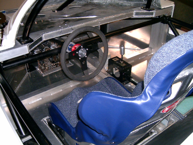

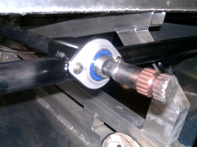

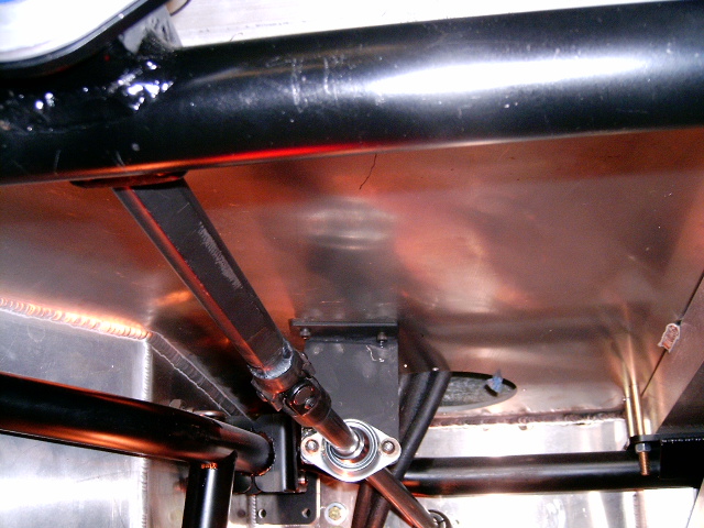

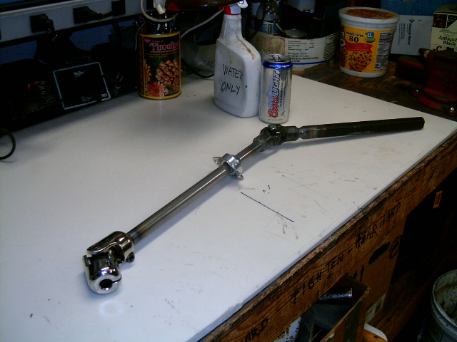

here's mine if you need ideas

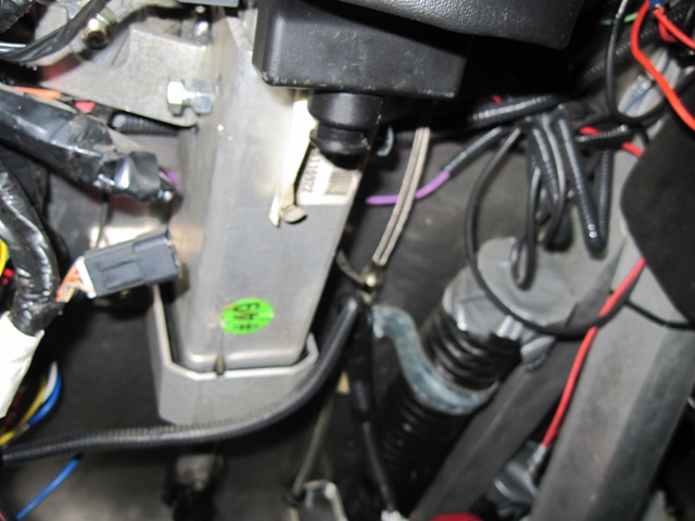

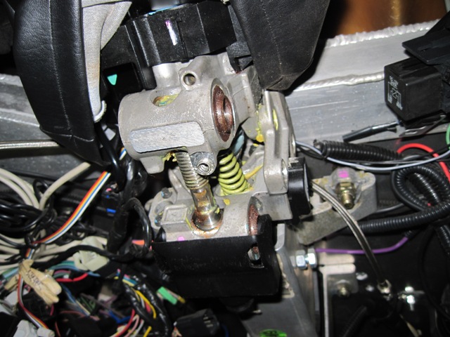

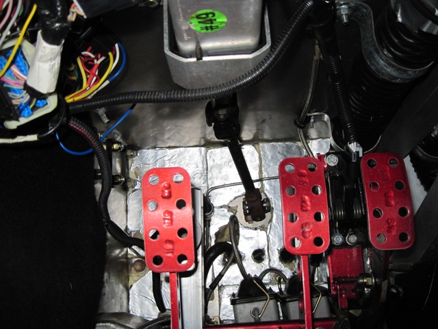

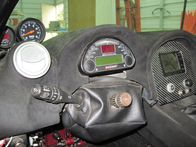

I had to modify my steering column to raise it up. It was hitting my legs and therefore had to strip the electric motor and other stuff off to raise it up. I have included some pictures,I had to drill and tap the column housing to set the column the right distance from me, which I have a picture of that also. Hope this helps. My column from the floor to the bottom of the wheel is 13 3/4 ".
