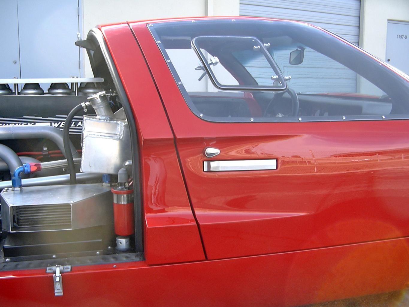

We have been working on some locking options for the SPF GT40.
One is the original type Rover door locks with keys, the other is a remote electric lock setup with a mechanical backup systen (for when tyhe battery is dead). On both the door handles are reinforced inside the door so that a really hard pull with the doors locked will not open the doors nor crack the fiberglass.
Both systems are under development and are off in the semi distant future as GT40 accesories do not sell well and it takes some time to recover the tooling/design investment.
Rover door locks.
Rick Muck- Mark IV
GT40s Sponsor
Rick -- what year/model Rover did these locks come from, and how much of the lock mechanism needs to be retrieved? Are you using just the lockset, or more of the rods, etc., than that?
I am not sure of what Rover the are originally from, perhaps the Rover "Granny"? I can gert them via a restoration supplier.
We would use only the lock itself, all other parts would be unique fabrications to work with the SPF parts. I expect aall of the rods and other pieces to be done in stainless for corrosion protection (no, they won't rusat away in these cars but I HATE rust stains running out the door and down the rockers, etc.)
