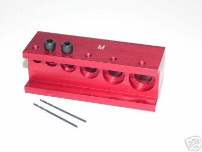

yeah, I got the boxes of bolts and decided to order some extra drill bits, no chance I'll be able to drill them with the 2 supplied with the Jig I have I see a lot of broken bits due to being an overly monotonous task.

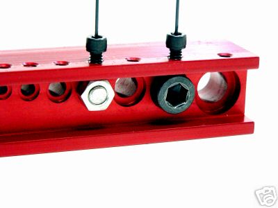

For starters broke 2 drill bits in the jig. Then realized the jig is not for metric, so a FAIL (Bolt not super secure and must have moved). I have 12 Cobalt bits coming, and that should get 6 bolts done at my rate of bit destruction:furious:.

Couple of questions did you use one of the red aluminum Jigs with the allen bolt with a small hole, or what did you use for good results? Also drill speed Fast/Slow for best work? Oil?
And last one how did you deburr the inside of the socket head?
And your right a pain and all I did was 5/6th of a bolt.

I drilled them free hand. I did use motor oil to keep the bit cool. I did run the drill slow. I got 6 bolts done with one broken drill. I did not do anything to deburr it.
I am no expert though. This is the first time I wired any bolts.

My complicated Drilling Jig may be too advanced for the task! Well the 12 drill bits came in and I'm going to restart the process, and your right will take a long time to get things done.

Yes it is slow going to drill the safety wire holds. Got 3 bolts done so far and no broken bits, but it is a pain in the a$$ to do. Going to take a while. After getting the Metric sized jig things worked much better, so far no broken bits and those were the ones that came with it which I'm sure are not of the highest quality. I have a back up supply of the 12 cobalt bits after I break the 2 the came with...

On the good side I put Talledega Nights on in the Garage TV, and stood in front of the drill press and drilled out 30 more bolts (6 holes each). Only broke a couple more bits before I figured out the process and hot to make it work better then the 1 drill per bolt ;) One thing was odd when I did use a drop of oil it was almost dooms day for the bit. Seems to like it dry to get the chips out of the hollow guide bolt.
