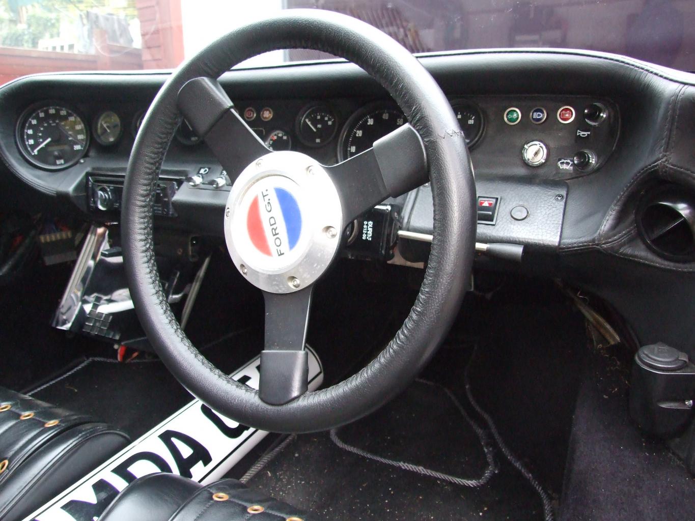

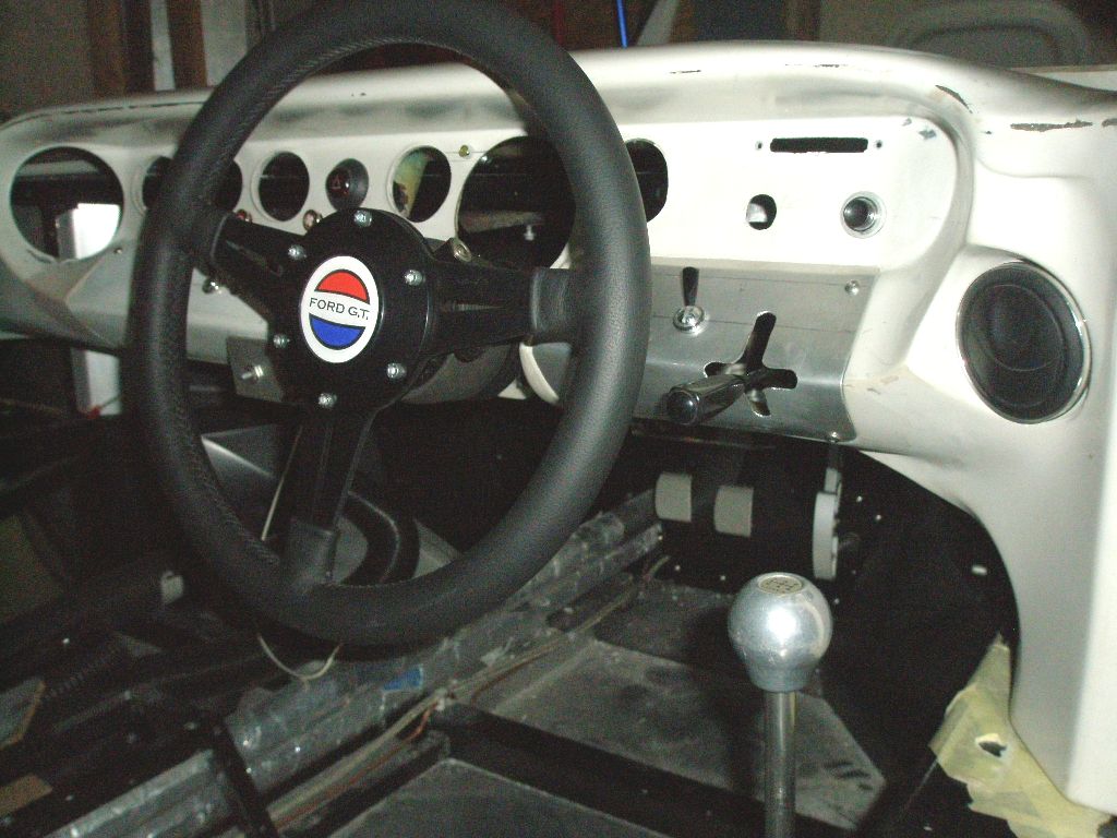

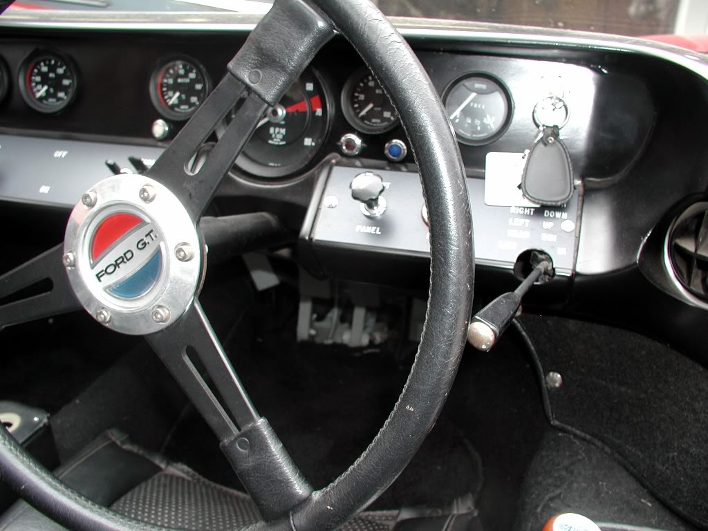

Hi Kieth,
I’d looked at moutning the indicator switch off the steering column, but I found it pushed out the wheel too far. Some of the original road cars used a Lucas indicator/light/horn switch mounted on the dash, which I copied. This works really well, indicators are still up/down and you still pull to get flash beam

I have to say that pic looks like a gearlever with all the cut outs, a bit in you face.
Phil I like the sound of your headlamp flash built in,these cars are a bit clumsey in those areas if you like the period look.
Jim

Hi Kieth,
Andy
Andy

That one with the Black dashboard is defenatly a mini knob on the stalk in the 40 in the pictures. I had that in an earlier kitcar which had a mini column.
The white dashboard one looks remarkably the same as the stalk in my brothers 1972 ford transit camper van (originaly a 1700cc flatbed transit)
the end is metal on the mini one, and Black on the transit one.
In both albeit the differente in orientation, pushing (in the mini & transit) is Horn and up/down is flash/highbeam. L/R is of course L/R. All Can be done at the Same time.
I don't get hoever why it's not column mounted, that way you can have the selfcanceling function aswell. Saying the 40 is not ment to have one makes no sense, as a racing car it wasn't ment to be on the road either....
Grtz thomas

It is a Mini Indicator (Lucas) stalk I’ve used. I couldn’t fit it to the steering column due to the collapsible section I have in my steering wheel boss
Andy

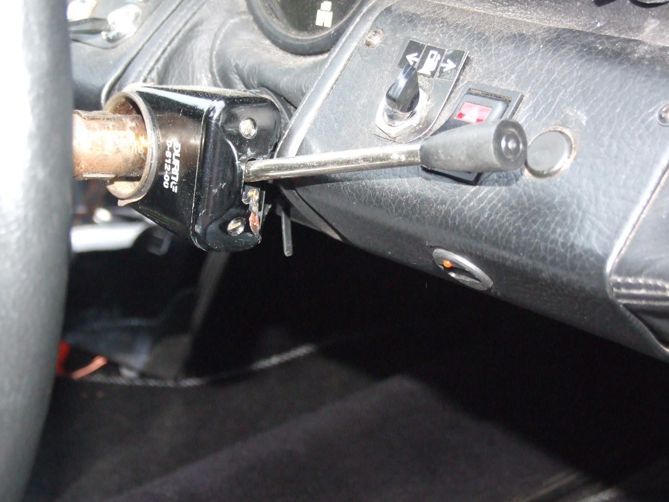

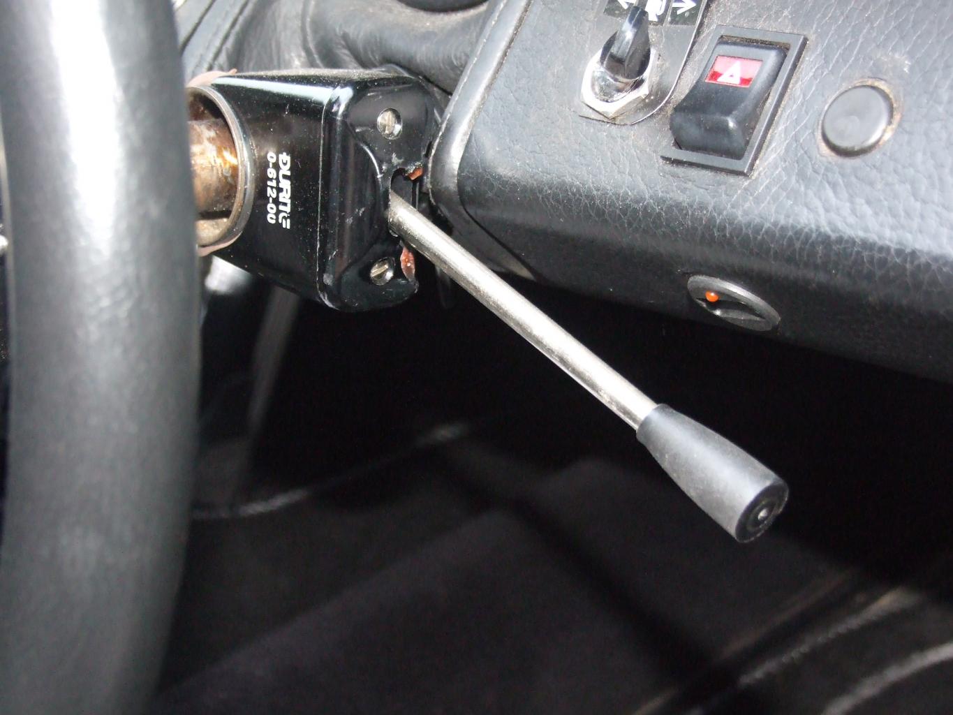

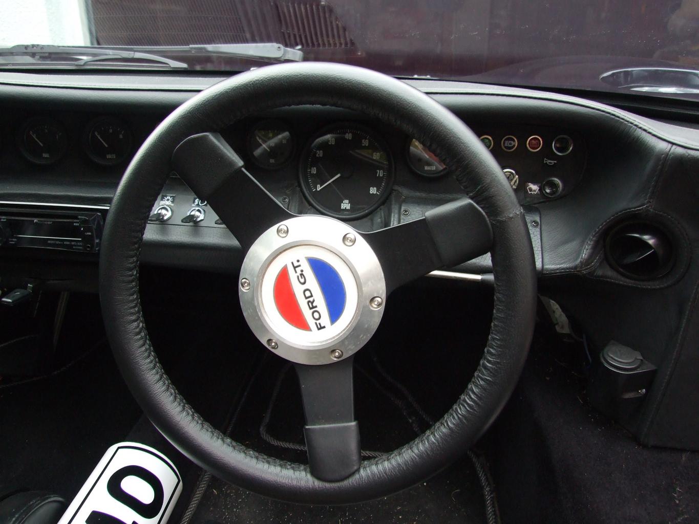

Keith, I adapted mine from toggle switch on the dash to a stalk on the steering column by using an off the shelf brand new item from Car Builder Solutions. This does not self cancel but is neat and works well. Sorry no photos as yet but look at the CBS website to find the item. I was lucky in that I could handle the item before buying at a car show where they had a stand selling their wares. The mount to the steering column is like a jubilee clip so tightens round it by screw action.

Keith, sorry it took so long, but here are the photos now. the set up works well in my car.
Chis

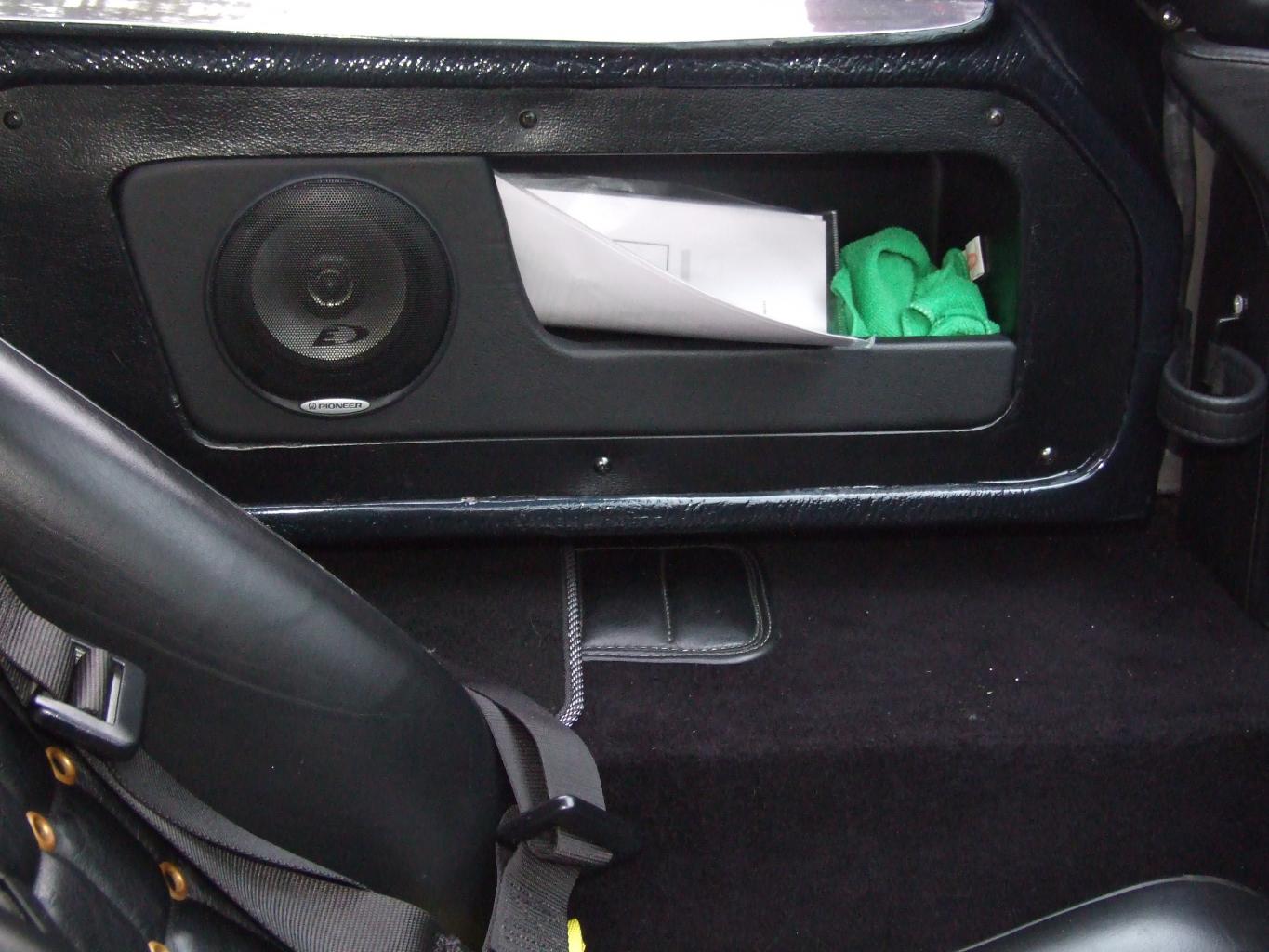

No that's an immobiliser port for connection by a "wand". the stereo does have a USB and an SD card port in it and the big shiny thing in the passenger footwell is a 600W amp driven from the auxilliary output of the head unit. Yes I can get it loud enough to be heard at any speed, but for some reason the wife complains when I do! I run it from an 8Gb SD card with all my favourite music on random so I never know what I'm getting next. The speakers in the doors are Pioneer and plenty powerful enough to take the strain, see the photo for the door card set up.
