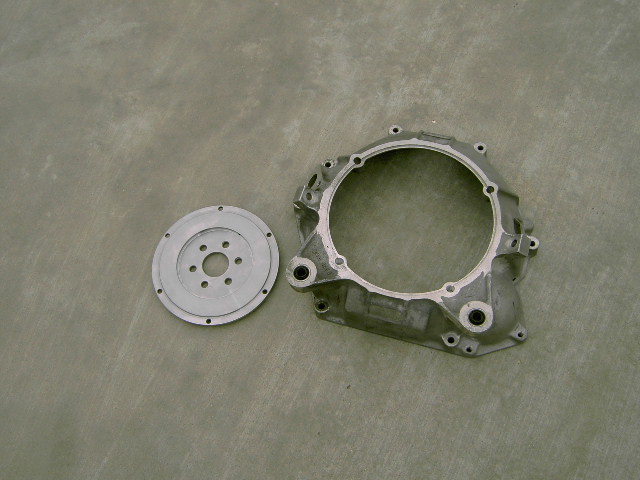

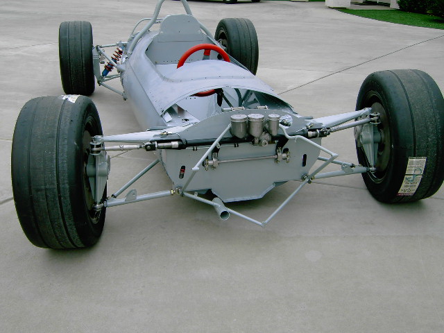

I rebuilt the hubs and suspension, calipers and M/cyls were overhauled with stainless pistons and bores, I have a 5 speed-0 ZF/ with external starter being rebuilt, just found the ZF bellhousing and a new flywheel for the engine.
A Quarter Master, "Master Hub" clutch is what is recommended and when the gearbox is done I will take the engine and trans to them.

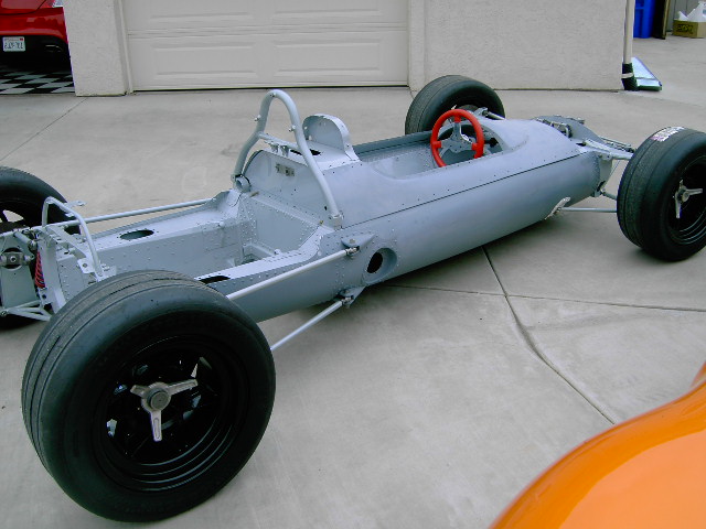

Tub was stripped, floor was changed out, primed and sealed, wheels powder coated and new Hoosiers, This car has 16 ", 5 pin wheels and I cannot find 12.50 and 10.50 vintage Indy tires.

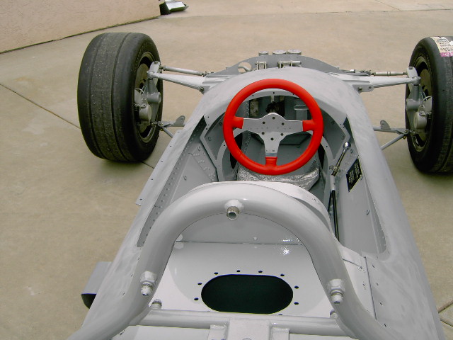

Lots of other stuff, new hard lines, new vintage Girling Brake hoses, lots of rod ends and hardware of all sorts, and of course a new, red leather, Lotus steering wheel, I exercised a little artistic license here, these cars had black wheels (an oversight, I am sure!).

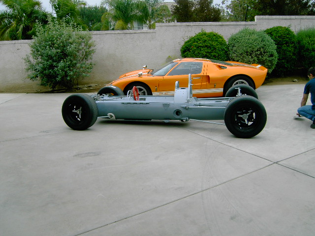

Last night we got the car back on it's wheels and my depression is gone!

The next big step are the fuel cells, I have the old ones and some spares and am trying to figure out the best way to get replacements made.
Lots more but here is what it looks like now, once the fuel cells are finished I will rivet the top back on and have it painted.
