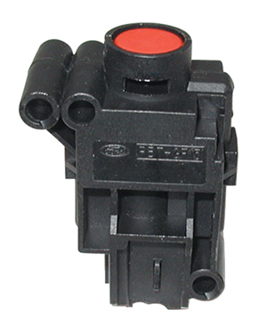

Has any one used an inertia switch to cut off fuel pumps. I have a Ford style switch, seems straight forward, just two wires. But some guys on the net say they are troublesome and unreliable. Any thoughts ? Fran, if used, where would you place it ?

I installed one. Keep it next to the drivers seat for a quick reset if needed. I bought the version that was used by various manufactures such as Porsche and GM. It will be moved to the side of the handbrake cover and not the front as shown in the picture. This style is just a ball sitting in a cup. When the ball gets displaced the current flowing from one half of the cup to the other half is interrupted. I installed it on the low current "ground side" of the fuel pump relay.

They work in rollovers as well. Here is the one I use like the one above in Ken's post.
