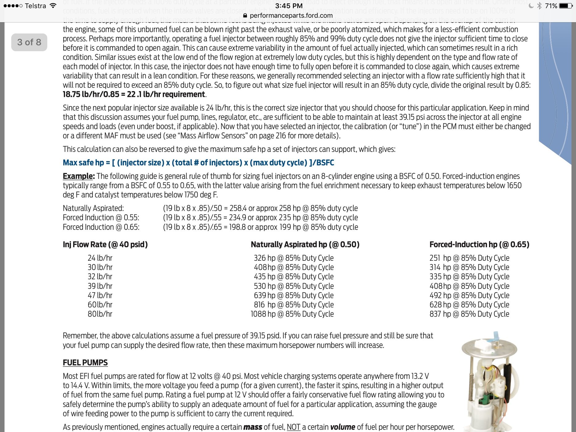

Looks like 39lb should be good to 530hp 34lb Max’s out a 435hp
Thanks again
