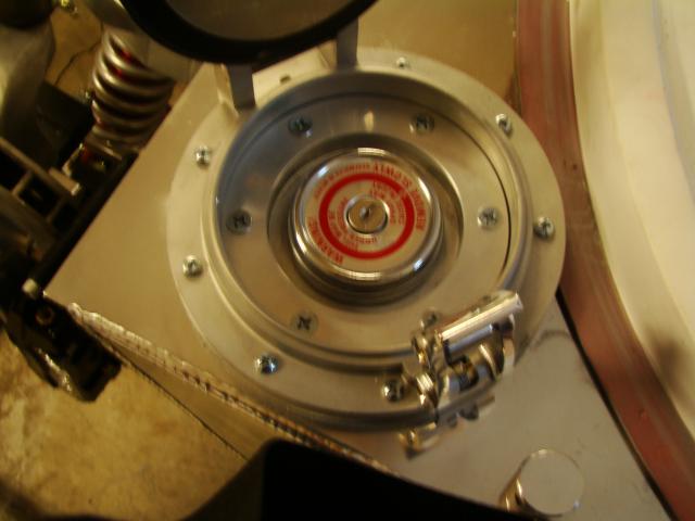

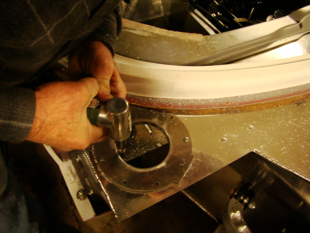

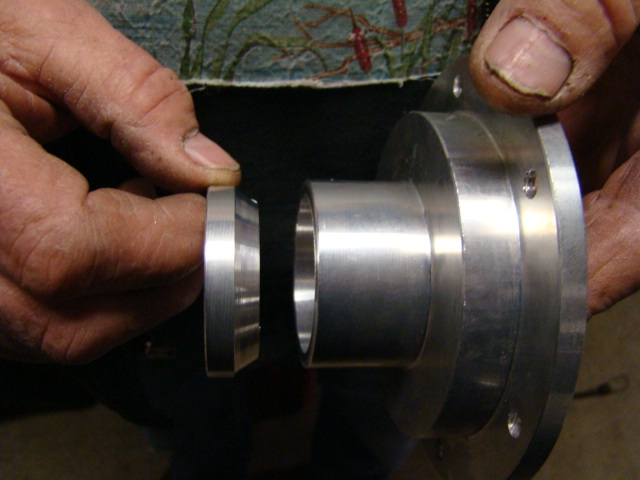

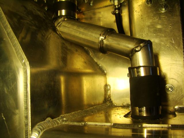

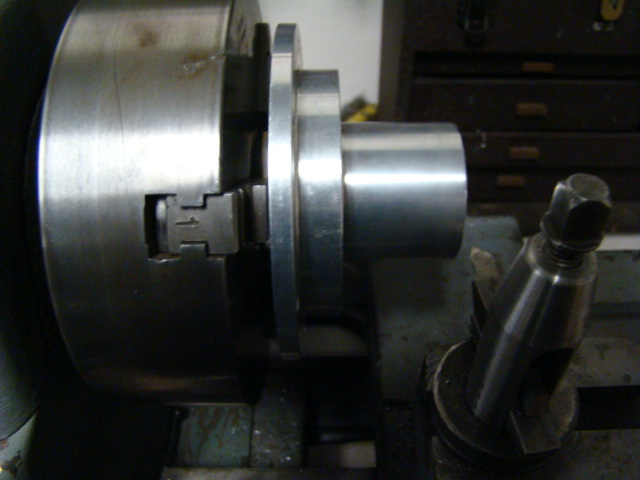

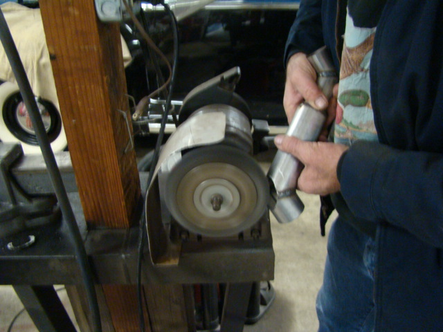

These are a few pictures of what Dale and I have been doing to get some of the plumbing done. Making the angle from the gas cap to the tank was a bit challenging, but with a little help from a muffler shop and some good welding we were able to get it finished. Like most of you who have installed a solid fill tube we had to put a flat spot in order to make it fit the body correctly, as you can see.
