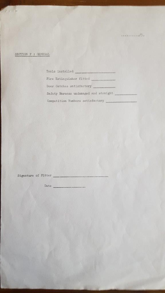

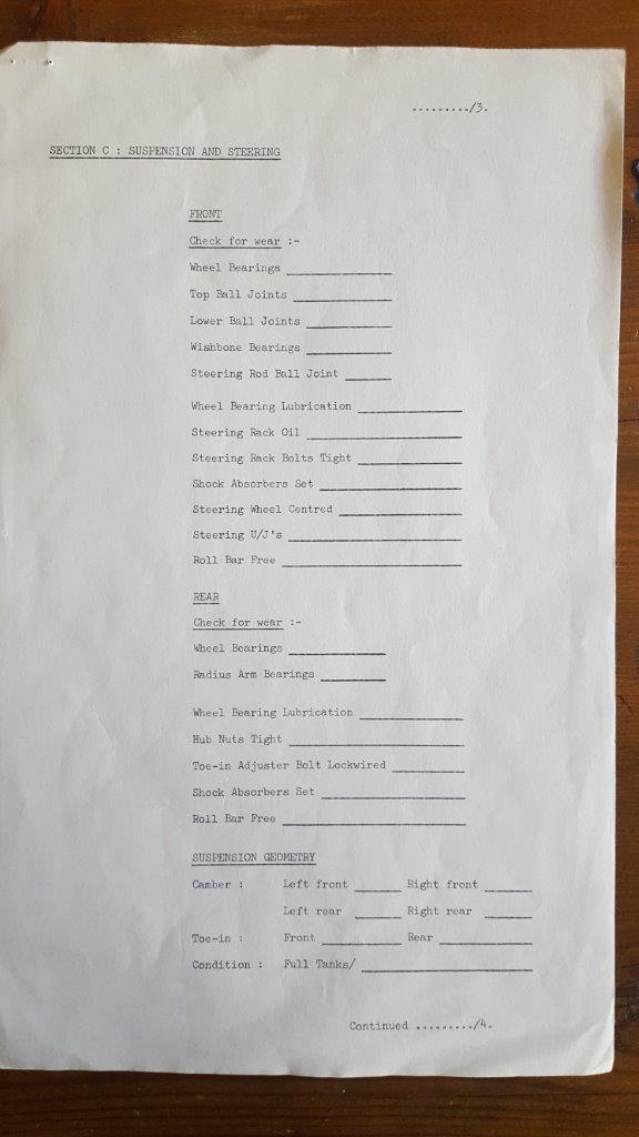

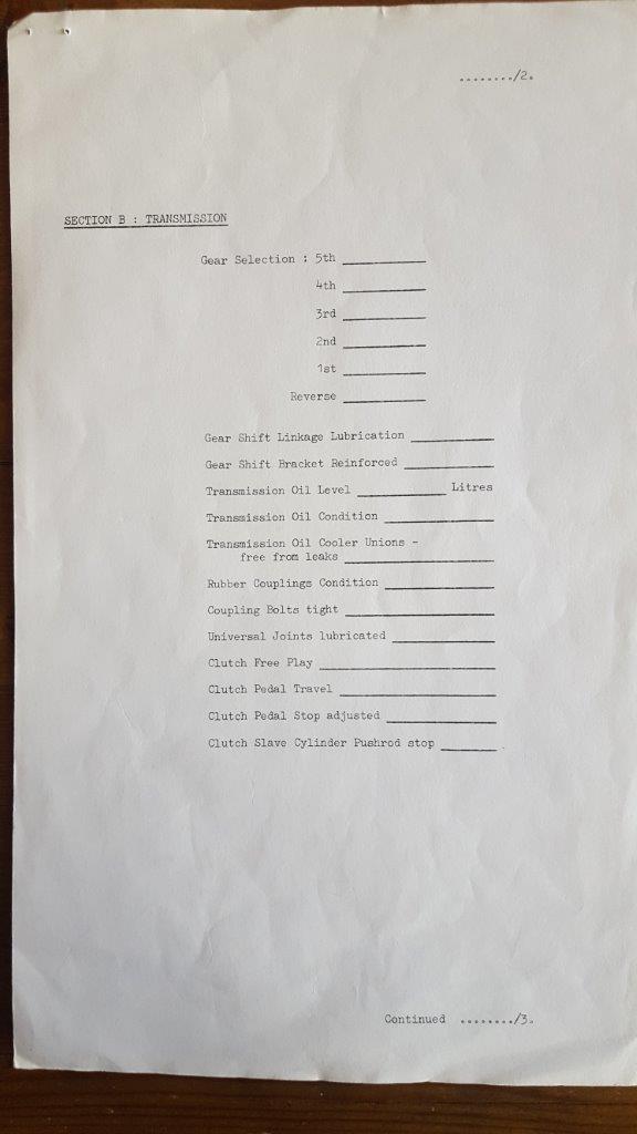

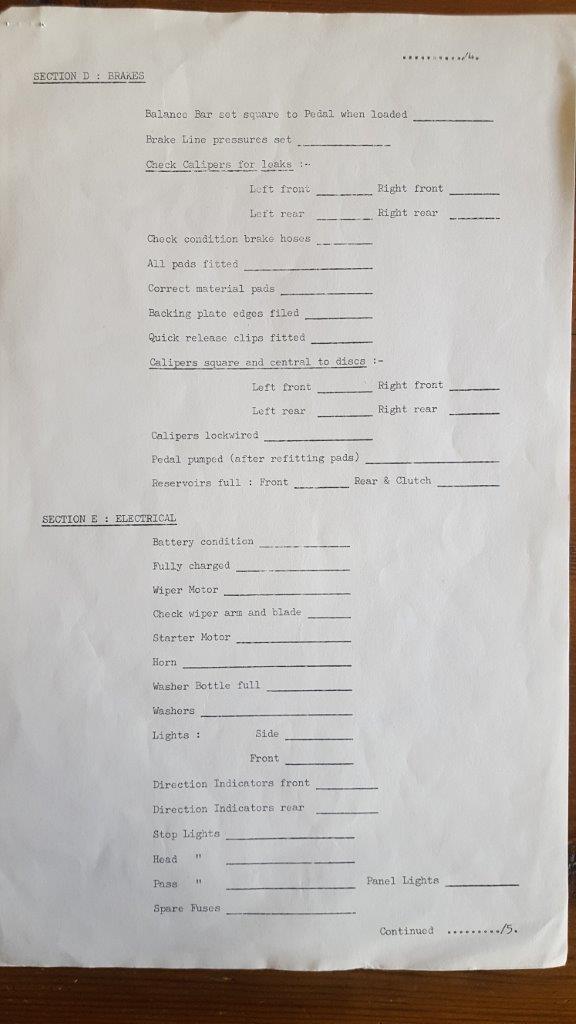

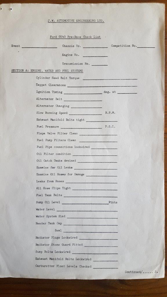

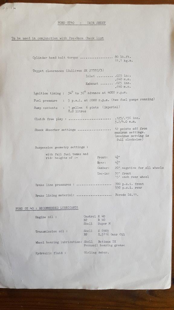

A friend of mine saw this at an auction and very kindly thought of me. I think it gives a remarkable insight into the lengths that JWE went to to prepare to win.
I thought you chaps might like to see them too.

When I was doing my apprenticeship a long long time ago i remember the saying (a tappy tappet is a happy tappet) seriously though, maybe after 24 hours they may mushroom or pound into the head a little.

I love the "tools installed" tick box!
So do I assume they carried a tool roll to fix it out on the circuit?
