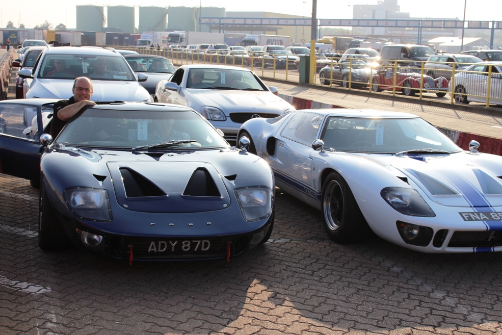

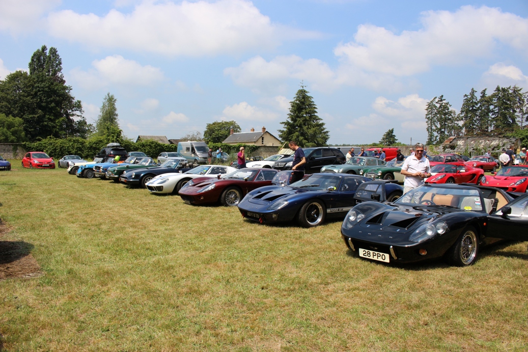

We travelled down via the Portsmouth to Caen ferry on the Thursday. After a push-rod change on Tony’s freshly finished red Mk3 (there seems to be a quality issue with soft push-rods from Comp-Cams as we changed one just before we left; fortunately took spares) we got all the car’s to the Pistonsheads gathering at Chateau Le Sarthe on the Friday morning and to the circuit in the afternoon.

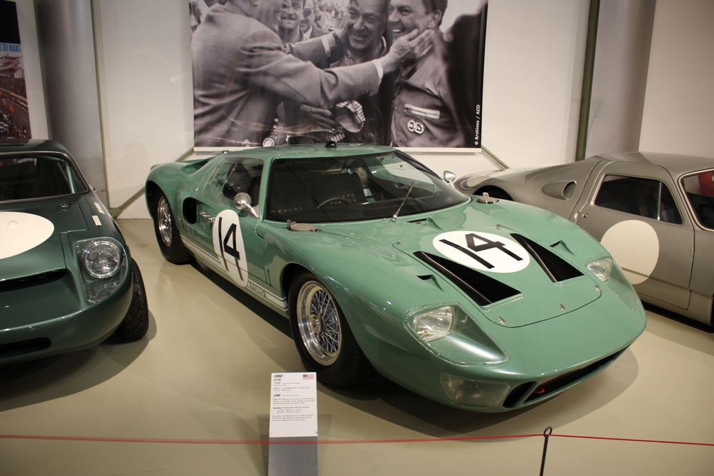

The racing, the cars and the general ambience takes some beating, and on the Sunday after visiting the museum, which was very impressive, especially with special Gulf exhibition on, we joined the club gathering at Hotel le France for an excellent meal and a talk by one of the original 60’s team members
