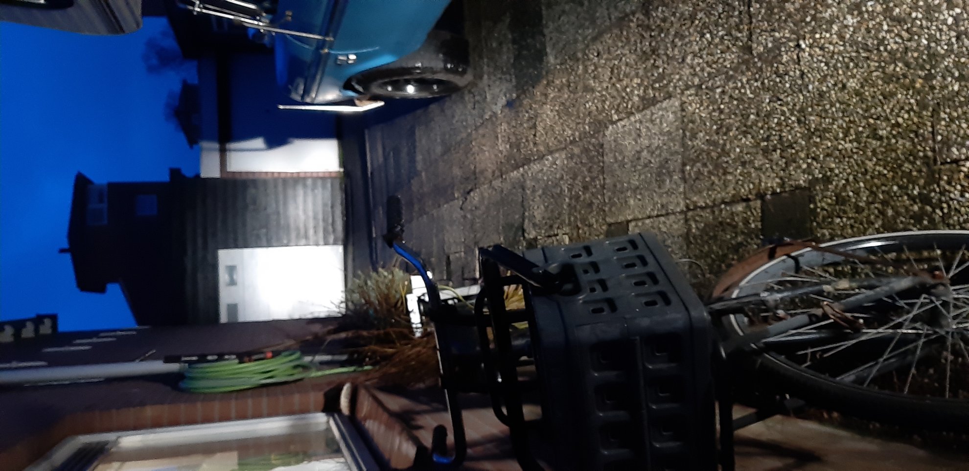

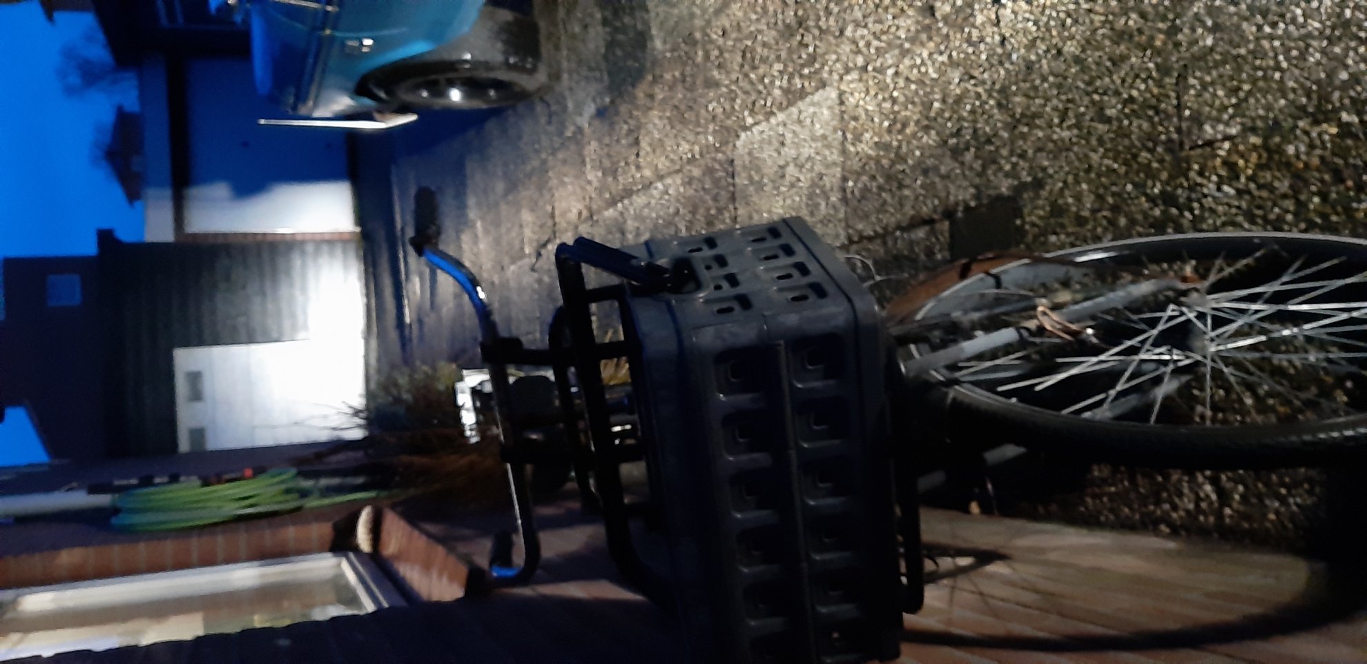

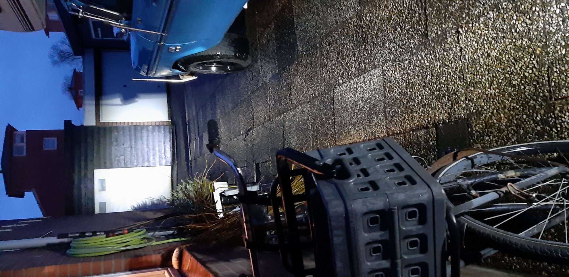

I did some testing with my lower spotlamps (FoMoCo).
Test one, H1, standard 55W Halogen bulb
Test two, H1 Rally 100 Watt Halogen bulb,
Test three, H1 LED replacement bulb, (advertised as H1 6500K WHITE COB LED 36W 8000LM)
I went for 55/60 Watt H4 bulbs in the headlamps and 100 Watt H1 bulbs in the lower spotlamps. All switched through relays so all power goes to the lamps. (direct 12 Volts to the relays & relays got switched by the switches. No loss in power to the lamps = more light).
