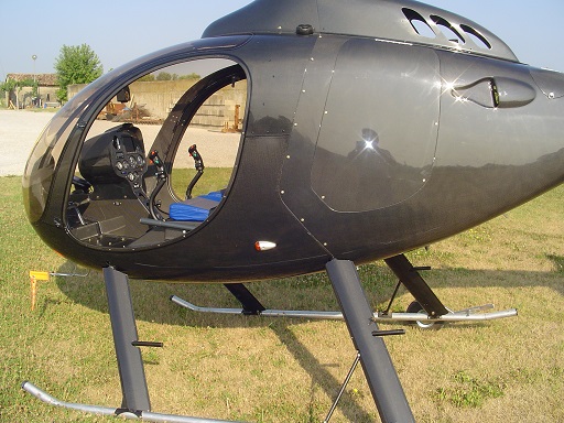

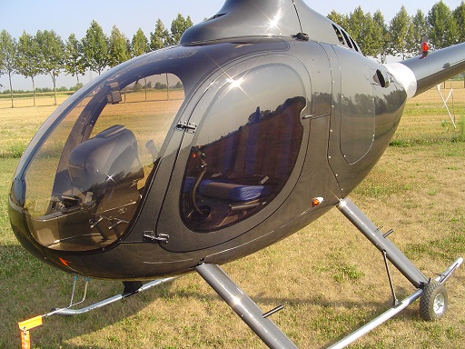

Pagany's cars uses the latest tecnology of carbon fiber molding for body panels which is to use prepeg epoxy carbon stuff layed in fully carbon prepeg mold and some for small parts in aluminium polished molds.
they are using for the first lay aspecific prepeg woven carbon clothes that is allready mixed with more than 100/100 resin ( normal CF is impregnated with 75to80/100 resin ratio) ;
This gives to the part when unmolded a rather excellent finich (depending of glossy of the mold in which the part have be laminated ; then all parts are carefully hand sanded and clear coated 3 times with asort of satin / gloss Polyuréthane 2 parts stuff
They where enought kind visiting them to explain this process as I wanted ( years ago !!) doing some similar process to my little chopper ( italian buid kit)
