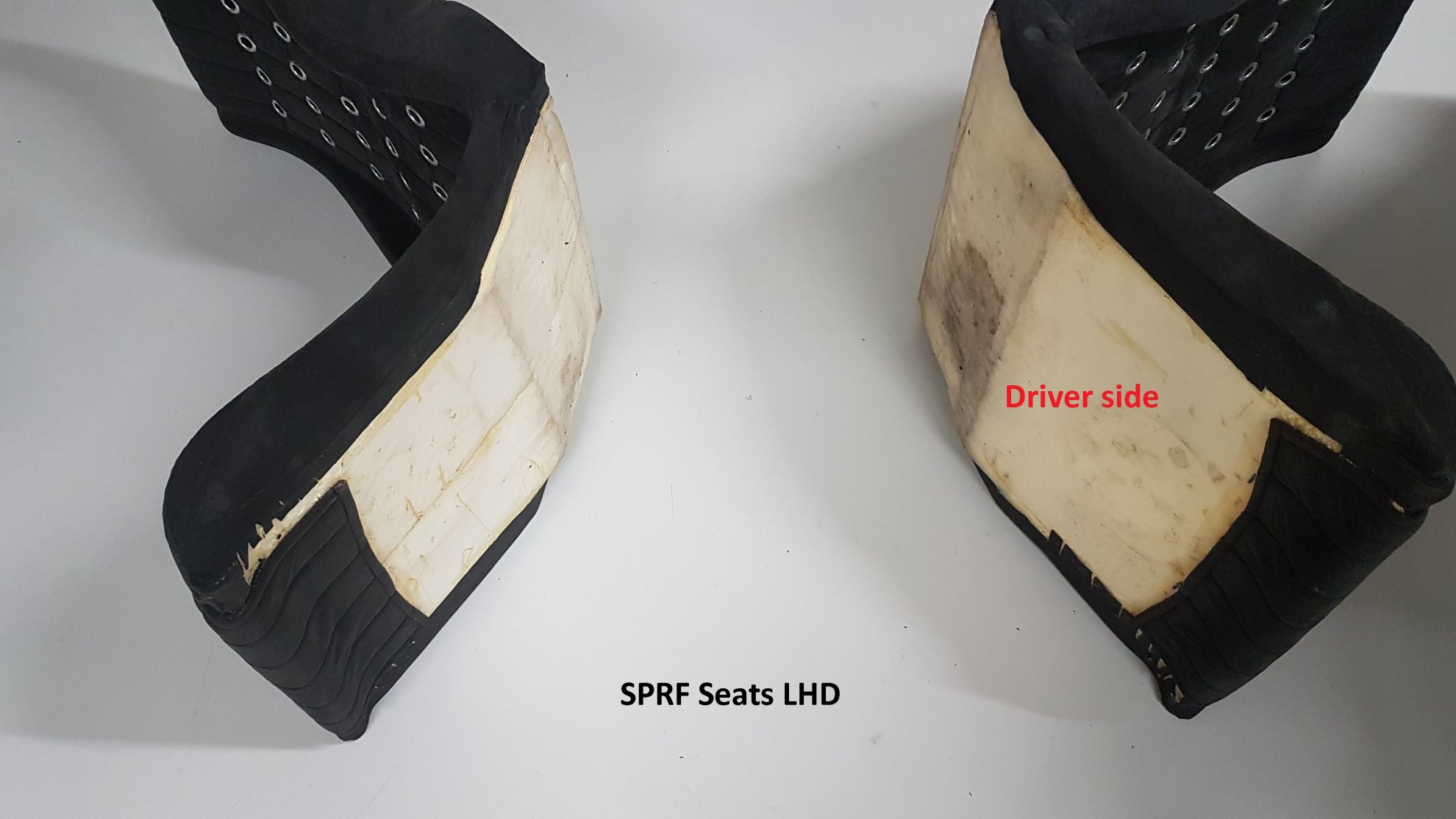

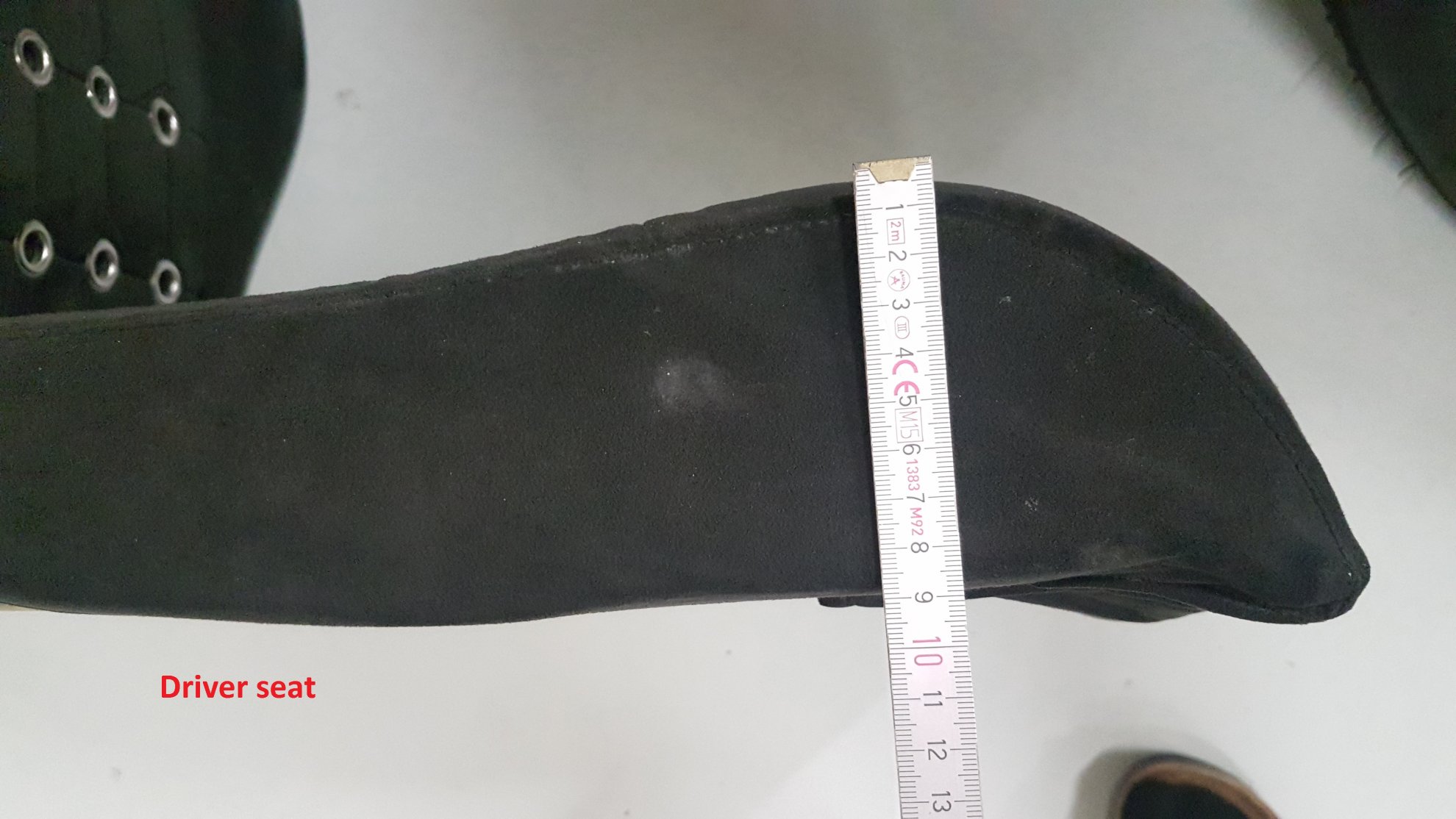

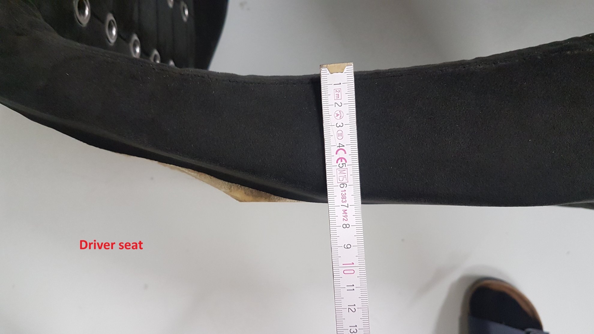

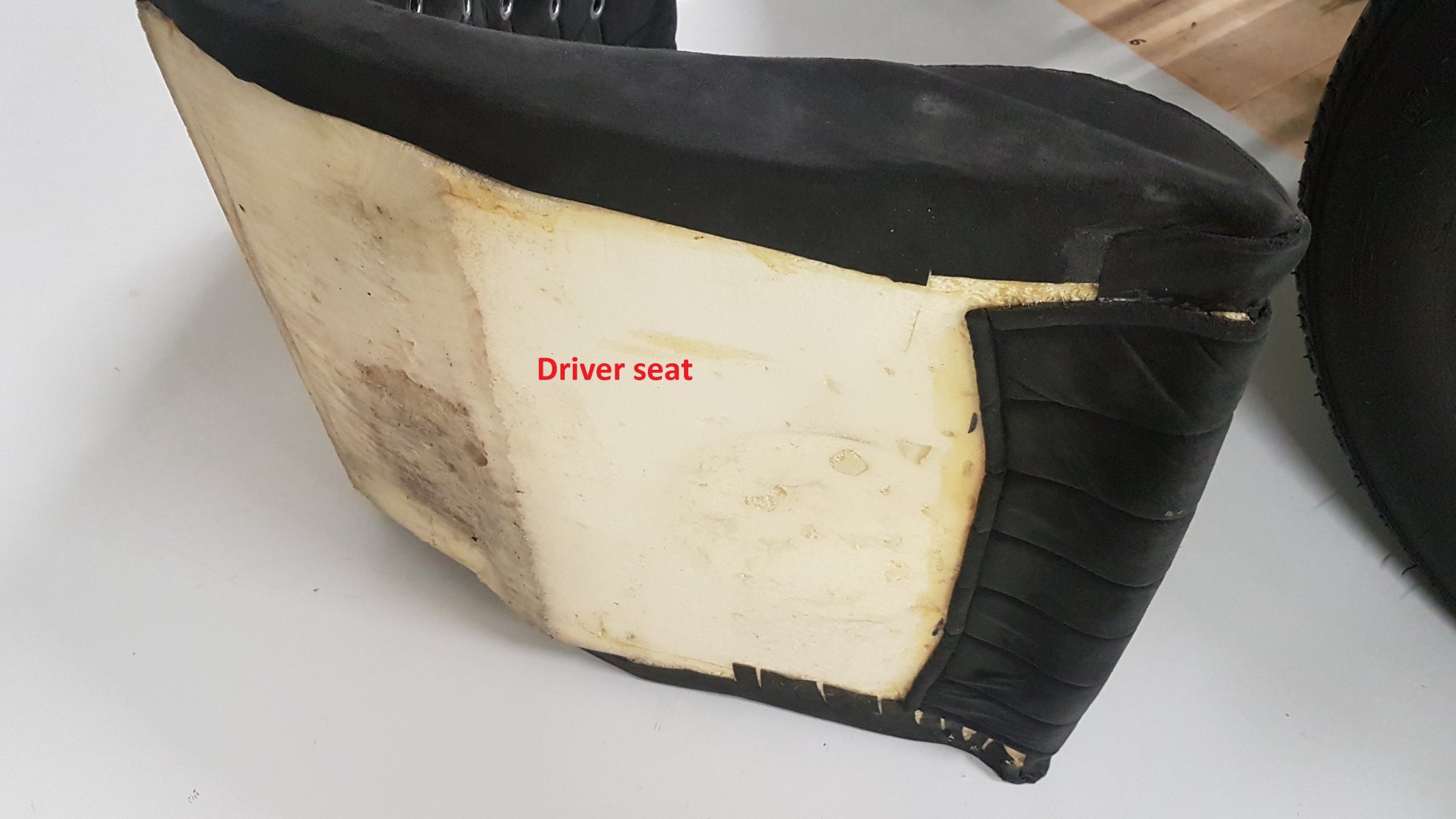

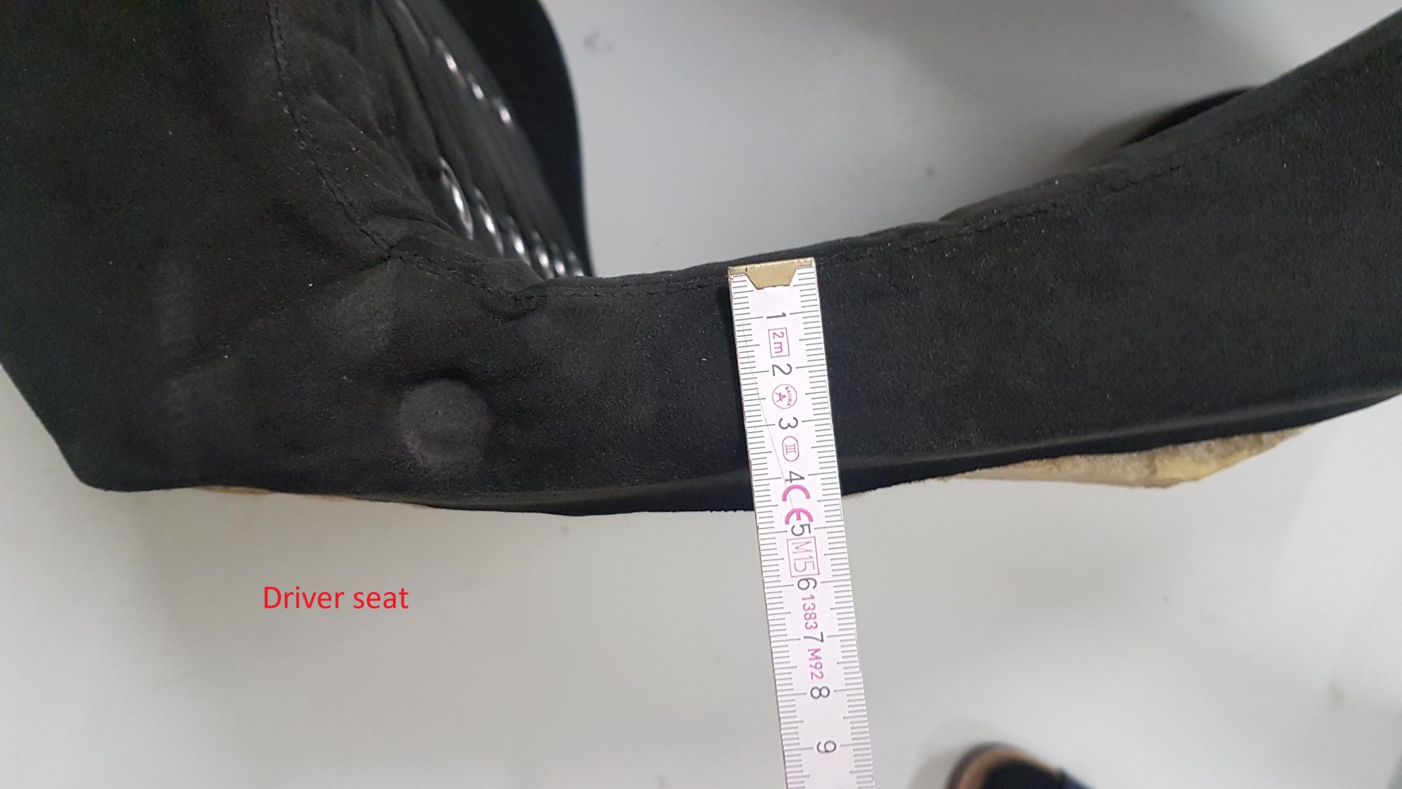

I will take pics from my seat - cutting away from the seat might not be ideal but much easier than lowering the seat pan - depending on how much "clearance" you need.
I am sort of ok right now but an inch or so more would be nice. Also to get my knees some more under the dash.
Markus
SPRF40
Here some pics as reference - my seats have been trimmed, but I can't say/remember by how much.....
20230505_203103.jpg20230505_203117.jpg20230505_203140.jpg20230505_203147.jpg20230505_203153.jpg
Markus
SPRF40
Yes, indeed, and what you could do is insert a section of harder foam after you have cut out what you need to fine tune the new height and avoid sinking onto the floor.
