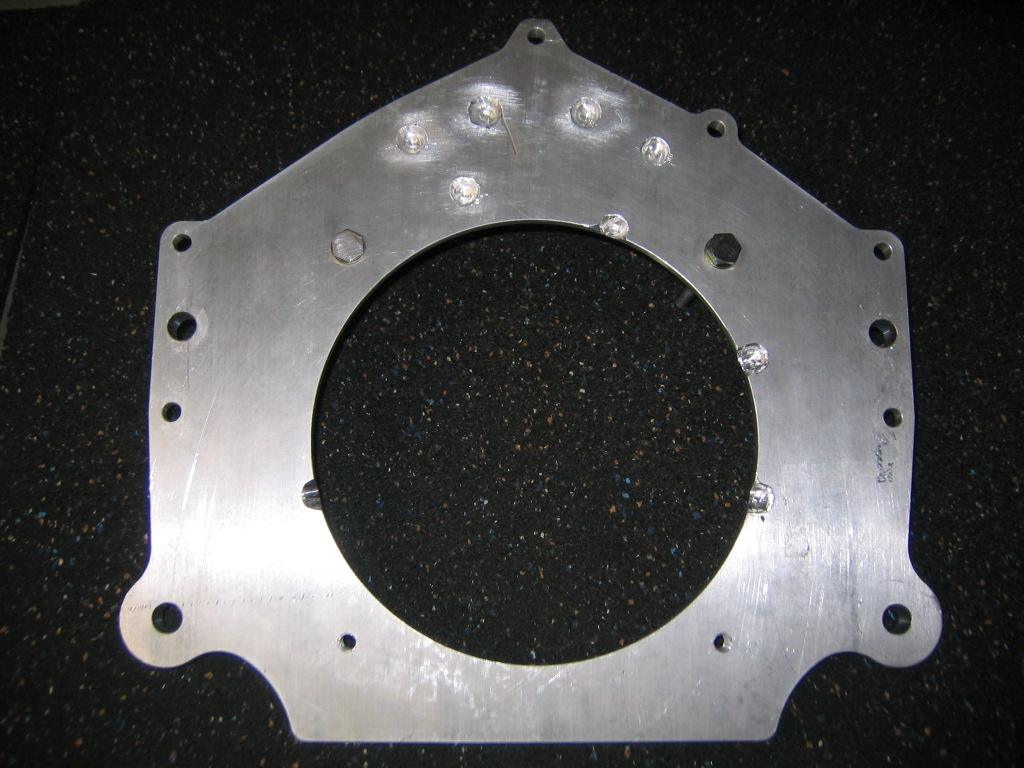

I don't know what your trans adapter looks like but if it looks anything like the G50 adapter you're going to want to do 1 of 2 things. a) get an LS-2+ rear main seal plate or b)clearance the back of the adapter to clear those bolts. I went with option b it was less painful. The LS-2 up plates counter sink those bolts a bit so it's not an issue.
