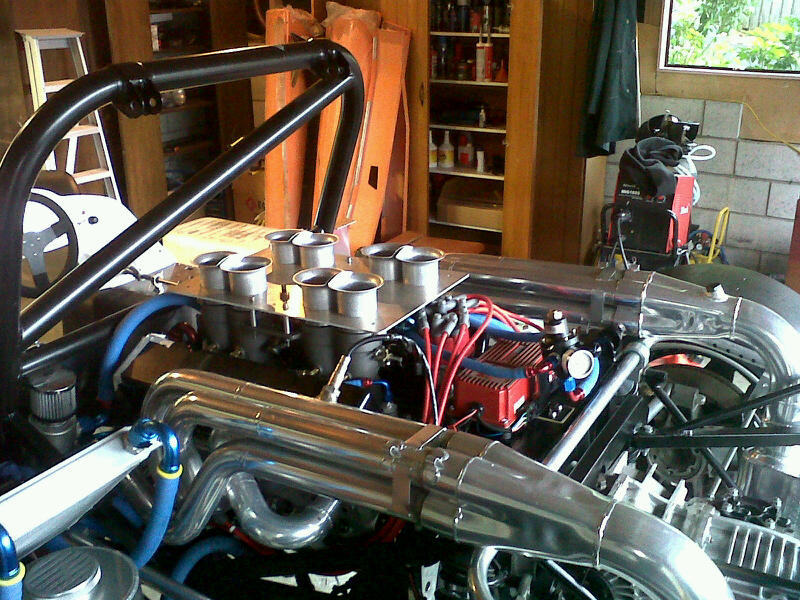

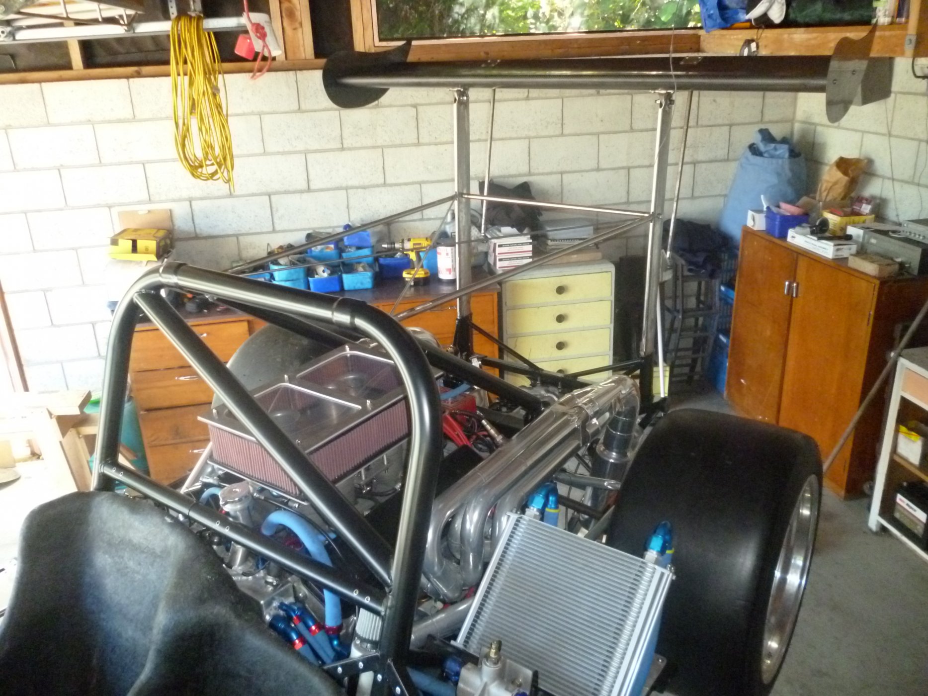

Hi Markus,
I have a 5mm aluminium base-plate located by a pair of long bolts with crush tubes on each side of the hilborn manifold. The base was waterjet cut so that the stacks would go neatly through it and into the hilborn clamps. Under the baseplate there are also sleeve/spacer tubes and o-rings that each stack slips through, so in total the baseplate is sitting on 8 sleeves pulled just tight by the 4 bolts you can see in photo one.
From there it gets a K&N filter with a poly-carb lid and aluminium frame held firmly onto the baseplate by 6 threaded rods with crush tubes as per second photo. I have subsequently replaced the lid with one containing a large rectangular K&N panel filter. This lowered my IATs and flowed a bit better. I was tight up against the roll bar and might have used one of the off-the-shelf sprint car air boxes if I had more room.
Cheers, Andrew

Thanks Andrew,
That helps - currently I have individual K&N's on each trumpet.
I'm thinking of redoing the hole thing....
Markus
