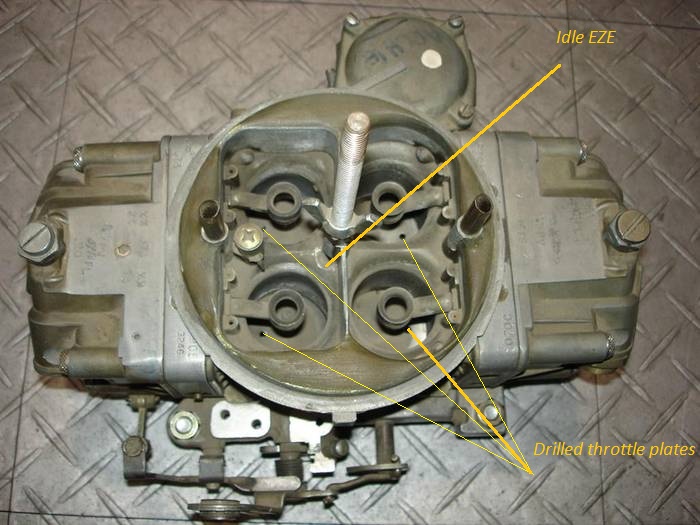

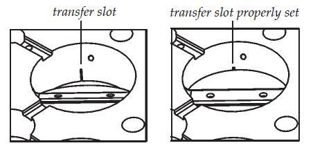

Rob, If you have closed the primary throttle blades completely that is the reason your not getting any response from the idle screw adjustment, attached pic on rh side of diagram shows what to aim for. should also set the rear/secondaries in the same manner but with only a small amount of transfer slot showing there, read up on the 'idle ezi' mod for holleys and obtain or make a system for your car- you can make a 'fixed' setup by installing a jet/orifice in the cruciform of the 4 barrels in the base plate and drilling holes that allow air above the throttle blades in the main body to reach that cruciform area. You then adjust /change the size of that jet to obtain a suitable idle speed without altering the throttle blade setting. Added a second pic of an old very tricked out holley to give you some food for thought. Be aware that the air sourced from above the venturi in that carb might also have been intended to enlarge the overall flow capability- otherwise known as rule bending!:)
Also many holleys were made without idle screws in the secondary block, 3310 variants as fitted to factory Boss 302 & 302 SBC being a couple.

I thought the primary throttle blades were fully closed but looking at them from the underside I can see that instead of the transfer slot being visible as a little square below the throttle blades it was visible as a definite slot. From what I understand this means that at idle the majority of the fuel will be coming from these slots. No wonder adjusting the idle screws all the way in didn’t have any effect!
Now I’ve set up the carb as Holley suggest with the primary throttle plates adjusted so that the transfer slot appears as a square and the secondary idle set so that the secondary throttle plates just moved and then gave it one more turn.
