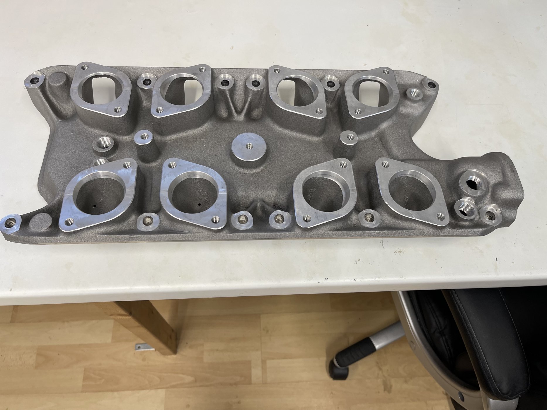

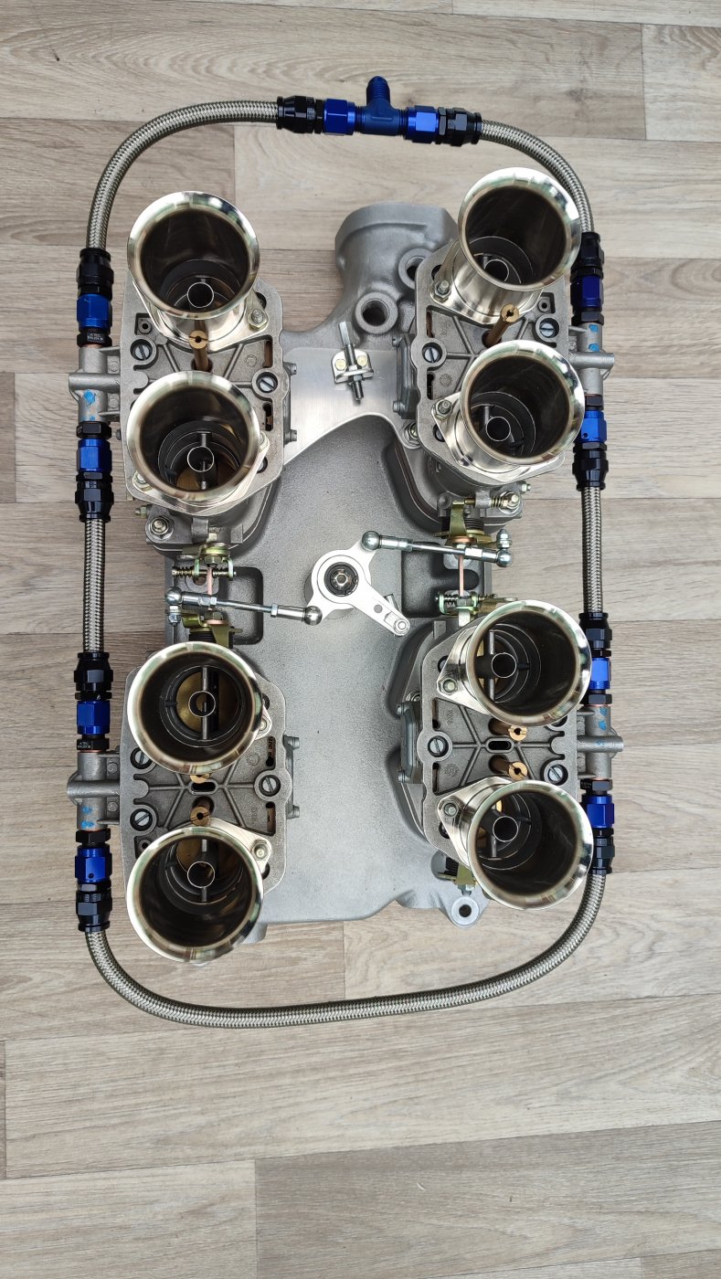

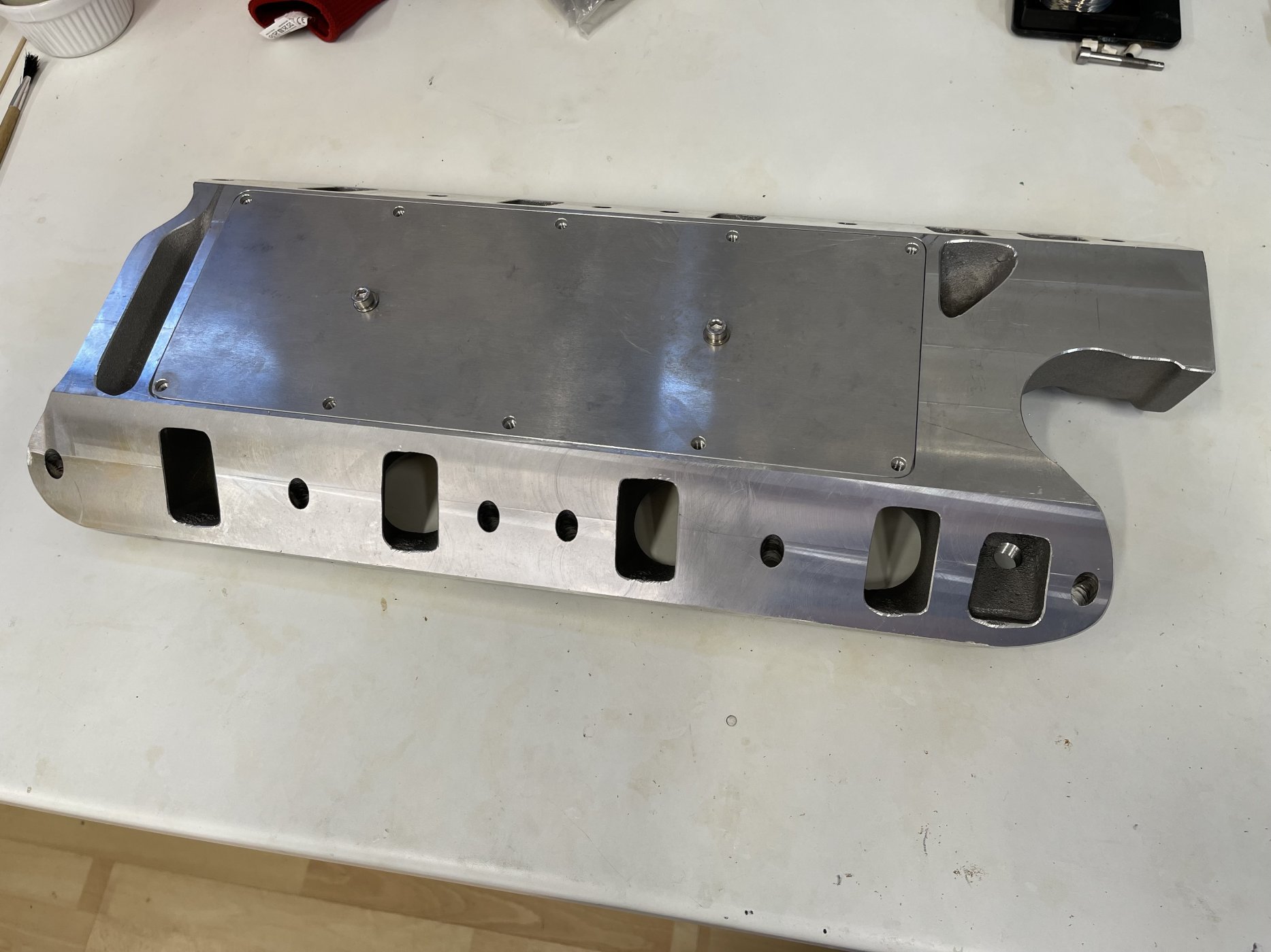

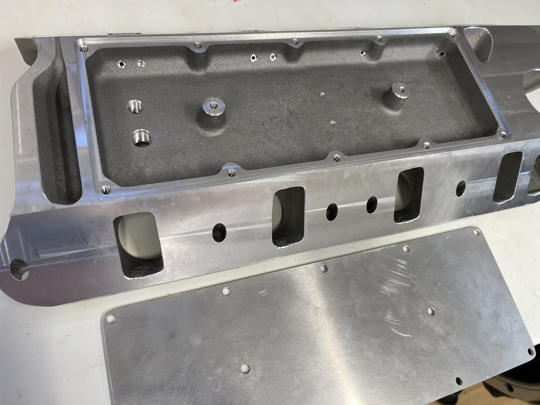

Pics attached of my new manifold complete with Vacuum chamber (For my Power assisted Brakes and vacuum assisted Distributor). Car Porn at its best !

Interesting manifold design that I’d not seen before!
Davidmgbv8
Well that is a neat manifold. I recommend you have those back bosses drilled and tapped for you to take the water to meet up front or go to the header tank.

I have had some 9mm phenolic spacers made for 44IDFs if you need some. You can get the studs, nuts, washers etc from Burton Power. I modified the 48IDA throttle linkage kit for the quad 44IDF setup. I smoothed out the sharp step in the ports using a carbide burr in a flexible drive. Checknthat the float setting is correct.
