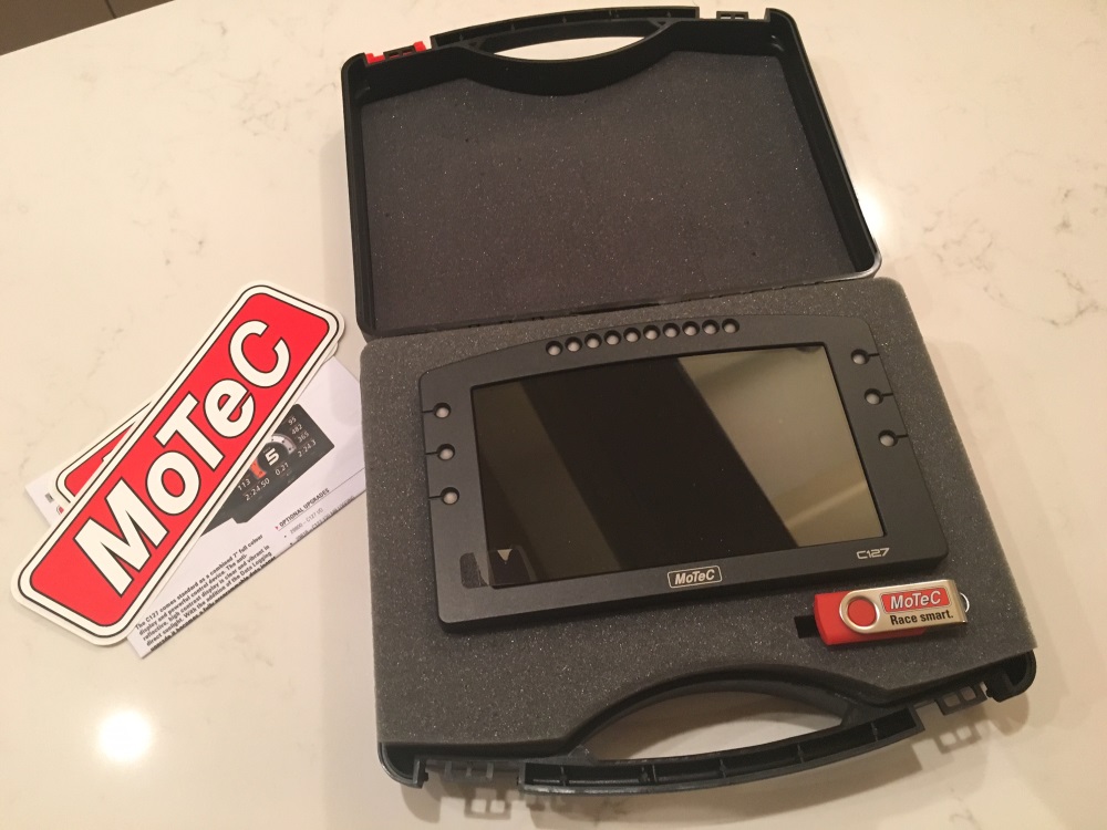

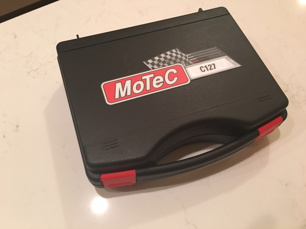

As Will indicated, I don't have the car yet so I don't have any real experience yet. However my installer is incredibly knowledgeable -- seems that's what you get when you go with someone that primarily does MoTec project -- and everything seems doable... multiple tunes, custom gauges, traction control, data logging, PWM'd fuel pumps, etc. Looks like $16-20k for complete MoTec system with custom race/mil-spec wiring harness, sensors and tune. Last week FedEx delivered the latest rev of their C127 display. Apparently I got one of the first ones with ability to accept a video feed from a backup feed. Quality seems outstanding. I’ll update as I get more hands on experience.
