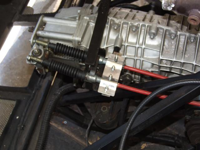

More bad news I'm afraid, while driving her the other day I lost most of the gears. turned out to be the inner gear cable outer sheath coming out of the crimp housing at the gearbox end. Fundamantal design flaw IMHO when there is only 1/2 inch of crimp onto a plastic sheathed outer, it was bound to fail:furious: After a chat with Mark Sibley the course of action seems to be to make a clamp bracket that clamps both the crimp housing and the cable at the same time thus stopping any future movement. Bought the material today and going to hit the garage tonight. really infuriating, all this bright sunshine and can't enjoy it. :sad: For all the other owners with cable change I will post a picture of the fix when I know it works.

Work all done and it seems to be better than before. I have completely reset the gear locations and can now shift between them more surely. As promised here is a photo of the double clamp I made to hold both cable sheaths in place to the housing.
