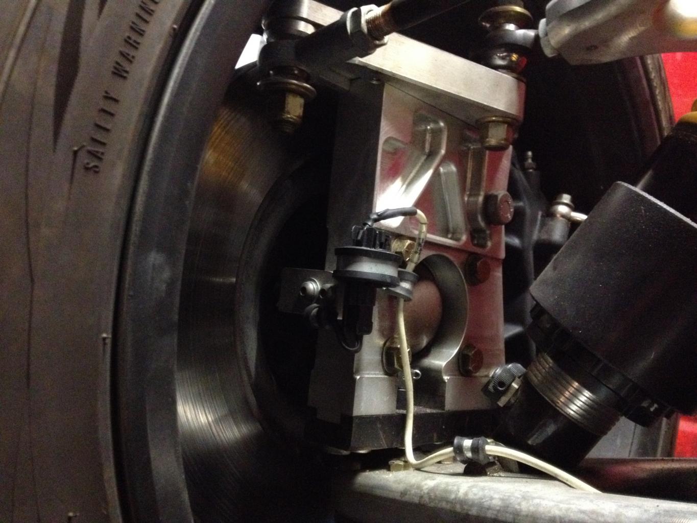

We moved the tie rod ends away from the steering arm to reduce the bump steer.
Hi Stu, I was trying to see that in the video, I am looking at the 4:13 mark on the video. If I understand correctly it appears they added a spacer under the steering arm between the arm and the tierod. Is that what they meant by moving it away?
To be honest I'm not sure how they achieved this. I have asked but haven't received a response as yet. The only comparison I have is this photo taken before any work was performed.
