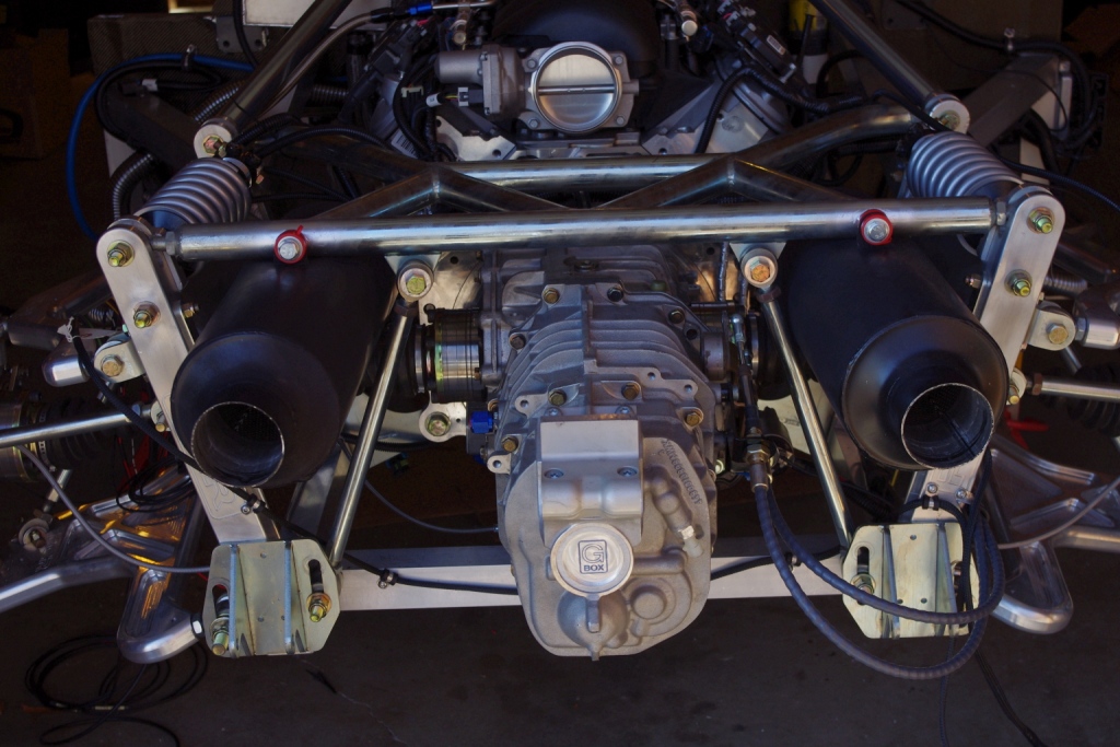

Hushpower pro-series (now owned by flowmaster). They are a tight fit but are quiet. No cats.

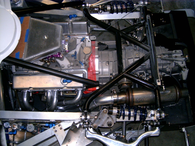

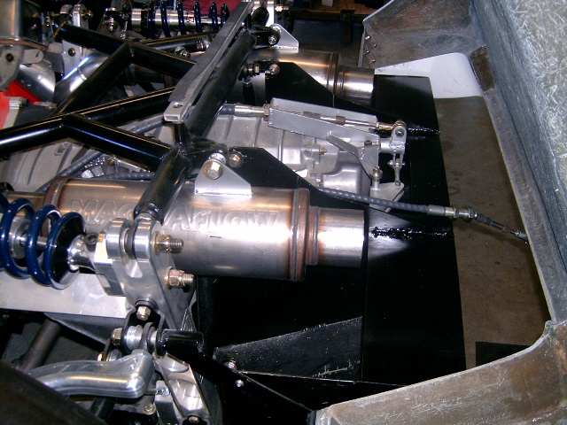

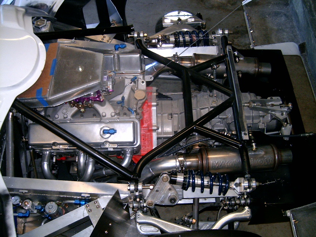

The Burns Stainless mufflers are sourced from Coast Fabrication. I have one but these things do not really quiet the car much. These are a true race muffler and don't seem to be what Ruth is looking for, not even with the bigger can.
Ruth, if sound suppression is really important to you, I would consider a nice high-flow cat in addition to whatever muffler you choose. Power loss is minimal as my friends before/after dyno charts proved to me.

Both the Hushpower Pro & HP-2 seems to have a quieter, smoother tone that the other mufflers demonstrated. A key feature of the Hushpower series is that their case is insulated so they're just warm to the touch. That means they can be mounted in tight spaces and they should reduce temps under the rear clam shell.
