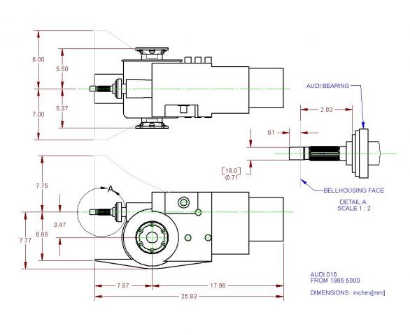

Anyone got a few minutes and a tape measure to go get a transaxle dimension. Just need the length, bellhousing to tailstock, of an Audi o1E and o16 :) Rough measurement is all that's needed +/- 1-2 inches is fine...

Hi Adam, Maybe these will help, not sure where i found them but full credit to the original poster.
Regards
Lambo
