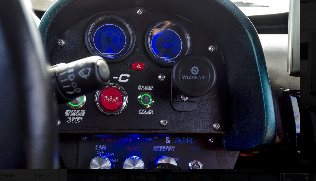

You may also want oil pressure and water temperature gauges (not just a number). Might start thinking about what else you want and what will fit in visually with your plan. I didn't put much thought into it and my two individual gauges over the row of switches (in that center portion) ended up looking like a Emoji Face.

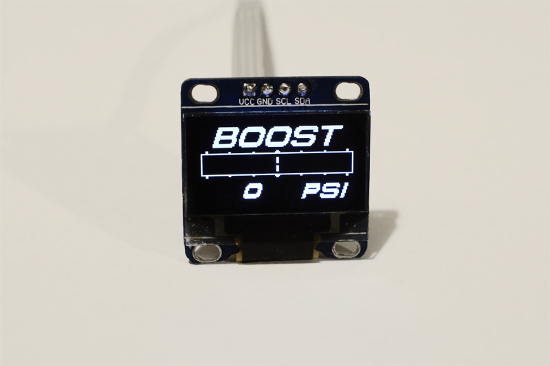

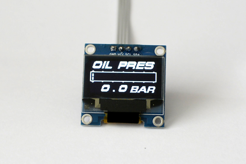

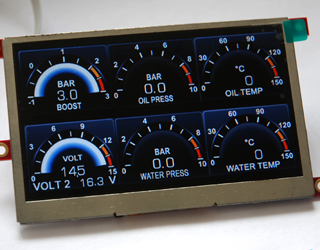

If I go with a dedicated gauge cluster, this company has some neat products that are digital graphical which would work with the look I want to achieve. I am just not far enough into this part of my plan to have it figured out but they make single gauges, multiple gauge clusters, and even multiple gauge clusters that work with a head unit so I may explore how all this would get integrated into the car.
http://zada-tech.com/solutions
Stand-alone gauges:
Gauge cluster would look nice in the center stack: they have multiple sizes:

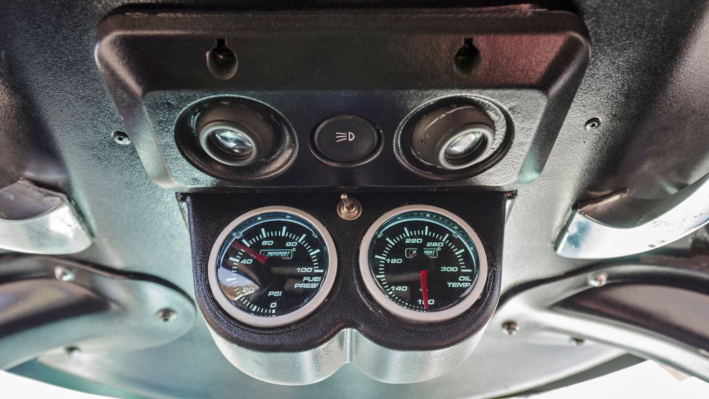

Here's what I did for auxiliary gauges. All are Prosport gauges.

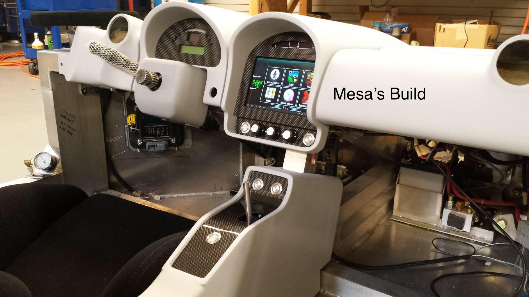

It's pretty good. I'm using it on an 8" Samsung Tab A which I'm planning to mount in the center dash to run gauges. It connects pretty quickly via Bluetooth (about 5-10 seconds). Gauges are pretty easy to configure and there are a bunch of gauge styles, multiple pages, etc.
#13

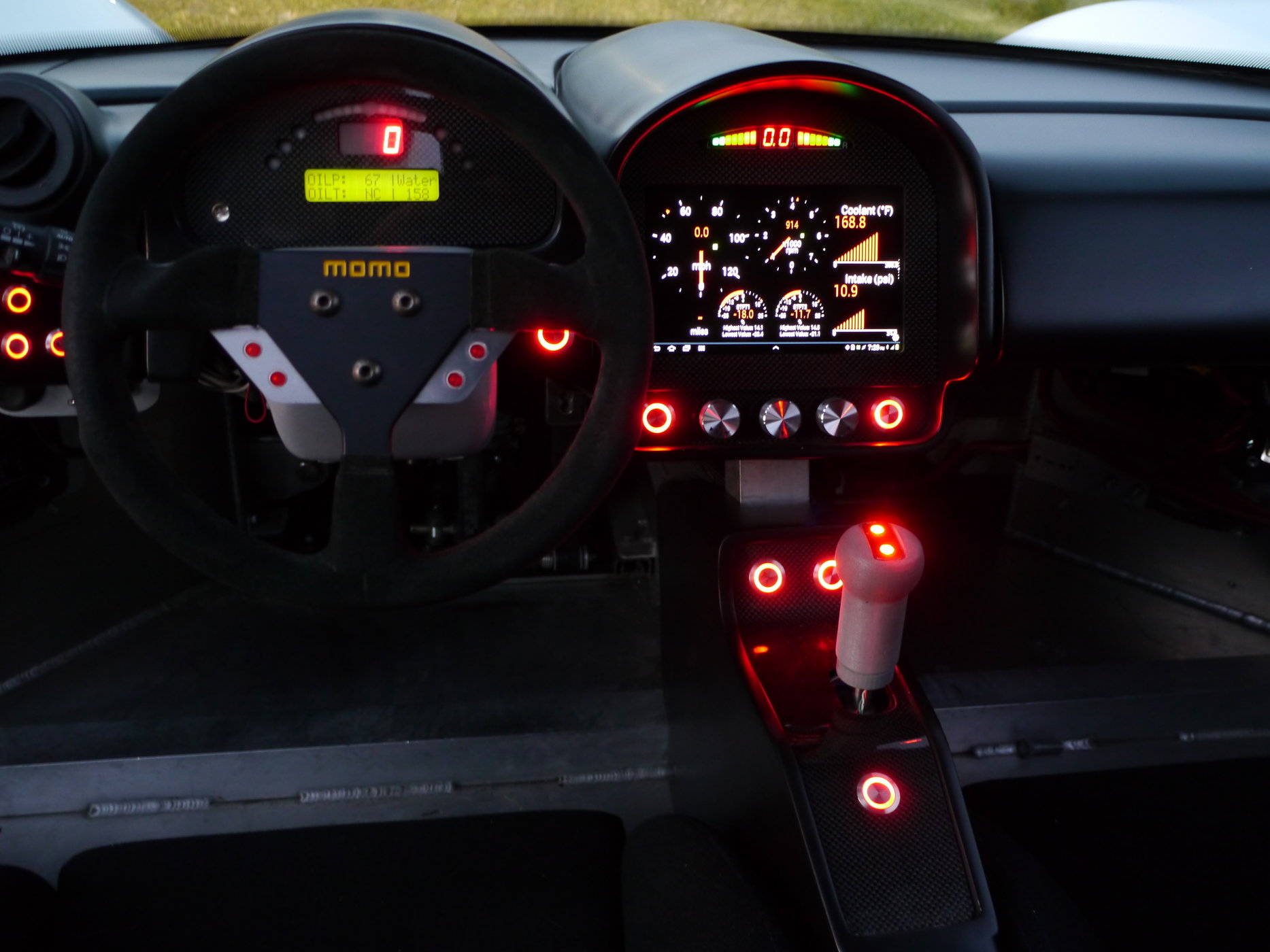

Here is an example of Torque running in a now old Samsung 7.7 tablet. My ecm/obd II does not output an oil pressure signal. Initially I didn't think the tach signal was fast enough, but with miles under the belt, it is fast enough. The Digi Dash has a tach (with shift light array) speedometer and oil pressure number readout, but you have to choose which to display at any given time on the two available screens. Fuel trim display has been valuable for sorting low speed drive-ability.
PS All the red displays and lights are the same shade of red in person, for some reason they look very different in a photo.
#14
Mesa, thanks for the pic. I’ve gone through many of the build threads and this one in particular caught my eye on something I wanted to replicate/incorporate. I think it looks great.

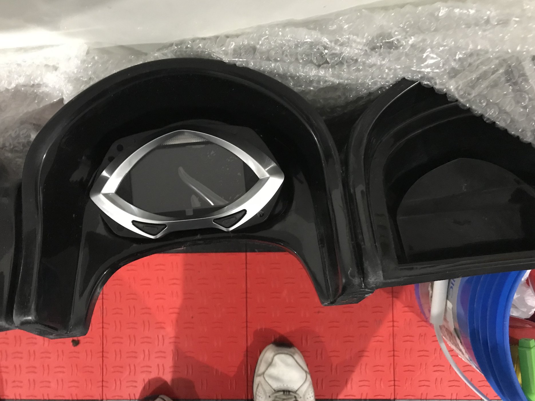

Here you go guys, first look at the KOSO RXF and how it looks in the driver’s binnacle. Not a great photo but took delivery yesterday and had to see if it would fit. Looks pretty good to me and at a slight price differential from the standard guage pod I think it is a good choice. The Strada has it’s advantages for sure and fits really well in an SL-C but I don’t think you can go wrong with either approach if you are looking for a digital instrument cluster.
