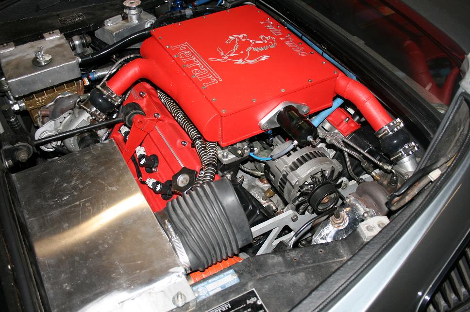

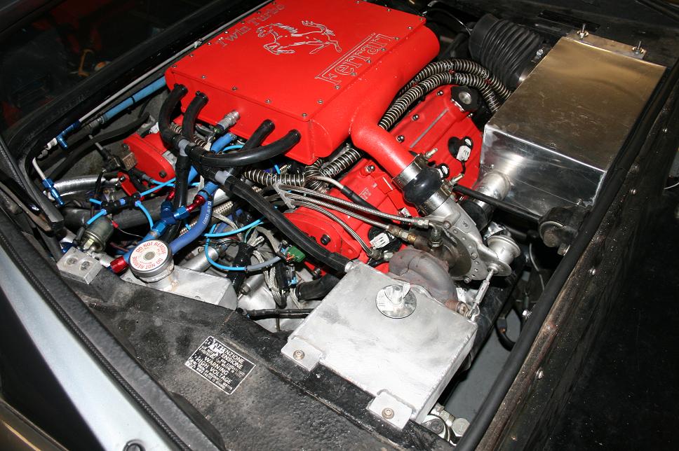

I've shown these pictures before but here they are again, this was over a year project, SS headers, water to air inter cooler, water to oil cooler, electric water pump, just a ton of plumbing, all that goes through my mind is I could have used the stock headers and mounted the turbos below rather than up high and no oil lines or water cooled center sections to deal with.

I can only imagine the dance Jack has been through with that 208 project. And understand why those "magic" turbos seem like a good idea.

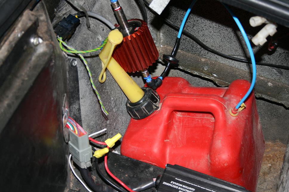

I'm using water ethanol injection just to cool the charge temp and bring my timing up, haven built the SS tank yet but found a 2 gallon plastic tank that fits pretty good till I do. The pump puts out 200 psi, heres a picture for a good laugh.
Mike is that a variable vane turbo? Have you ever heard of a turbo that has self contained oil supply? I hope I'm not the only one who's behind on this new stuff.
