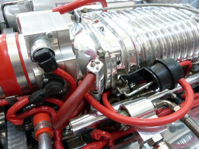

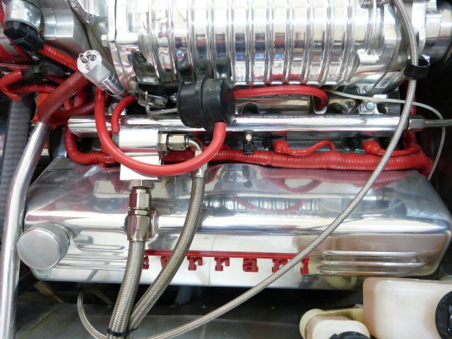

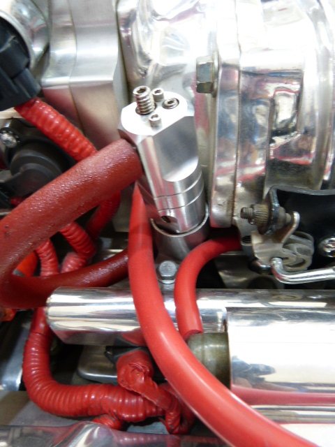

I had crankcase pressure issues in my Ferrari 250 GTO replica that has an LS3 motor in it. The symptom was oil leaking from various bottom end seals. I put a M/E Wagner dual flow adjustable PCV in and after getting it dialed in, no more excessive crankcase pressure. A lot of Cobra guys use the Wagner PCV in combination with an oil separator. I had put extensive baffling in the valve cover so I didn't have an issue with oil going up the PCV on my GTO. The Wagner PCV ( http://mewagner.com/ ) is pricey but worth it from my experience.

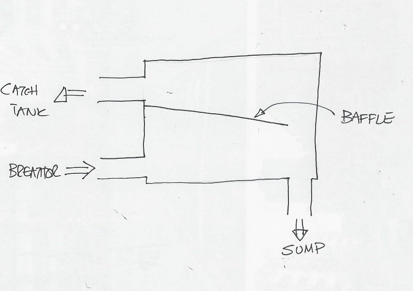

No, your problems are that the breather hoses are in the wrong location and you are not providing a means for the oil in the catch tank/s to return to the pan while operating the car.
Using the factory breather locations, but I'm open to your fix. Yes you do have the option of running a line back to your oil pan, but since mine is a track-only issue with high-g cornering at high RPM I don't need it. And I like to monitor what is happening from a volume standpoint.
