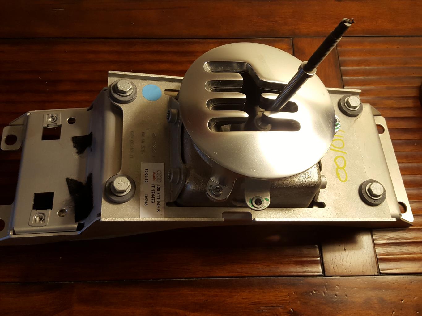

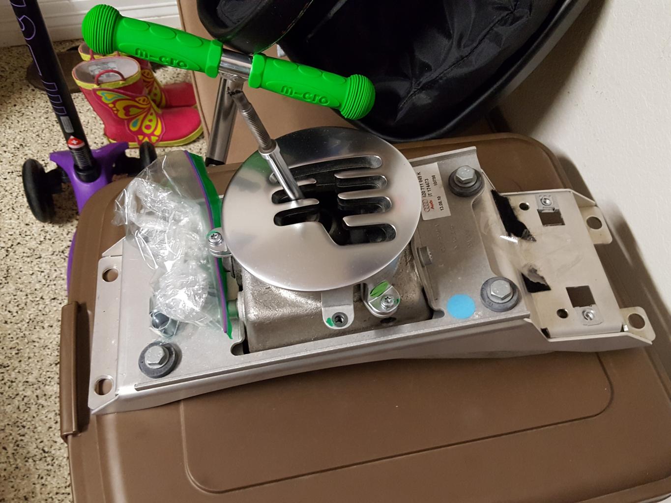

Oh boy... that will be a bummer if it doesn't work.
I sprung for the CF interior, and already know the tunnel cover is too narrow and will have to be modified... really hope we can overcome. It's a really neat piece.

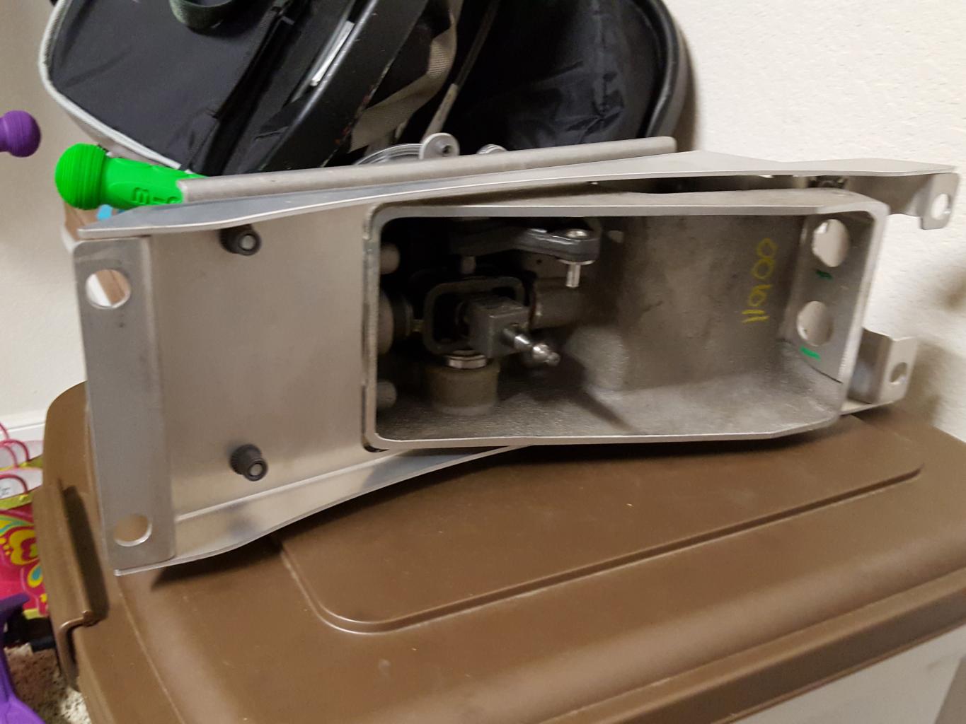

Can you please post a picture of the side and bottom of that shifter?
Thanks,
Ron
HCF - John
Gearbox / Brake Systems
Sure - Best I have of the side

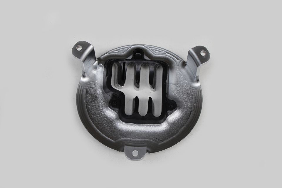

By the way, if one's interested in just the cover and lower guide, I happened to buy one while I was trying to pull together pieces for the whole assembly. You'd want to measure the size of the shifter post and there may be some art to how far away from the supplied shifter its mounted to make sure the throws line up, but the pattern should work fine with the Graziano trans.
