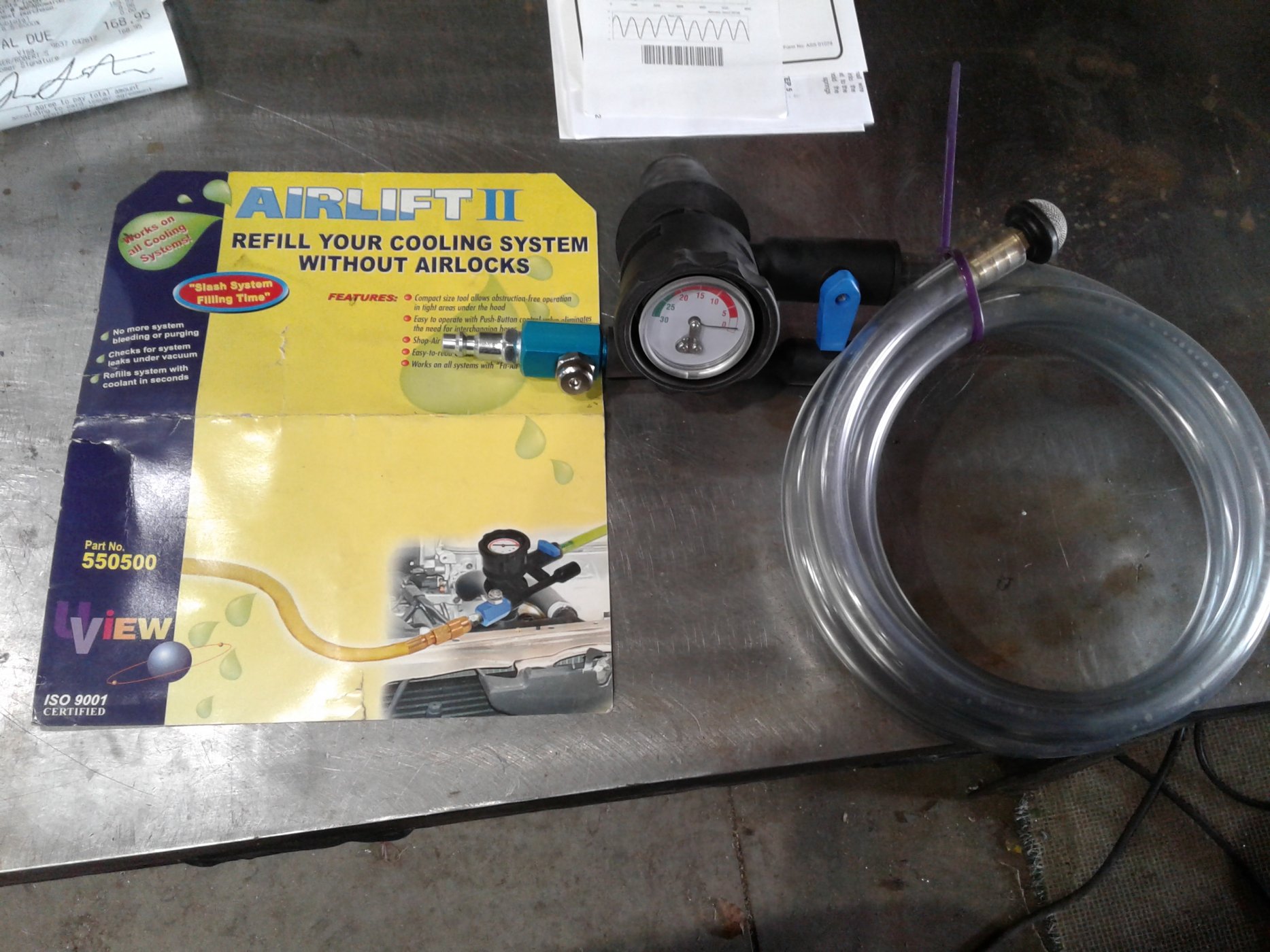

Marcus,
I had the same problem with mine and tried everything as described above. Then one of the club members suggested this and it worked incredibly well.

+1 on the Airlift system. Have had to open up the cooling system multiple times since this purchase, and it's well worth the money.

Because of the constraints of the typical CanAm body, I didn't have the luxury of placing the tank at the highest point. I'm close, but it still has some minor amount of air which can only be bled by doing what Jim noted, which was a tube that goes into a small cavity on the ITB manifold . After I shut down the motor and climb out of the car, I hit it with my fingertip to release any air that passed that way, and I'm done. If that is done while the motor is still hot, it releases air pressure if air exists, and this allows the pressure drop to increase as the engine cools down, drawing additional coolant out of the tank. If there is no air is released (just a small amount of coolant), then it's validation I've got a good situation. This used to be an iterative process until I started using the AirLift system. That system seems to get about 95% of the air out of the system that doesn't have bleeds at the tops of bends, so the bleed seems to get the rest out. Even without the bleed, I no longer have air issues in the coolant system, but it just added another easy check for any air that can be let out with a 5-second thought about it.
