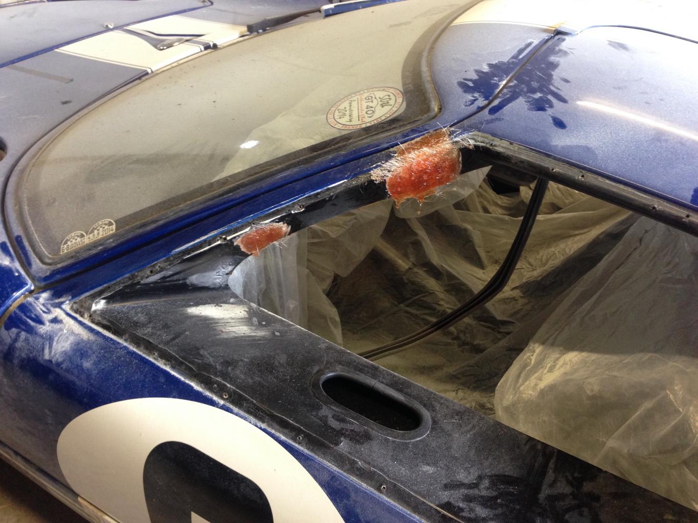

Firstly, I needed to correct the existing bodywork. Key issues were :
- poor shut lines
- misalignment of bodywork
- door tops sitting way too high
I cut a slot at the base of the door pillar, and a slot from the top. Glassing from each side, I ensured that the new glass formed a solid section for strength...
It looks messy, but worth doing...

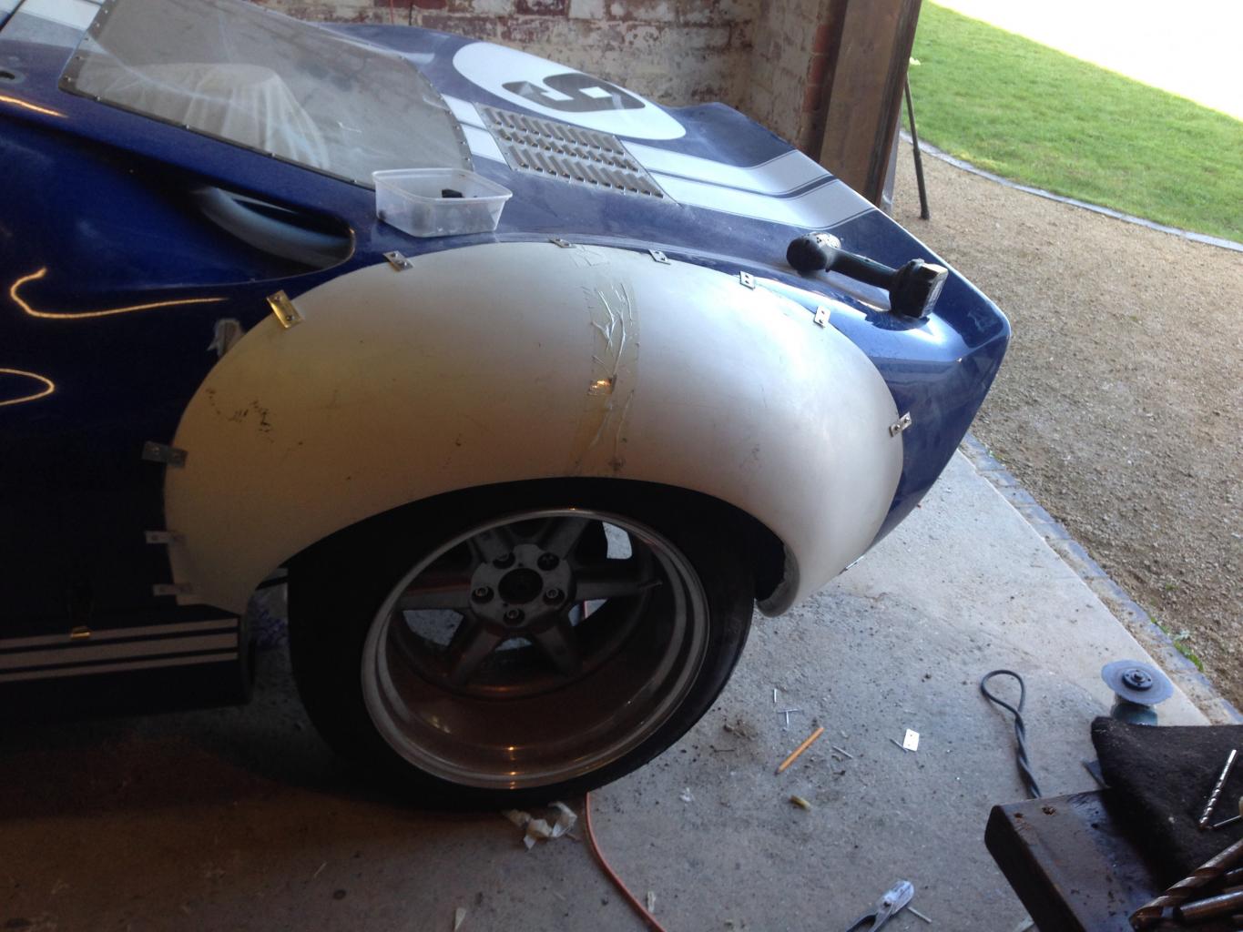

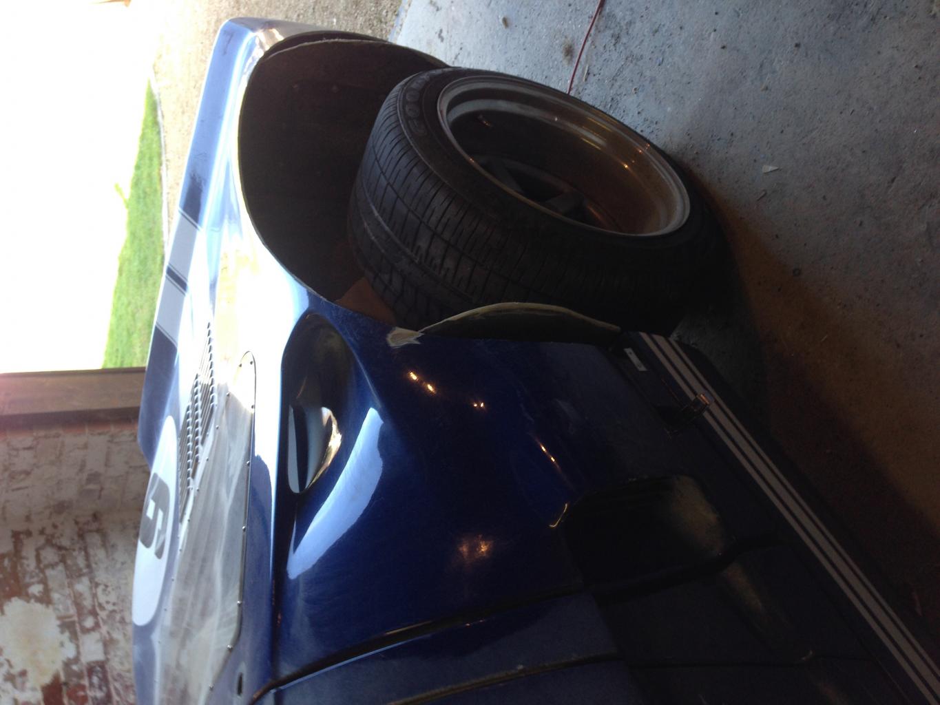

Then for the wide arches. I spent over a day working out exactly where to cut the bodywork and trim the arches.
The new arches were butt-jointed and temporarily held in place with aluminium strips pop riveted into place. These will be ground out when the glass is built up and profiled.

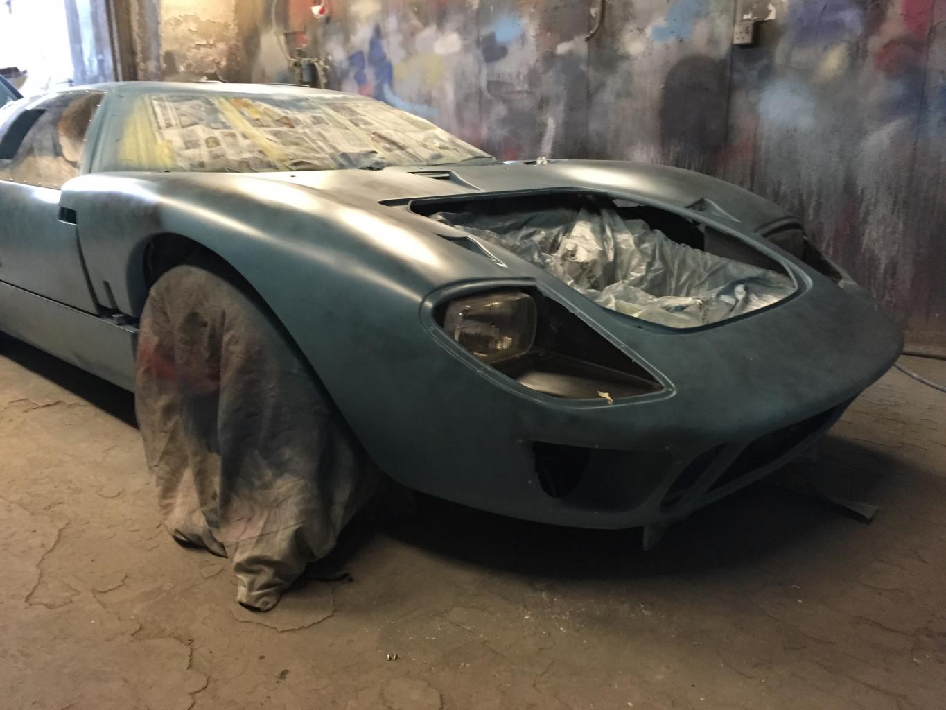

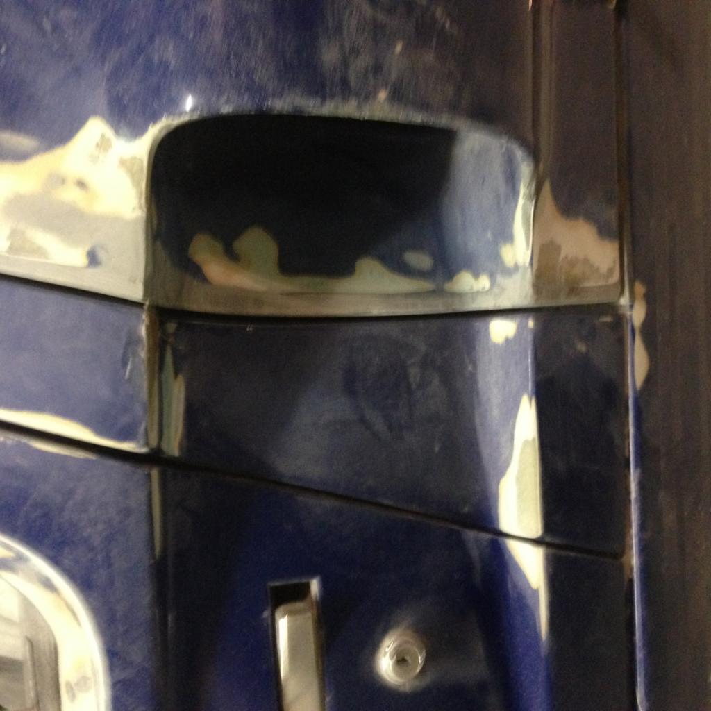

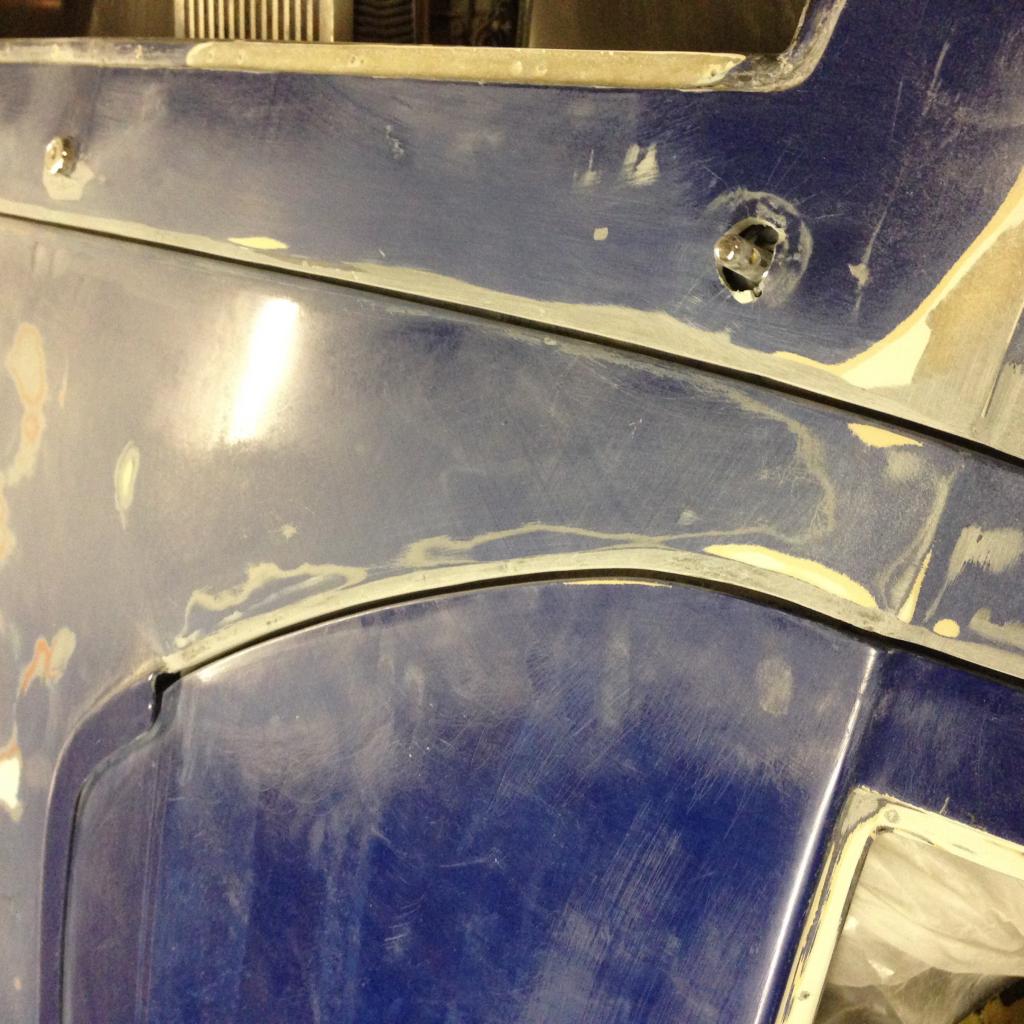

Next to the panel gaps. In each instance, I ground through the paint and gel coat to get to the glass. I built up 90% of the gap with glass and resin, and then used 3mm bendy foamex (as a guide) and carbon reinforced filler to create consistent panel gaps. This took weeks!

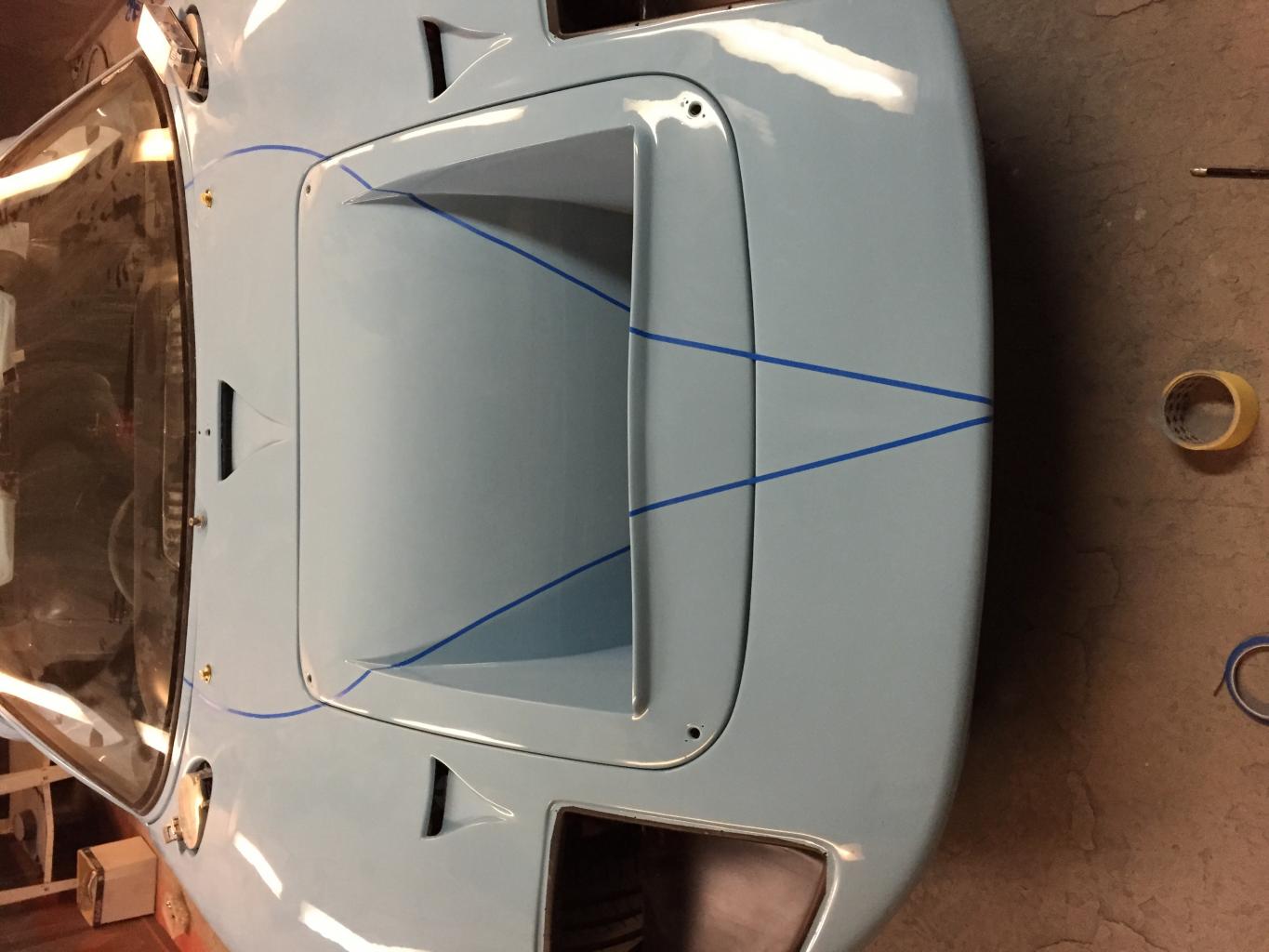

Now for something more radical...
I needed to make a single nostril, so I thought I'd make it as deep as possible.

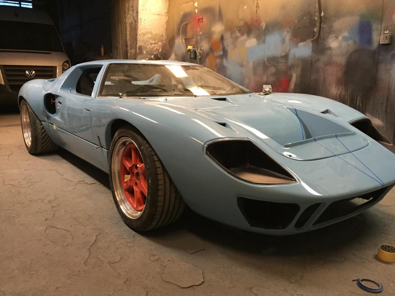

I used the top of the original twin nostril, cutting away the rest. Using a cardboard template, I cnc'd some sides in mdf to which I attached some strengthening battens and skinned it with flexi ply. I filled, sanded and painted this, creating a perfect mould.
I clamped the mould and remaining nostril together and glassed over the mould, paying close attention to creatin strength at the joins.
The resulting nostril looks awesome!

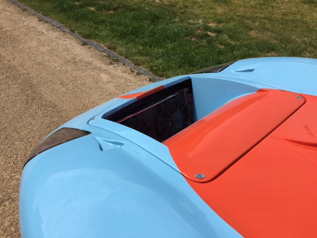

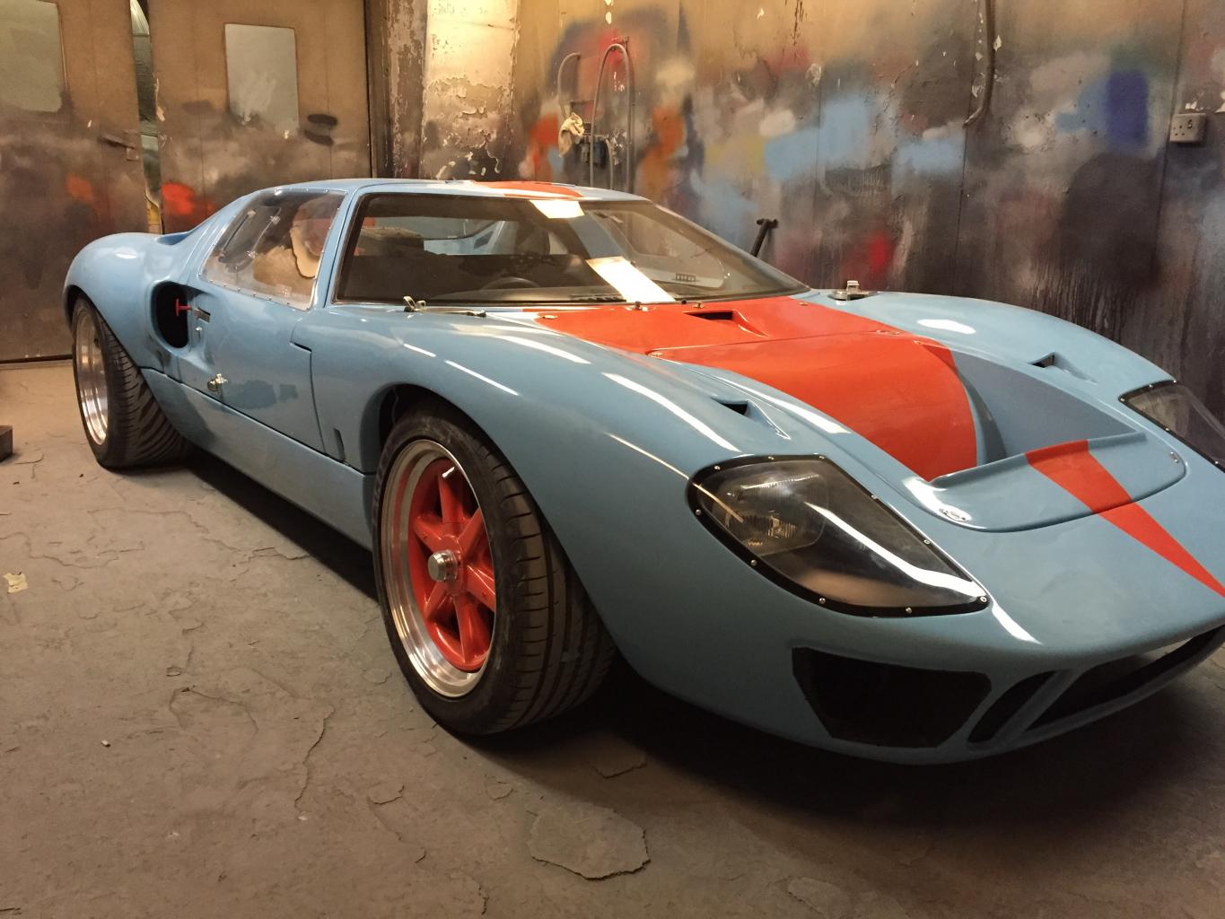

Stripes done!
I've opted to do the black edging stripe in a 3M black vinyl wrap material. Even the best cars show some signs of movement, which is usually most seen on the black stripes. This way, I can simply peel off and fix new if I get any settlement

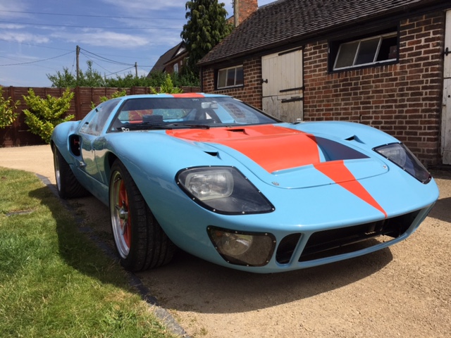

And she's home!
Lots of jobs still to do, but getting there.
I must give Dick Townsend a massive thank you for his help throughout the build. I couldn't have done this without you, dad!!

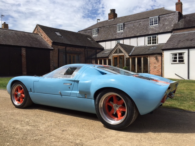

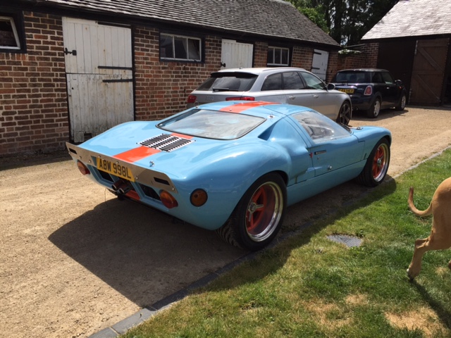

Home at last!
Stickers and finishing touches are still required.
Note the reversing lights - they are the bolts that hold on the rear spoiler!
