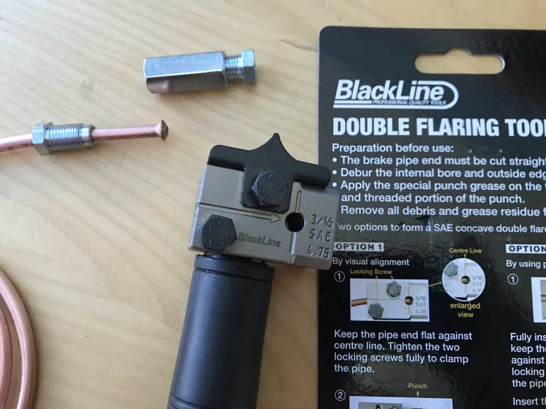

Hi Guys,
Had a fail at my IVA Test on one of my brake pipes, I had managed to twist it just at the join with the flex pipe. Rather than replace the complete pipe, (pain). I looked for a handheld unit that would allow me to just replace the last two feet. Found the Blackline Pipe Flarer on the net, great bit of kit as it does both style of flares. All done in a few mins with no need to take off the pipe, and no leaks.
