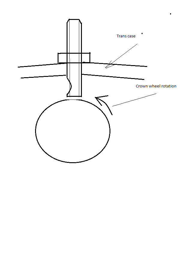

We have been thru this before with Alex/Efnfast, IIRC he solved his problem by relocating the fitting, I think if you modify the fitting along the lines of the attached drawing so that any lube thrown off the Crown Wheel / Ring Gear can not directly enter the fitting/breather tube your problem should be minimised. I would drill the current fitting out to max size possible ( without weakening the threads ) and push a tube into it which can have a hole drilled in suitable position as shown, you will need to test fit and mark fitting to ensure you drill tube in correct position to avoid fluid being thrown into tube.
