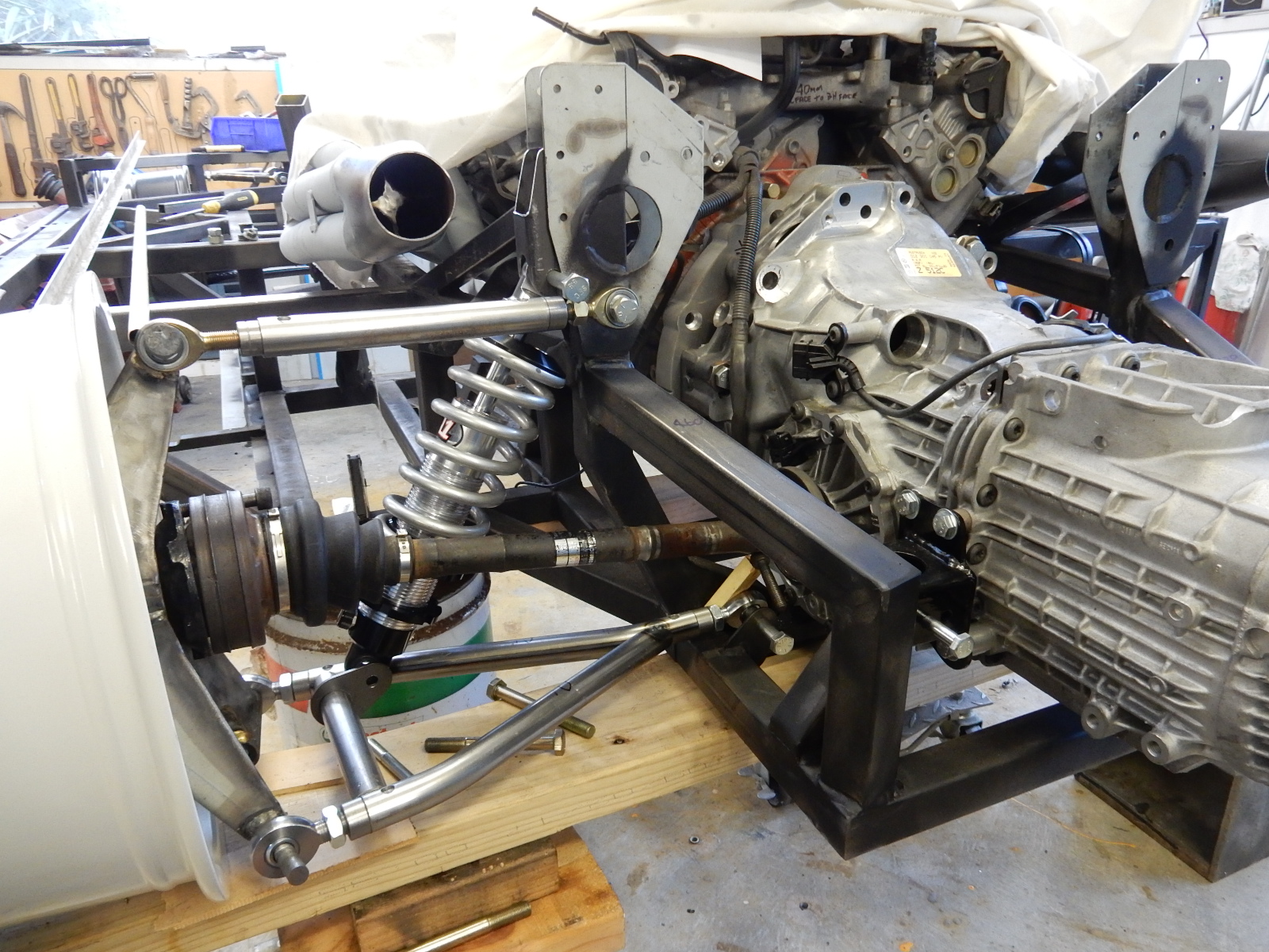

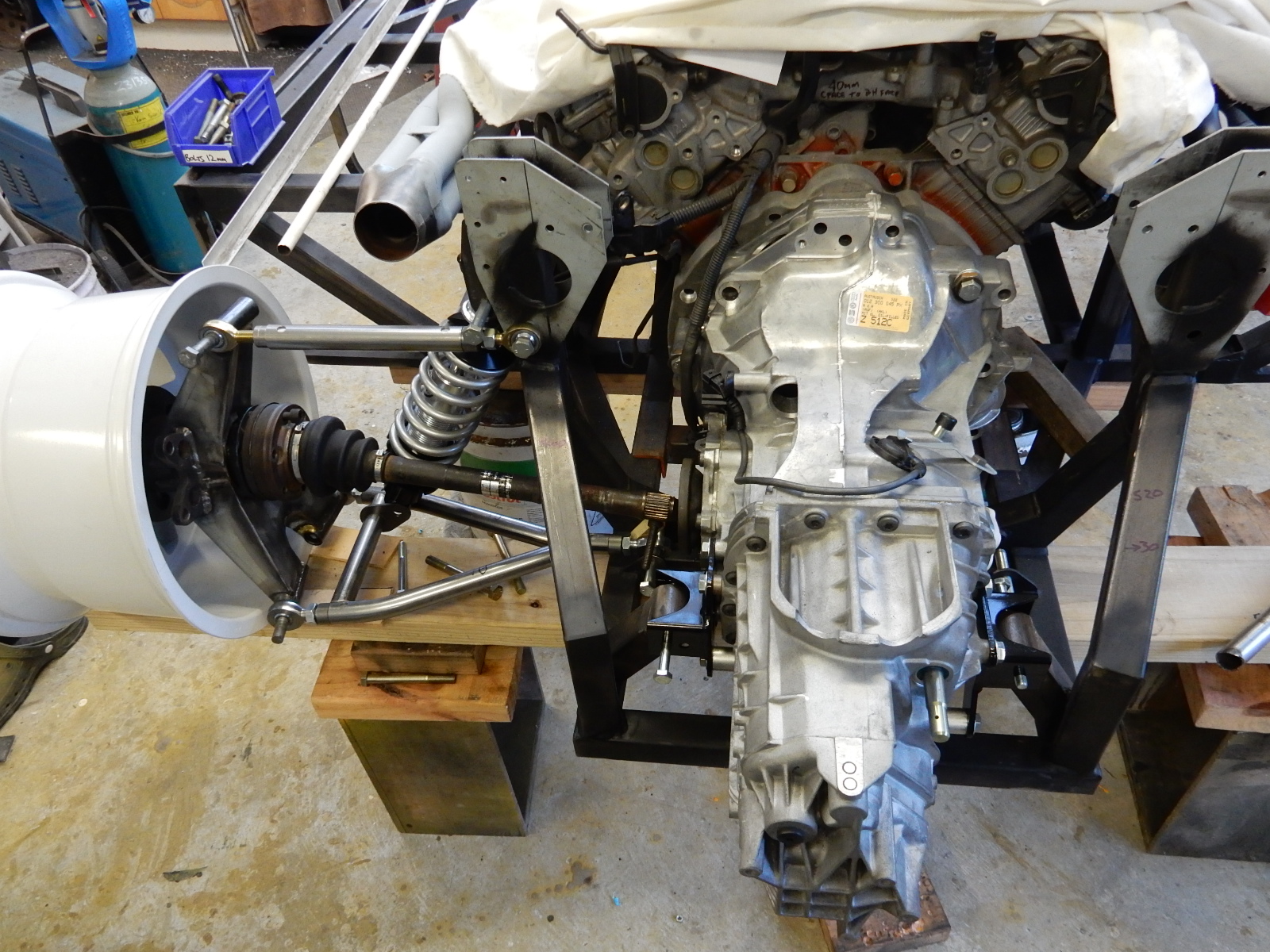

I have used the 012 as used in the early Boxter and some Audi GT`S. I have had no problems and quite like the box.

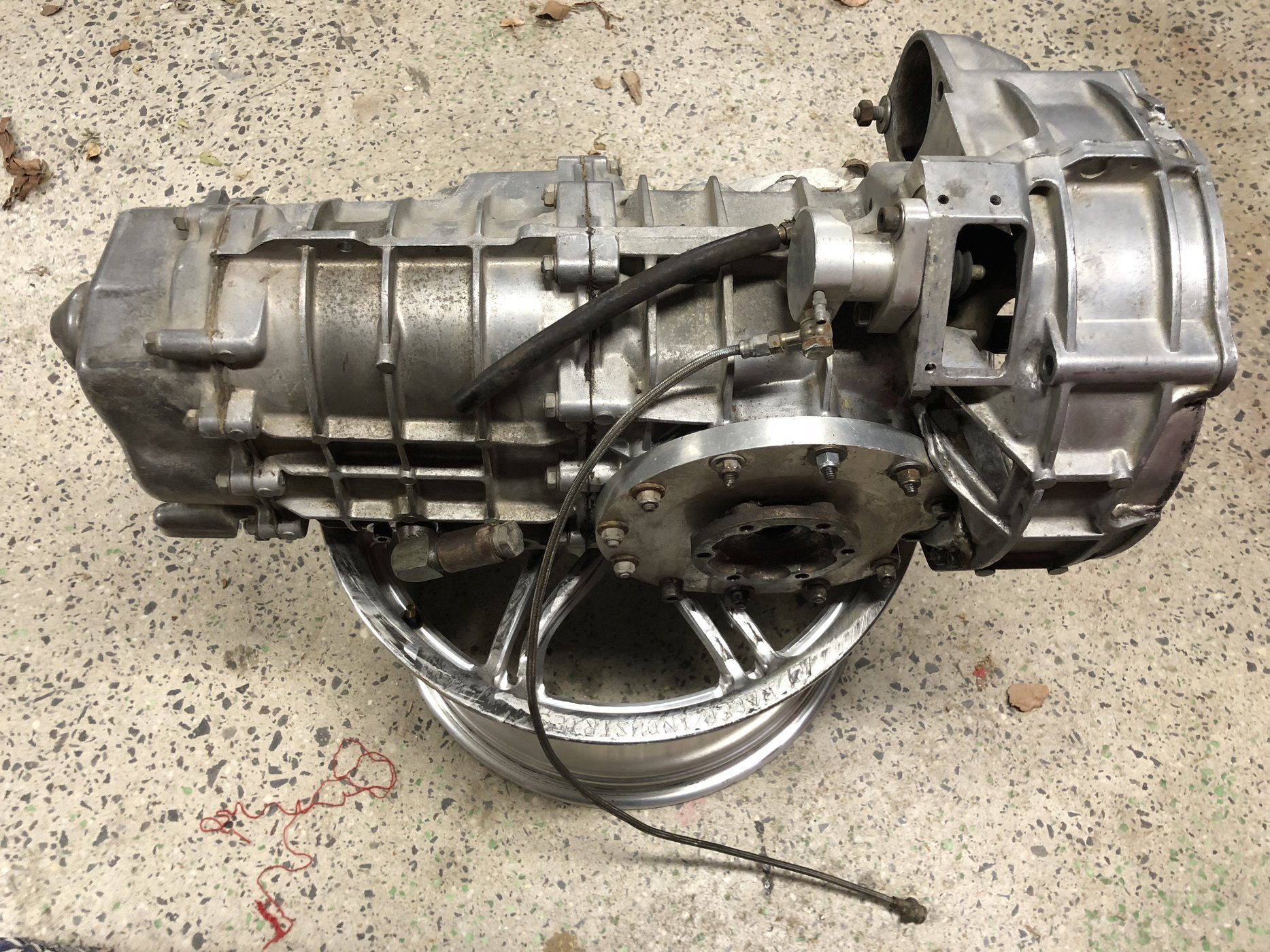

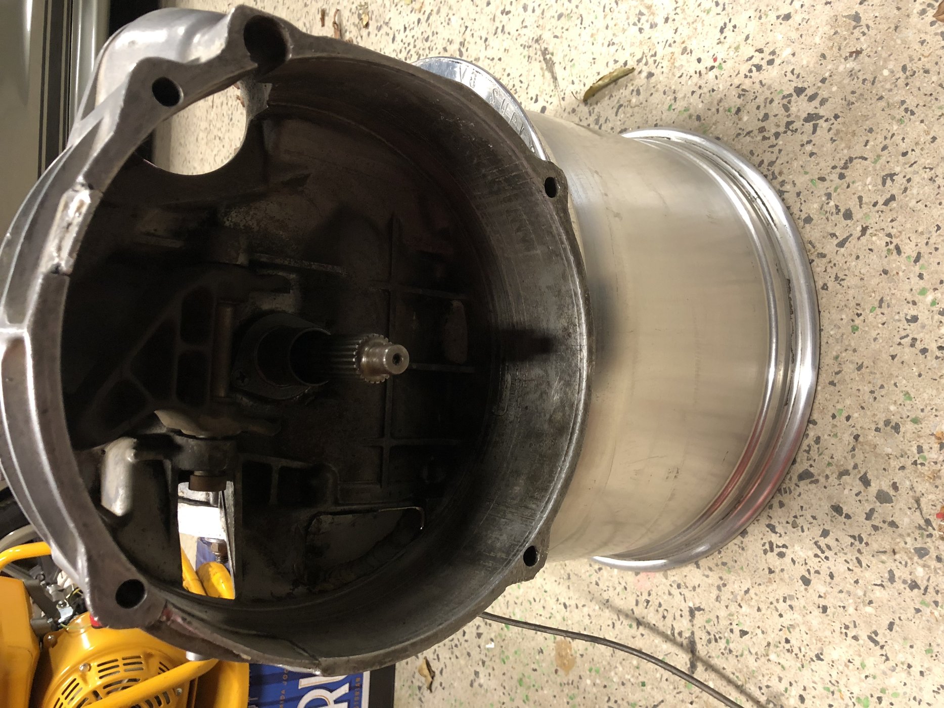

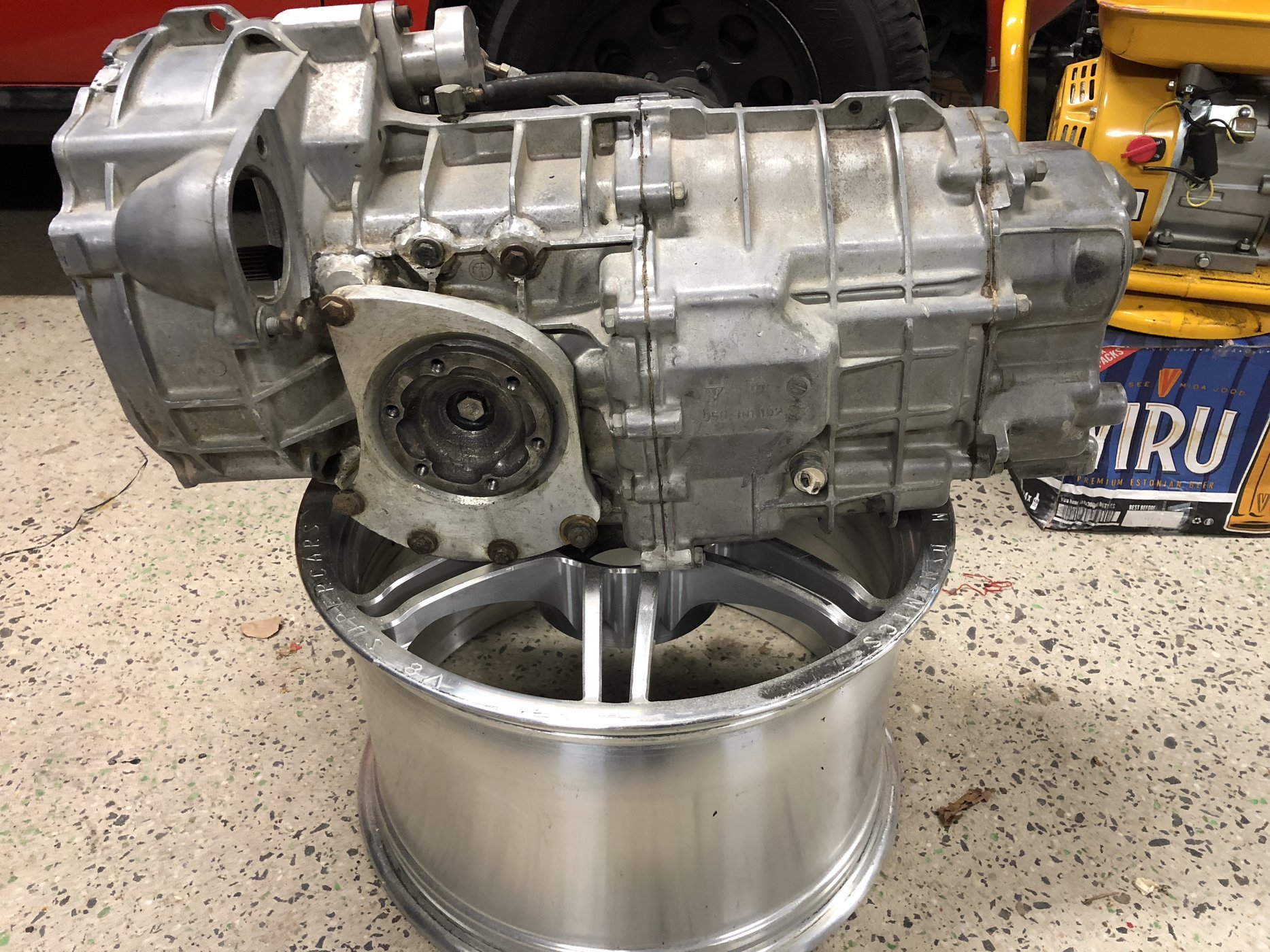

It’s beefed up with Andril components as it was out of an off road buggy.
Haven’t got to clutch yet
There’s one off the Windsor but not sure it will fit
Clutch is hydrolic looks like custom slave cyl
It’s missing the selector at rear of shaft
