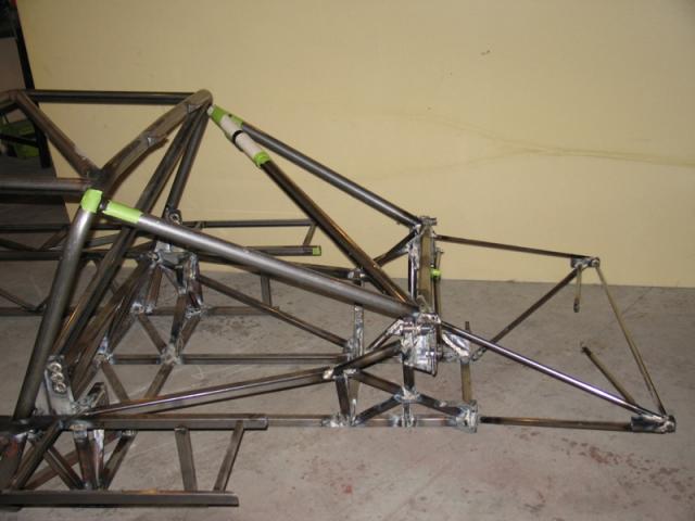

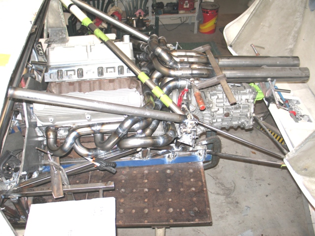

My trans is hung out the back unsupported, although solid mounted off the rear motor plate. In fact the rear body mounts are tied into the rear of the trans to provide lateral stability for the rear clip, so that will feed extra loads into the unsupported trans.
I think you'll be fine, particularly if you add a pair of Flatchat type braces.
