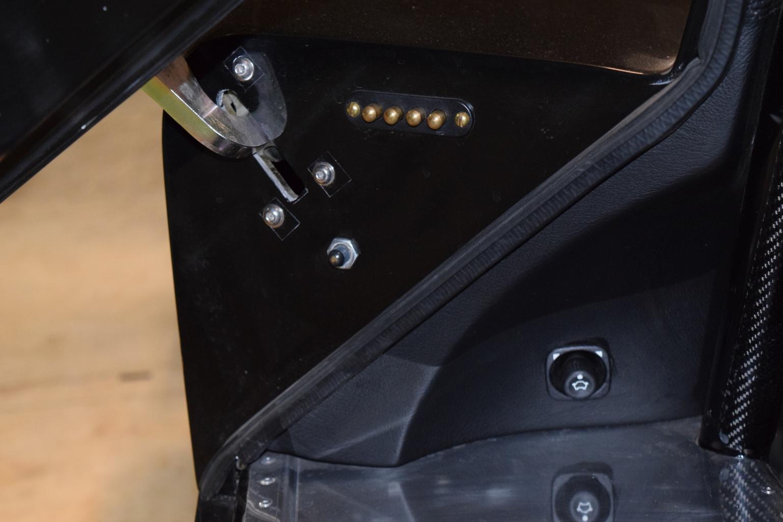

I built and Ultima GTR. The factory supplied some great electric door-mounted side mirrors. To eliminate the bundle of wires from the body to the door, I borrowed a method from the Hot Rod industry that consists of spring-loaded contacts between the body and the door. Obviously the photo only shows the body side. The photo also shows the eight-way switch....four directions for left and right, also supplied. There are only four active brass connections per door. The photo may be confusing, as the switch is secured with brass screws,.... for fun. The other button in the photo is for the dome light, which can be set to turn on when the door is opened.....or not. The double dome light can also be activated from inside the car, driver and/or passenger, and used a a "map light,"......or wife checking her make-up and hair,
