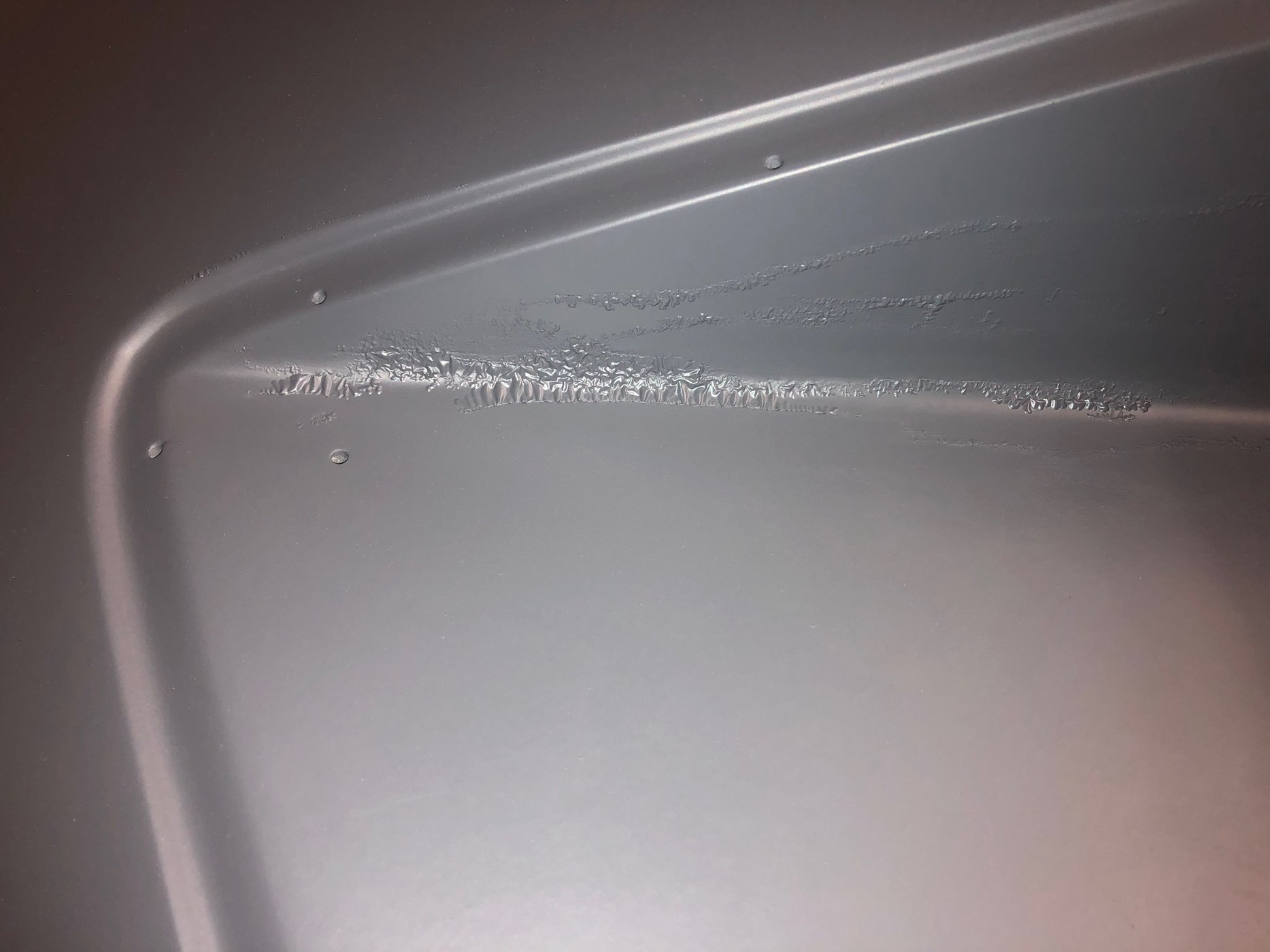

Hello,
Many searches and web advice and nothing seems to make sense. I have primed or painted this same area at least three times, with sanding and removing material in the middle of those as well as wiping down with pre-paint prep and I get the same thing happening in the same place every time. Here are the steps after the last time. Sanded the area to smooth, including wet sanding with 600 and getting a very smooth finish. That was all done a few months ago. The "base" when was a very smooth combination of some fiberglass gelcoat, with maybe a little paint/primer in some areas. I then scuffed this area (less than one square foot) as well as the whole rest of the front clip (10's of square feet) with 120 sandpaper. Washed once with soap and water. Dried. Washed once with soap and water. Dried. Washed with water only. Waited a day. Used Dupli-Color pre-paint prep (Grease and Wax remover) on the entire clip. Let dry for an hour with a fan blowing on the clip. Primed the entire clip with Eastwood Epoxy Primer. Everything is perfect, except for this same area on the one headlight that I continue to have "bubbling" issues with. The only thing I can imagine is some sort of contamination, but I thought once again, I should have eliminated that. But apparently didn't. Anyone have any ideas?
